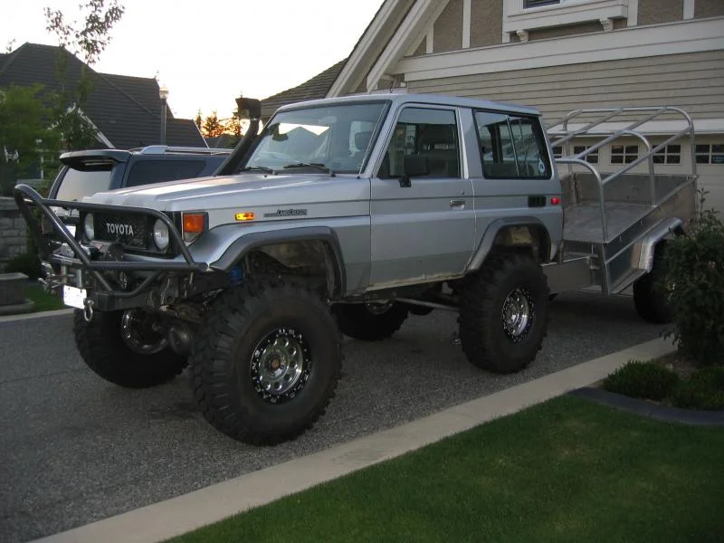

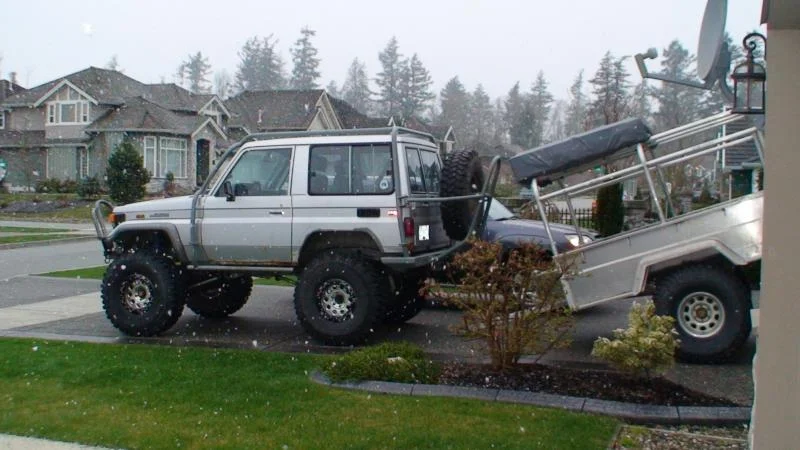

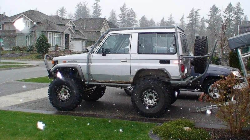

1985 BJ70
3B
AXT Turbo
Air/Air Intercooler
XDI True Flow Air Intake
Aluminum Rad
Earles Oil Cooler
Safari Snorkel
Marks TCase Gears
ARB's
11.00 x 16 Michellin XZL's
4 Wheel discs
Double Triangulated 4 Link front and rear
Rear supension - Air Bags (16" - internal bumpstops)
Front suspension - King Coilovers (15")
Full Subframe and extensive frame mods
etc.... ect. (not a comprehensive list but some highlights)

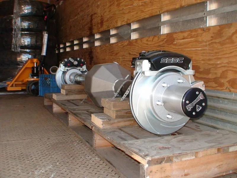

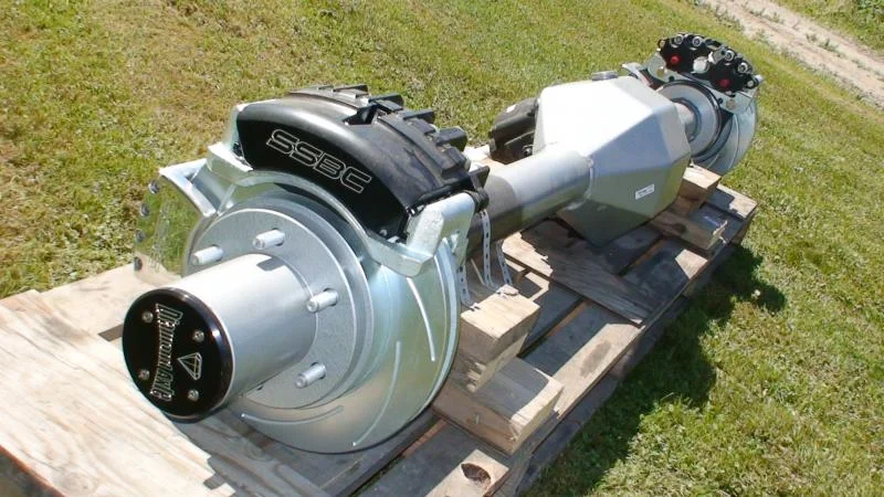

To Do:
AXT liquid/air Intercooler

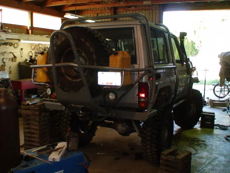

Complete existing Exo-cage and rear stinger mods for fuel cans
New Diamond axle - true Hi9 rear center - ARB - Full floater (35 spline) - width 64" - Arrived
Order (build to spec) new front axle
New paint job
Hydro Assist
Cheers!!
Rob

Oooook thanks .. now I thought we have a clear candidate to ROTW

Bloody Hell!!! 11.00 x 16
Amazing TOY
Great Job Rob

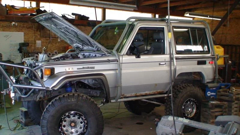

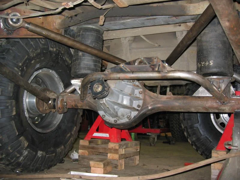

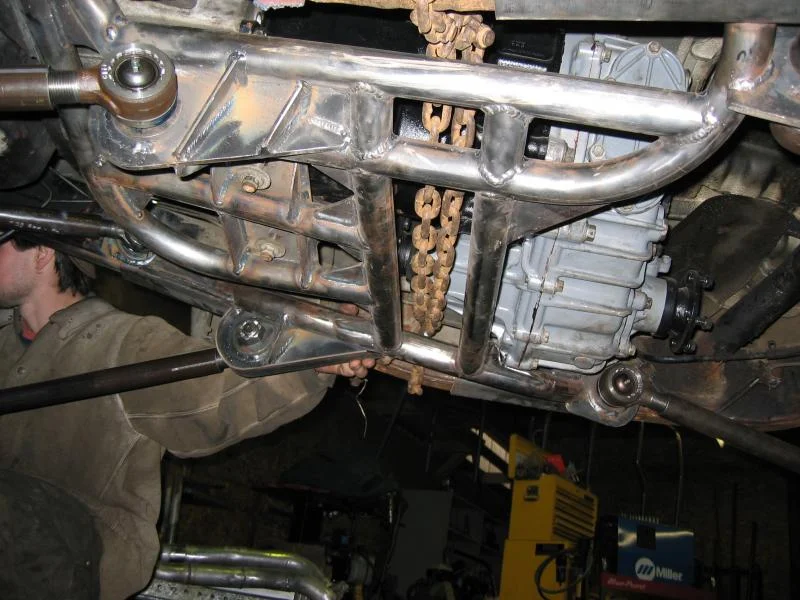

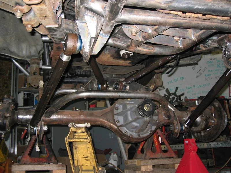

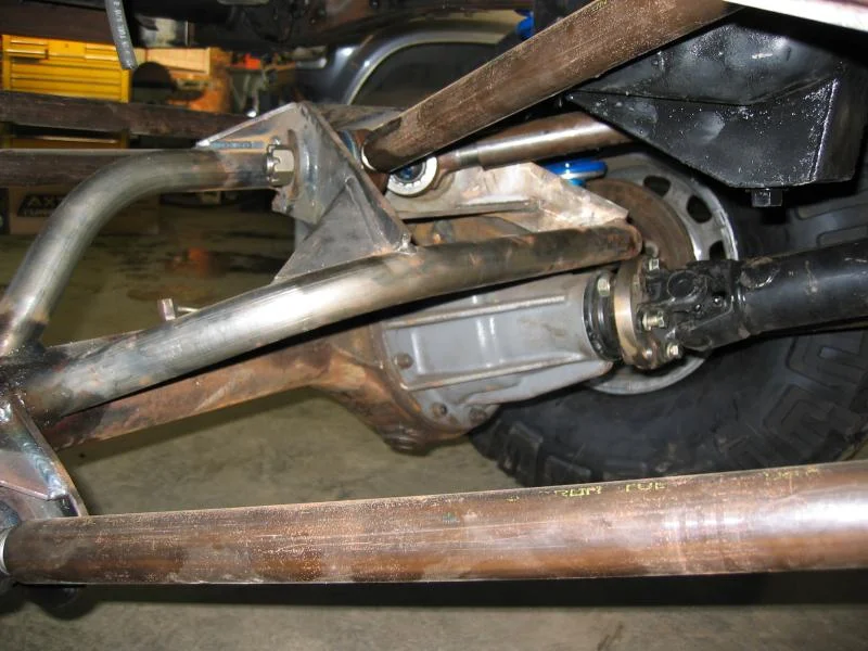

Thanks guys.
Here are a few old pictures from the original buildup from 2003-2004.
Cheers!
Rob

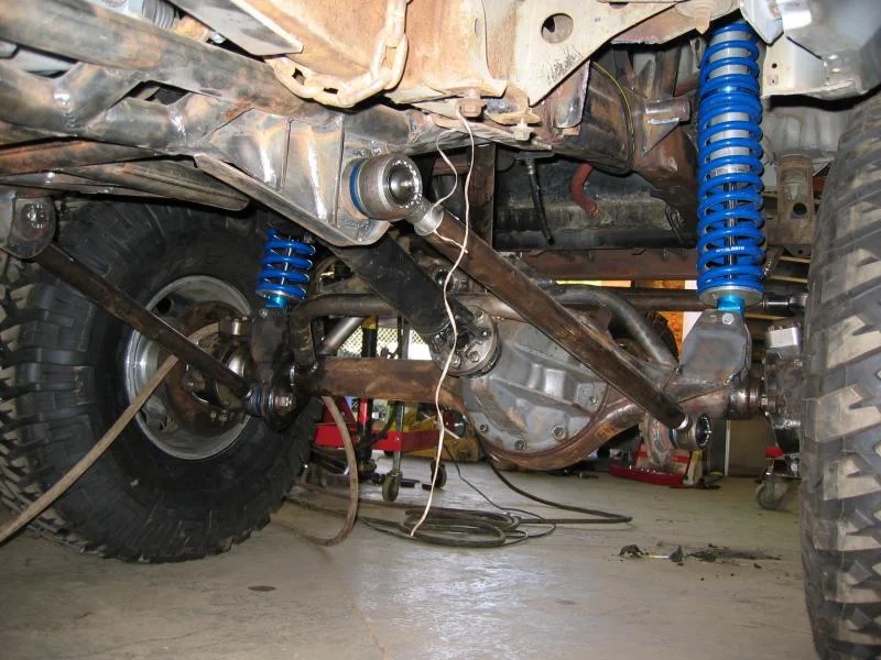

A couple more...

slick looking truck, nice work!!!

Thanks for the pictures Never seen anyone use that style of rod ends. Is this a daily driver or does it go to the trail on a trailer?

Daily Driver. Don't own a trailer. Have around 60,000km on this setup (haven't replaced a rod end yet). I have driven it back and forth to work for the last 4 years, everyday. Also have taken lots of long trips where it sees multiply-day legs of highway driving before it ever sees any gravel or trail time. Off pavement, I have driven thousands of kilometers down logging roads all across BC. Been as far as the Yukon border, Alberta, NWT, Washington state, etc.

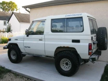

My 1989 BJ74
I have done a little bit of work to mine.
33 BFG MT
Old man Emu suspension
CD/MP3 player 24 to 12 volt converter
Headlights- 100w bulbs and new reflectors
Planned:
Bumpers- the stock one got caught a couple of times...
Lockers- ARB air lockers front and back.

Sorry picture attachment from prior message did not work.

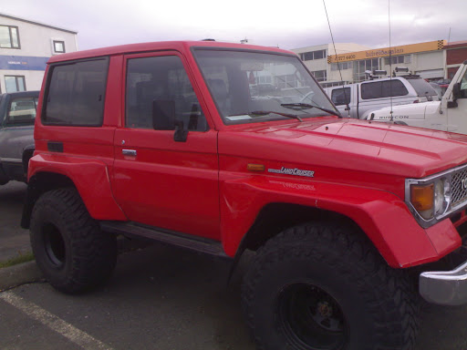

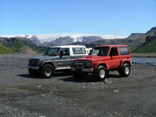

My LC7X
First is my old one, that I have sold away, LJ73 1989 with 3L motor, 2.8 l. diesel + Turbo-intercooler, 40mm body lift, and longer coil-spring for longer suspension travel. 38" tiers rims 15"x12" Custom flare fenders.

And here are two cool Cruisers that my friends own
