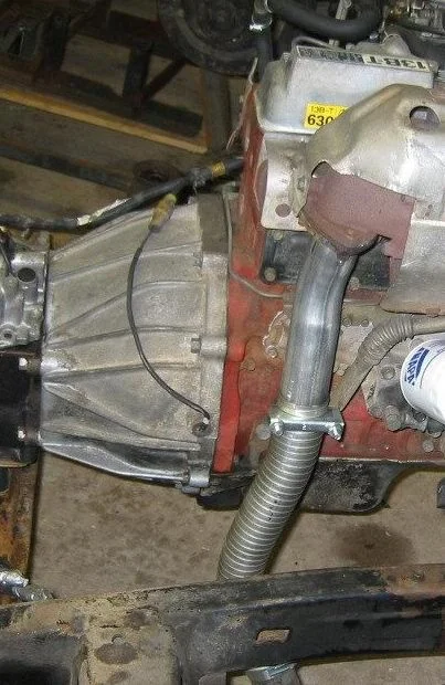

The sensor part # is 83180-60040 and it seems to cross over to many applications, which infers that it is not voltage specific.
Attached is a picture of the sensor in a bellhousing, and the line that comes off it.
The sensor uses the "Hall Effect" I believe is the term.
