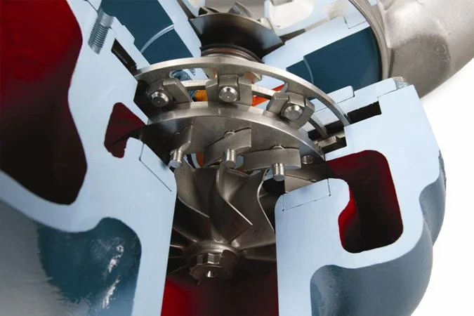

Some of the early International trucks and a few of the early industrial Powerstrokes used an oil actuated VGT but they would get clogged with carbon and stick. The VGT's on the International's new Maxxforce 9 and 10 work very well. The electric actuator cycles every time the ignition turns on and off which keeps the vanes from sticking. The VGT works great and pushes the 53,000lb Maxxpro MRAP around very well 570 cu/in 375hp 1250ft/lb of torque@1200RPM. It also works in conjunction with the engine brake (separate) closing the vanes restricting the the exhaust like an exhaust brake. No lag boost right off idle= fun to drive. If they make a reliable aftermarket one my Landcruiser would get one!
