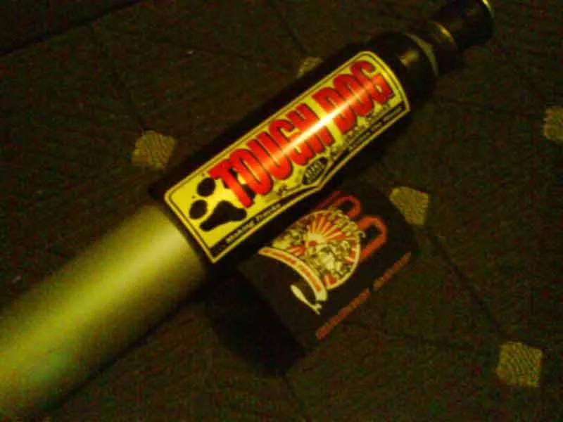

same size as ya beer can

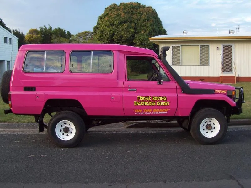

One of the troopies with the EFS 50 mm lift. Prittie colour. They even stand out on google.

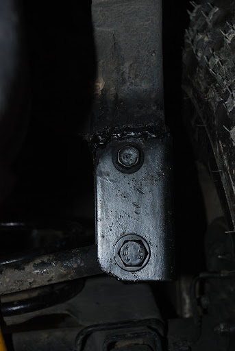

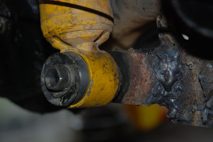

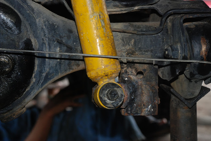

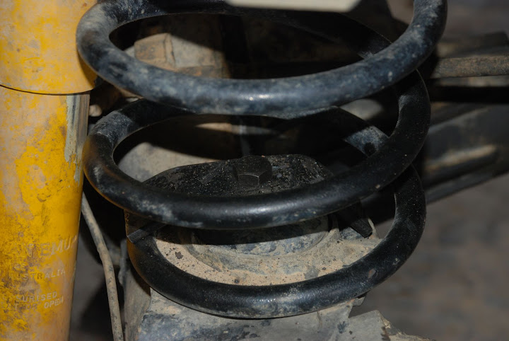

Hi Lulo,
I'm using 4 Old Man Emu + a steering absorber. The 4 springs are normally for much heavier LC (Long Base Ninja if I'm not wrong) This allows to get a 4" suspension lift and support the heavy PTO winch on front.
Of course the setting is quite tough but I only use it for off-road. However for off-road it provides to this LCII an excellent behavior off-road at any speed. Articulation is excellent as well.
If you're interested I can ask my friend who did the suspension lift the exact references of the springs and absorbers we used.
This has to be exytended because of the 4" (10cm) lift
Rear suspension holder has been modified
A closer view
Attachment of the spring
orouit is offline   Reply With Quote
