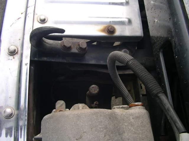

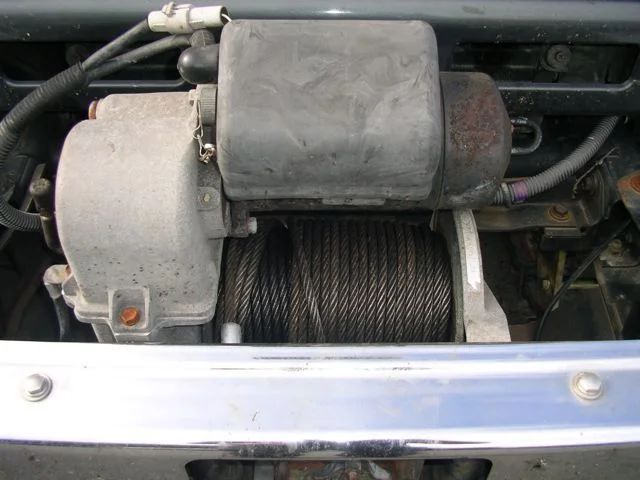

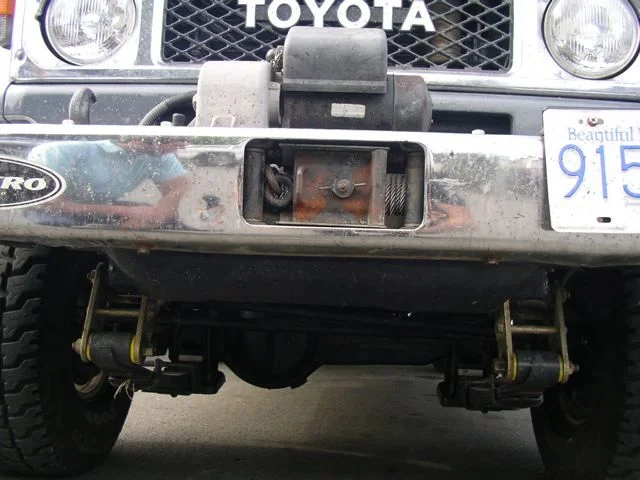

Here are some pictures as mounted on an BJ74

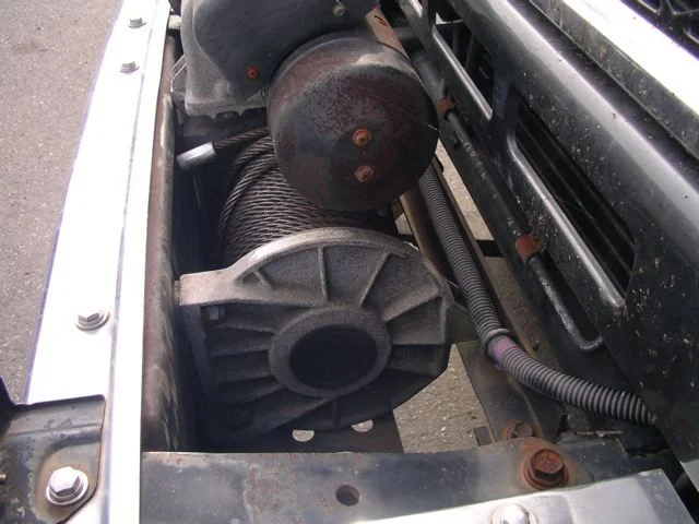

And here are two more for you.

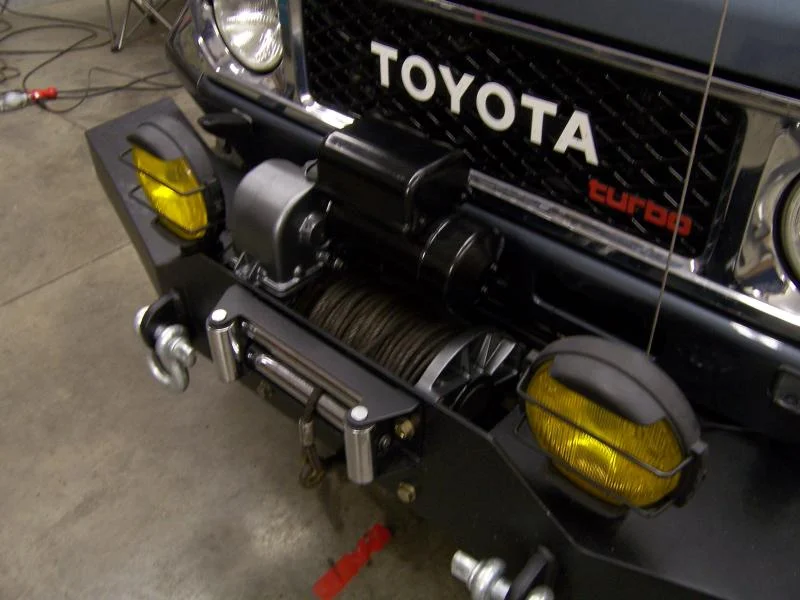

Here is mine

These pics really help me out to figure it out how it originally fit in a 70 series.
