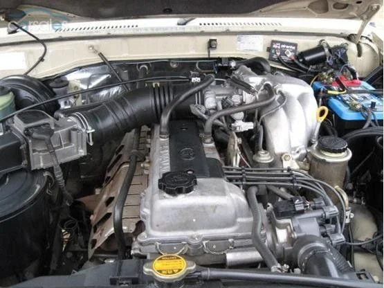

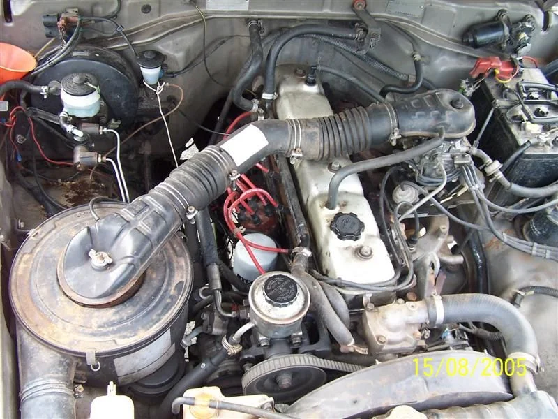

The first 2 pics are of the motor the 75 should have either the EFI or carb version but the 3 pic of blue motor is a 3f and prsume thats what you have the yellow rag in the side is where the dizzy is??

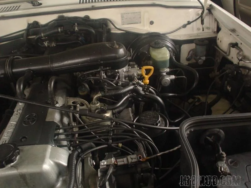

It sounds as though someone has swapped engines as the engine number and chassis number contradict each other.
This is the 3F in my FJ73
I cant see how there would be movement if its tightened right down as you say.
Has it been removed from the engine and inspected?
