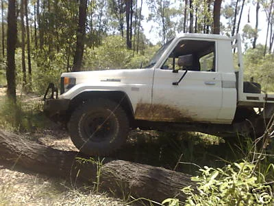

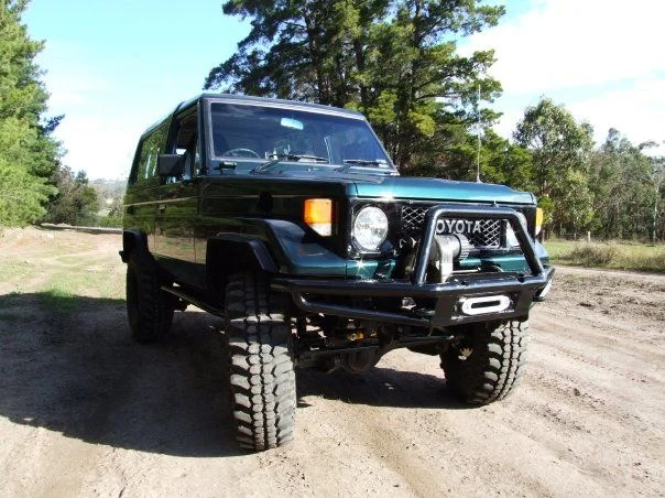

Yes mate very do able for coils i think you would be better of using 80 series front diff so you can keep the 6 stud rims easy to get big and wide aftermarket rims for
For the cab this is a 79 series cab on a 75 the 75's have a shorter chassis than 79 so you will have to remount your tray or move it back about 100 mm or so
pinkfloyddsotm put coils in his 75 series looks aboslut nuts

Clint, do you know the owner of that vehicle? Or it's build history?
Could you let me know of some of the pitfalls? For instance, an 80 series front axle will already have spring perches, are the upper spring perches welded to the 79 series body or do I have to make them up and weld them to the chassis?
Were there any other gremlins that occured during the build?
Did the owner do a thread of the build on here? If the body bolts straight down that would be sick. I will go get the bits and pieces tomorrow and take my car off the market. I pretty much just wanted to sell it to get a 79 because I can't deal with the tiny cab anymore, I'm too tall.

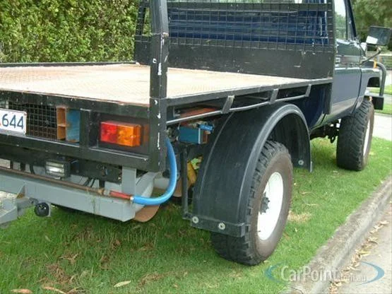

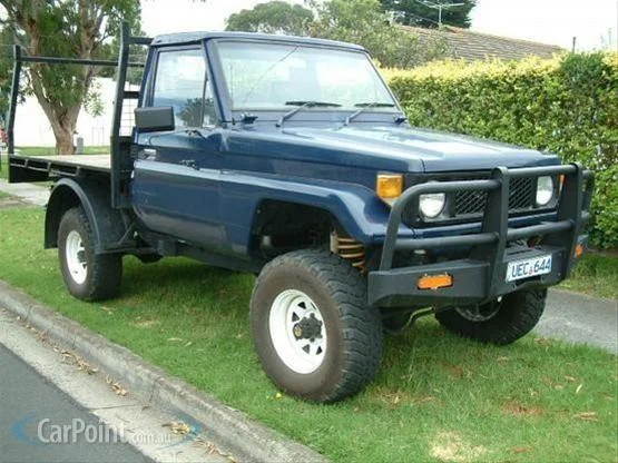

This blue 75 was a ex gov vehicle that had coils pro put in not sure why the reason would be though

that white one is the same 75 with 79 cab he has put his 75 indicator on the the 79 cab . im thinking its a 85 -91 75 series because they didnt come with side blinkers and the 79 cab has the holes blanked off I have seen a 75 with 79 cab in wangara also so maybe a few people have done the conversions
(driving past the one in wangara one day i was seen a 79 then seen front leafs i was like what the oh i see 75/9)

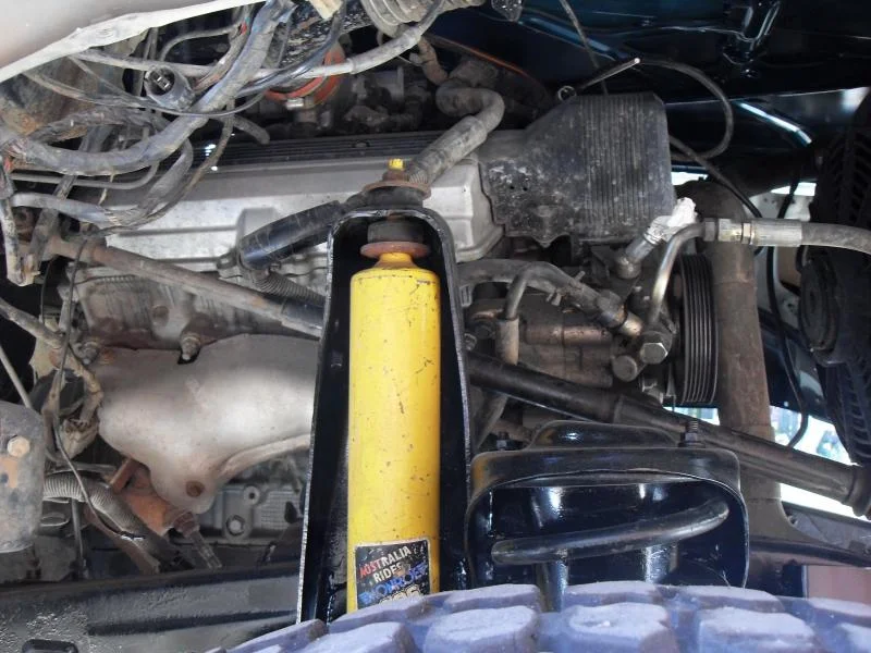

i coil converted my MWB cruiser only because you cant buy them in oz, i used the standard diffs and 80's coil hats and shock towers

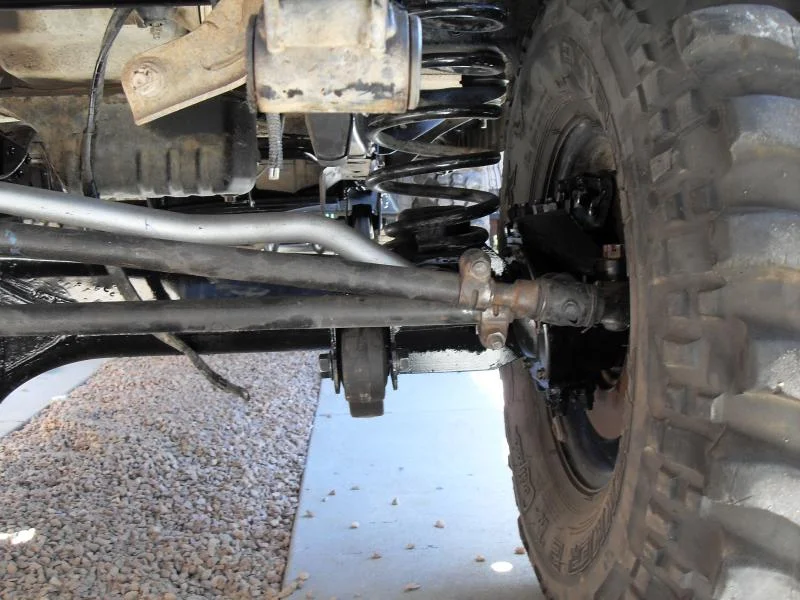

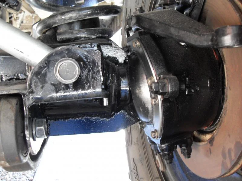

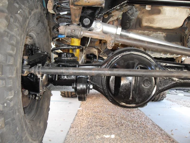

Old 09-06-09, 02:47 AM   #22 (permalink)
Forum Regular
Join Date: Jan 2006
Location: churchill,Vic AU
Posts: 44
alot better than the 3f and with a new snorkel/airbox it will have about 225hp at the rear wheels.

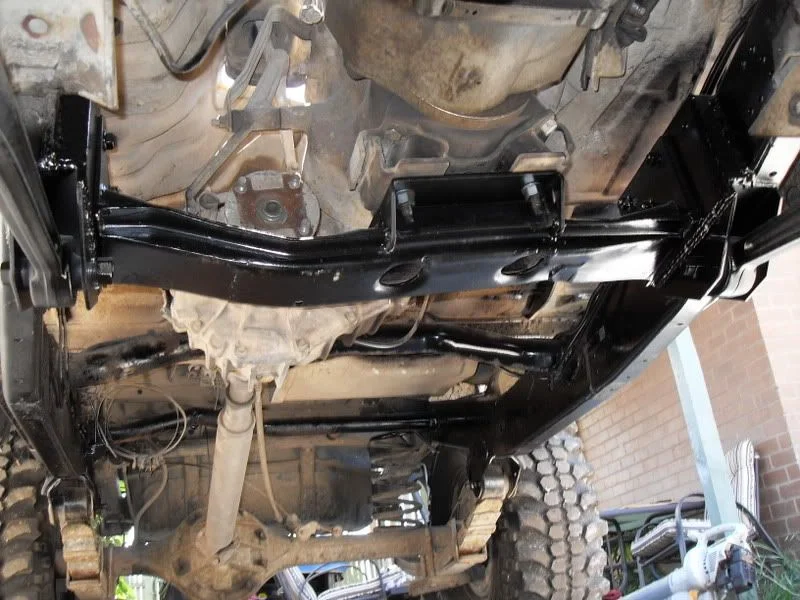

and a photo of the hardest part of the conversion...locating the crossmember and the raduis arm in the smae spot

Old 09-07-09, 05:34 AM   #24 (permalink)
Forum Regular
Join Date: Jan 2006
Posts: 44
i'll try and explain the photos.
i run in front of the diff and it does fit but you have some restrictions to work with if you stay with running the drag link and tie rod in front of the diff. one being the panhard chassis mount is limited to your up travel I am happy with around 4/5" up which meant the bracket is about 90mm. if you didnt have the tie rod there you could have more up travel.
the other end you could go higher than me but im a fussy pucker and wanted it to look as normal as possible.
i also added another crossmember so i could brace the panhard braket and tie the two rails together.
panhard is off the shelf 80's ajdustable.
and the bracing on the diff has nothing to do with the coils just put it on while i was there
Thommo 73 is offline   Reply With Quote

thanks for that mate looks very good. One other question, how do you go for clearance to the sping tower/shock at full compression/droop? With my current leaf setup at full compression/drop the tyre is only about 1'' from the top of the shock abosorber and I run an extra 30mm offset over stock.
Thats the only thing that worries me with a coil front, other than that LOVE it!

thats what im playing with at the moment. with standard offset 15x8 rims running 35x11.5 et2's they touch the coild hat.
i have now cut off the lip on the coil hat flush with the coil and will test it all next weekend. but if your running 30mm over standard i couldnt see it being a problem. if it still hits after the W/E im cutting the rims and redoing the offset 10mm further out
