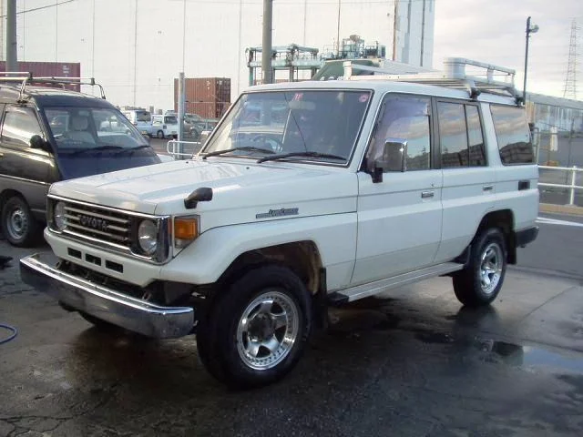

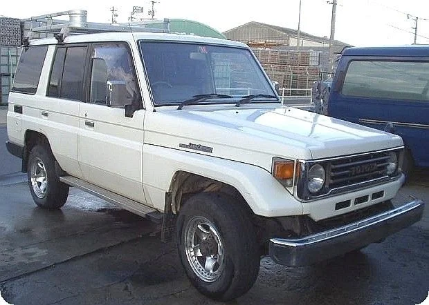

Here are the photos (courtesy of Wayne's tireless efforts).
Cheers!
Bone

Moose and Bone are gonna drive us all crazy with jealousy showing pics of their cooler than cool cruisers

Very nice!
I didn't know some JDM's come with semi floater rears.

PZJ77's are Japan only AFAIK.
