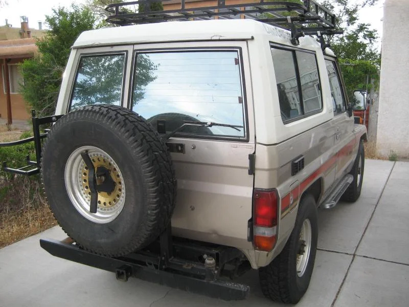

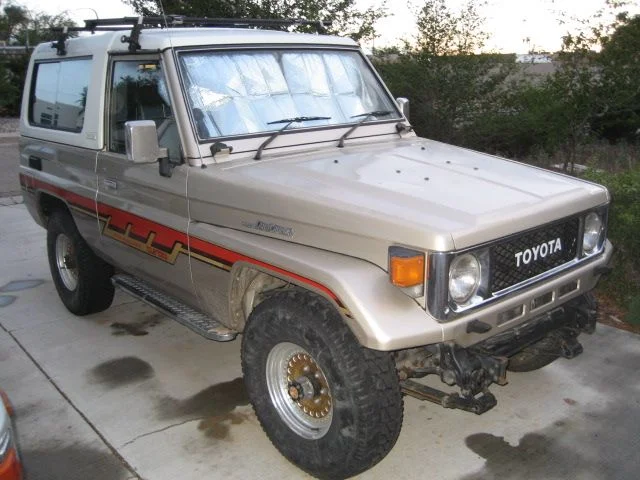

As promised... more pics!!!!!
Delivery day - front and rear driveway shots.

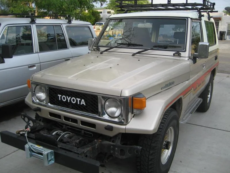

PTO winch, front & rear bumpers, and roof rack removed, planning stages for bumper. I am going to try and keep the PTO, but still have an appropriate front end.

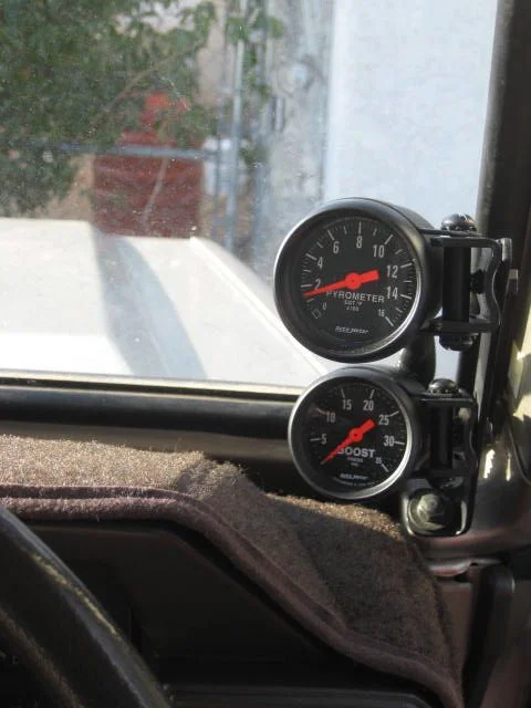

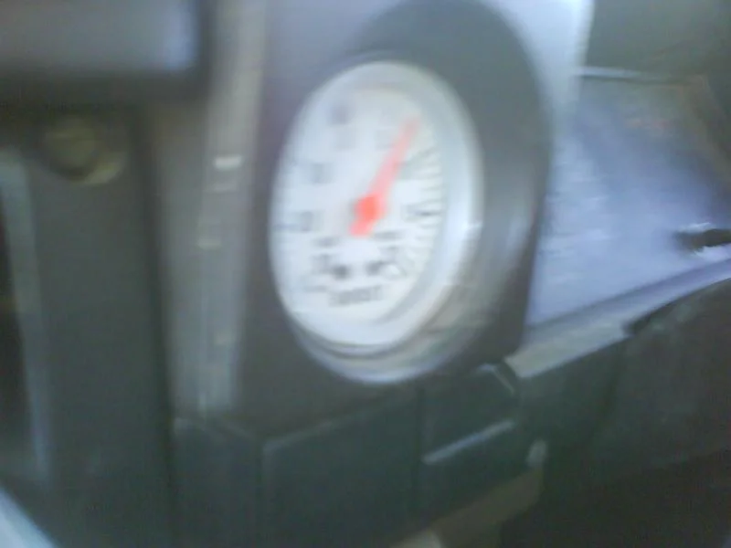

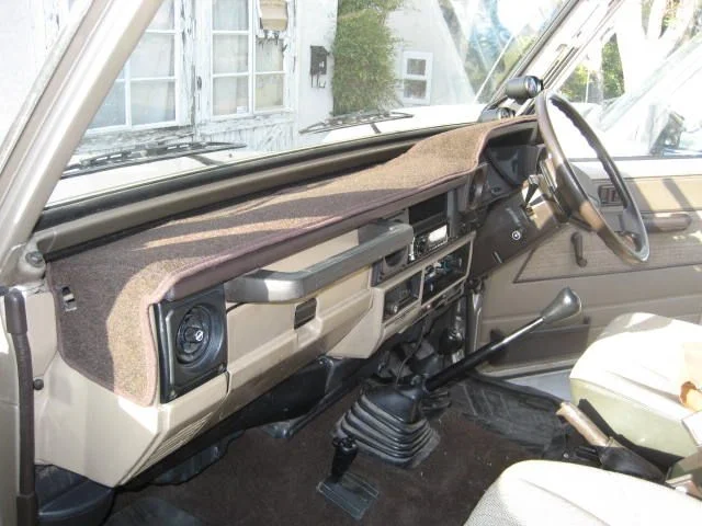

Slowly but surely... I was able to get some time this weekend to wrap up a few projects. Finished the gauge install and the dash cover was made (NM sun is brutal).
Pics of the gauges installed and the dash cover. I did the pattern then took it to the dash saver factory outlet. It turned out nice! Gauges are Auto Meter brand Z-Series 12v hooked up to the 24v=12v reducer. Replaced the bulbs with 24v bulbs and wired it to the cruisers lights.

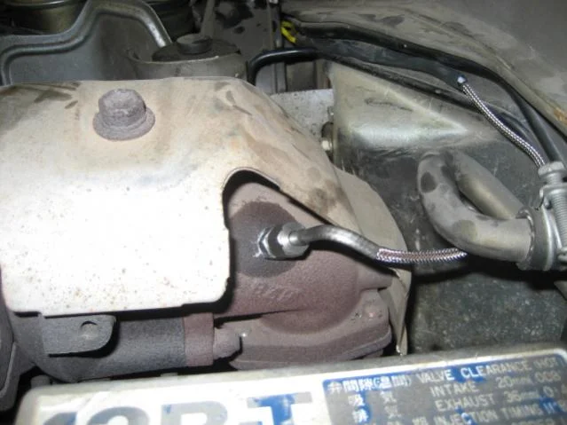

Pyrometer probe install - decided for post turbo. Several reasons: ease of installation, I'm not tuning it to maximum levels, and IMO i feel the numbers are all relative... have to realize what you have and what you seeing, as numbers go.

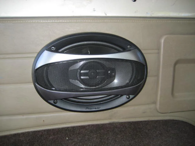

Speaker install should be finished today, exhaust installed next week. I'll post up some EGT numbers.

I have the same set up as you almost. I have the pyro probe in the same location:
Here are my gauges:
So far my EGT's are:
Town 500 - 600F
Highway on the flat 600 - 800F depends if accelerating.
Short hill no load 800F max
Highway hill with trailer 925F max
Pretty good numbers I think. Well under the 1050F max for post turbo.
I have read that 1050F is max you want to go post turbo so I that is my bail out point.
What sort of number are you getting Jericho?

Im liking how your dash mat goes to the edge then folds down the side

love the dash carpet!@

Im getting slightly higher numbers, maybe 50-100 more. Boost is at stock 8psi. I have a boost controller that I took off to get some stock numbers, exhaust at the end of the week, then the boost controler goes back on. Im using the same max limits, but try to stay closer to 950.

Thank you! It turned out well, the dash shop owner was skeptical at first, I guess he gets some doozies of patterns.

I was looking for a bit of conformation on my numbers from someone who installed the Pyro i the same spot as me.
My stock boost was 8psi to. Your numbers should come down a bit with the boost cranked up to 12psi.
950 sounds like a sensible number to bail out at.

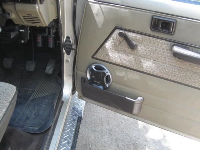

Several more things checked off the list! Stereo has been installed for some time , needed to finish up the speaker install: two 6x9's in the rear and two 5 1/4's in the door. Sounds nice, rear speakers were a snap to install - the fronts weren't bad...just needed some careful measuring. Factory tool box in the back was removed for the left rear, not sure what I'm going to do with it.
Door speaker pic
Rear speaker

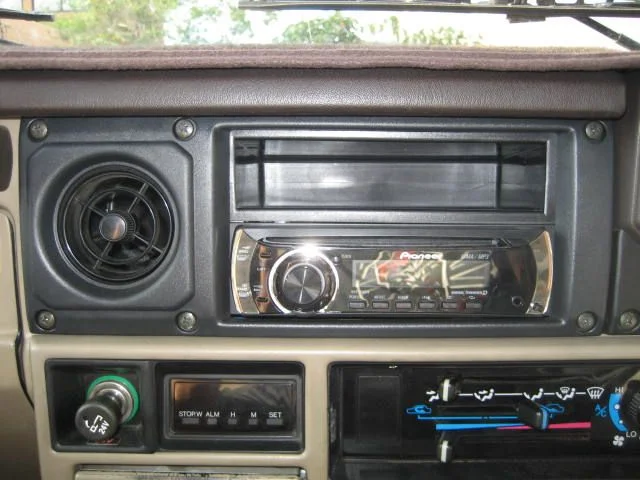

Stereo install with pocket. Like so many stereo trims, it was broken, i found a new replacement online from Toyota Parts - ToyotaPartsCenter.net. I plugged the part number in and they had it in stock! I've been using the EPC and that site to check on available parts, its been working out fairly well. 12v power from a 15A reducer mounted on top of the glove box. The cig lighter was converted to 12v ,and the old 24v key on power is now switching on the relay.

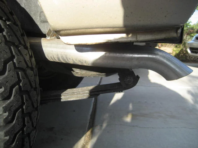

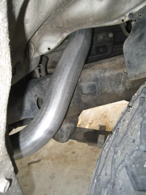

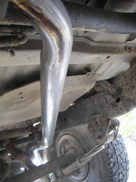

Another big item to check off... the exhaust. WOW! Awesome mod. I went 2 1/2 from the turbo following the factory route, minus the muffler. EGT's are approx. 100-150 degrees lower, but the biggest thing that i have noticed is the recovery time. The stock exhaust took a while to cool down, the new stuff drops the temps fairly quickly. Sounds real good, and its a quick way to drop a 100lbs. That stock double walled tubing is heavy! Pics to follow.

2 1/2" Exhaust

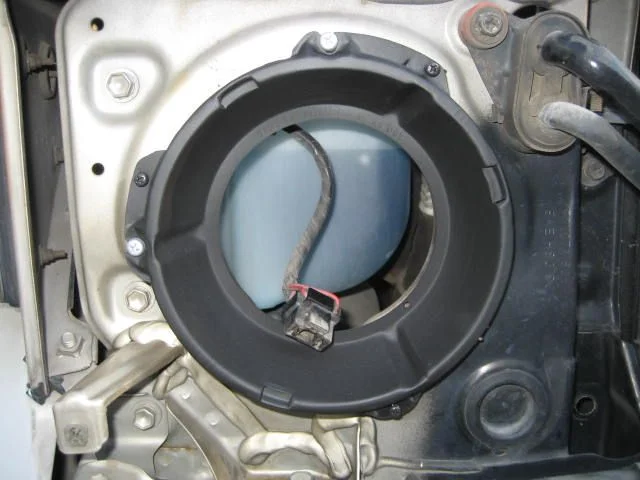

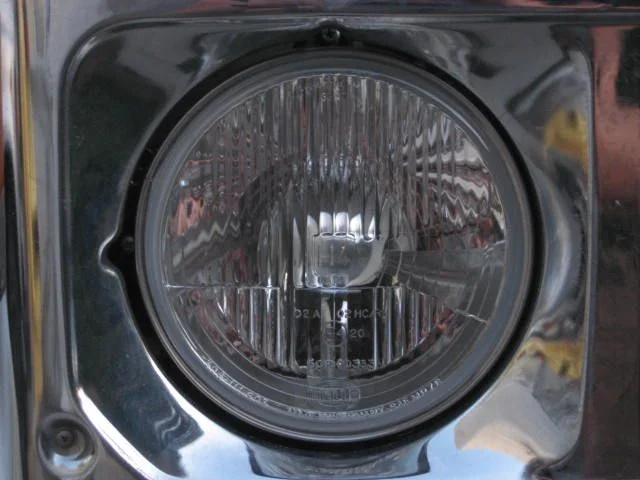

What was planned on being a simple lens exchange turned out to be a two week project! The original lenses were trashed! 1 - they pointed the wrong direction. 2 - Moisture took its toll on them, rust set in and they fell apart from the inside (couldn't see a thing). Moisture also took out the adjustment screws and the screws that hold the retaining ring. Went for the quick fix with some bolts from the hardwear store... looked like ****! So off to Toyota, got all the bits to do it right. The time waiting for parts gave me a bit of time to clean up and paint the lens brackets. Cant wait to take it out for a night drive!
Another project finished was to get a bit more room in the front right. I added some spacer and longer bolts to raise the seat about 10mm, think i need another 10. Has anyone else done this, and how much did you lift the seat?

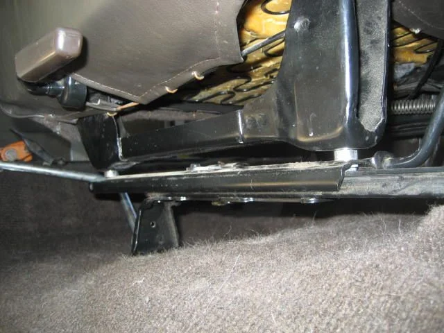

on my BJ74, I used "Unistrut" to move the seat up... and back. I'm 6'5", and needed all the legroom I could get. Now it is really comfy. Was very simple to do.

I moved mine back 3" by installing some 1/4" flat stock between the seat and slider. I did not move it up. I am 5' 11" and I still have adjustment to move it back still.
My next mod will be a tiny "dead-peddle" to rest my left foot on. The HZJ79 have these sorta carved into the transmission tunnel.
Quote:
My seat mod is not enough! You guys got pics? I'd like to see it. I was going to go the flat stock route, still thinking about it.

I love the results from my exhaust! Made it run like a new truck!
