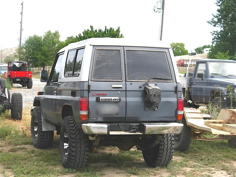

Wanted to say Hi; Bought/Buying a sweet BJ74 with 13bt, locked and loaded! 60,000 original miles.
Now Selling my 1988 FJ62 expedition truck and now building up the 74 with; Spring over axle lift, and 4.56 gears?, repaint same gray color and repaint roof, bigger exhuast size?, gauges for pyro, and boost. Snorkel,pre-cleaner, hot water shower, compressor, BFG Mud 35's, Bull bar, swing away rear bumper, sliders, and building trailer to pull/sleep.
Need advice help; on the 24/12 volt converter;it's not hooked up and looks like wires were cut, I need to know how to check if it's working/works< as stereo, cigarette lighter needs to work soon...may be shot?
Also, any tips for tuning, and gearing if you've run 35's with yours? SOA? Has OME heavy/medium now... want more...Going shackle reversal also, and going with wheel flares.
Running different blends of diesel, wvo, kerosene, and LOVE IT!
Thanks, this truck is so frickin' cool! I will not go back to gas, and also going for a troopy soon too! Addicted to 70's!

can we get sum more pics

Where ya going that OME, 33's, lockers and BJ power can't take you? X2 on more photos please.

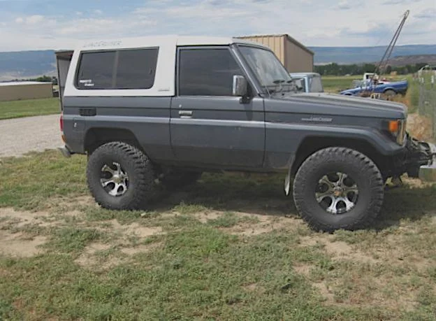

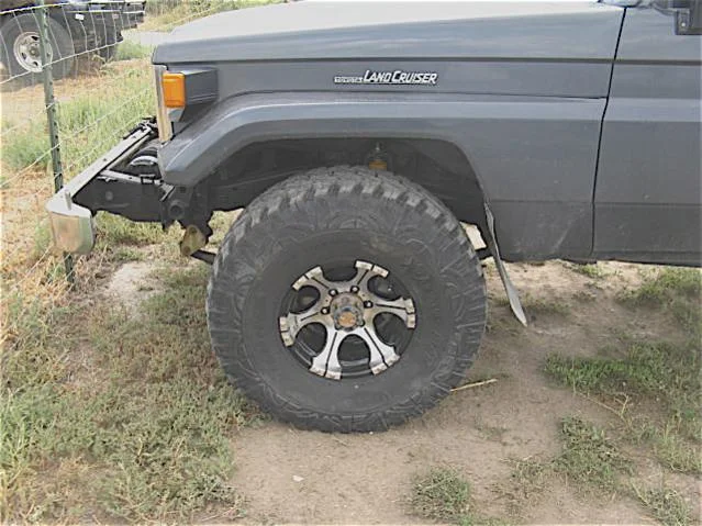

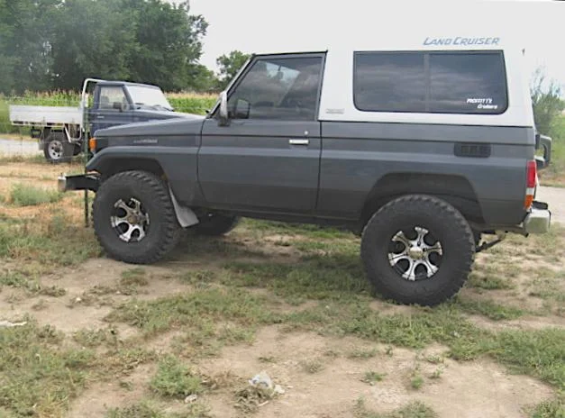

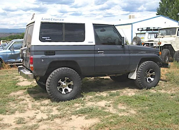

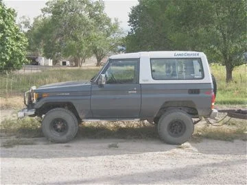

Here's a few pictures. I appreciate the help, advice!

Thanks for the photos! I see that you were trailering something, how'd that go? I am really curious how much that extra 10 inches does for you in trailerability. Just barely enough wheel base to feel under control, or still not quite enough?
