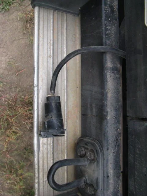

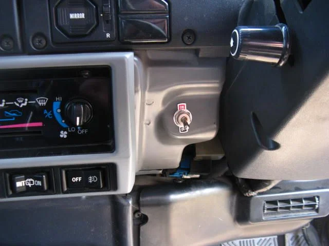

Do you know what this switch does?
Thanks for info on converter!
On my BJ74 (24volt) this switch is to the left of the steering wheel, on the dash where on my 62 would be a hand-throttle.
I cannot figure out after trying a lot of testing, WHAT it is for-Do you?
Please tell me if so, I have all others figured out and working, except this one.

I had a switch there also, not sure what its for... it was not connected to anything and its not supposed to be there(aftermarket install). I removed it, I'll fill the hole with a new light switch, or something when the time comes.

I'm not sure if Mr Toyota put anything there??? Maybe there was a switch on the super luxury models. Mine has a switch in the same spot as yours for my IPF 900's. I found heaps of wiring going nowhere from the PO that I've been pulling out. I have got the main wiring back to stock and have set up an aux battery system to run acc.

That is an after market standard type switch, driving ligts or some other type of non genuine accessory

I have excacly the same switch in the same spot. Mine also a 1987 BJ74 . Coinsidence ? Mine also not conected at all. Could it have been a standard type aftermarket fitment, perhaps fog lights or simaler ?

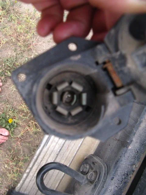

the switch
I thought previously it might have been used for the old now removed 12/24 solar converter, but there was no connection going to it at all. I'm gonna have a closer look, verify the many wires connected and see about tracing it down. Soon replacing the converter and may use it for the new setup.
I also have this huge "pigtail" for either trailer connection or boosting other trucks, and thought it could also be for that. Anyone else have this pigtail still on your JDM truck? Reminds me of similar stuff used on military vehicles.

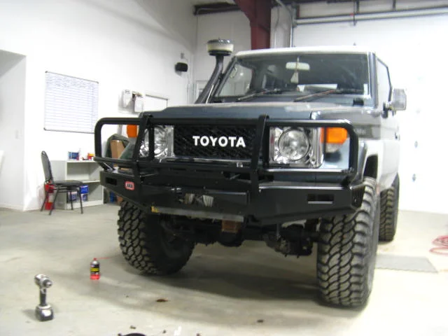

Snorkel installed tonight!
Tonight after work we installed the snorkel and big pre-cleaner onto my BJ74. First thing I noticed after starting it up was the obvious amount of air being pulled in thru the pre-cleaner, which is mounted on the right-hand/drivers side;it is loud, but driving home I noticed a bit more power, and an even smoother running motor than before. It's dark now so pictures tomorrow.
Monday-shackle reversal, and new brake booster soon too. Sliders, and exhaust very soon as well!

snorkel
picture of snorkel on.

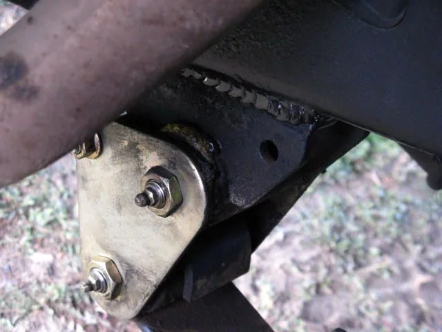

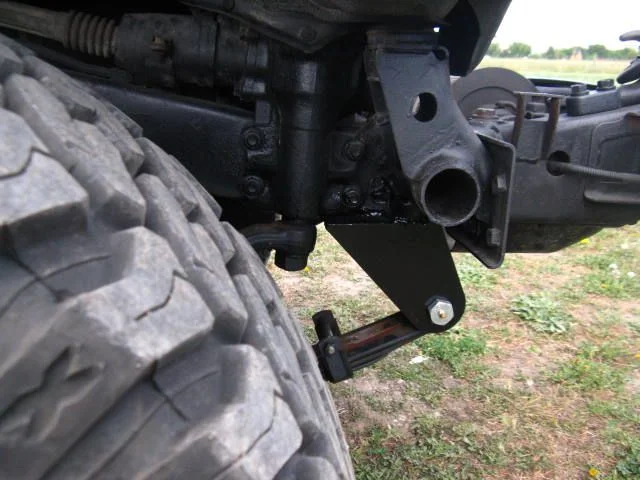

Shackle reversal DONE; Here's pictures!

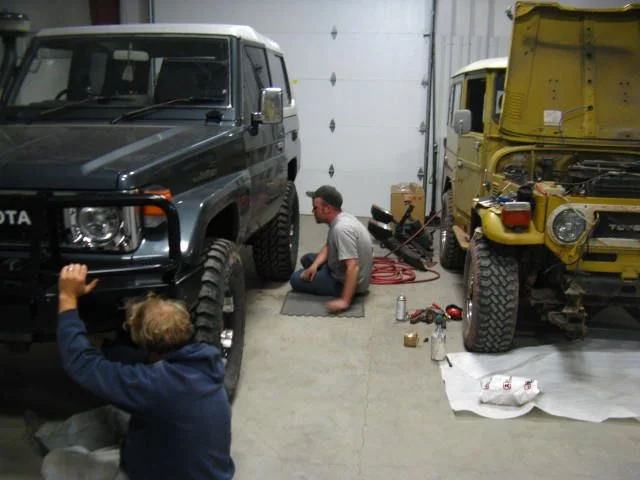

Tonight we did the shackle reversal-(pictures tomorrow); it raised the front end exactly 2" higher to level out the Old Man Emu lift. We used Proffitt's Cruiser's custom spring hangers ($90) and everything went great! I did combine/move the brackets around for the front cable locker so as to give some slack where needed, and make any taughtness or tension go away, and get smoother action. We moved the axle forward 1.5", and gained the needed clearance for the 35" wheels. I recommend this as the right way to get the needed room/lift. Handles and rides like a new car.
The snorkel install was not a big deal either, hardest part is lining up the 4 screws and holes on the side of truck, as the templates are not correct in the positioning of these screws/holes so we had to keep making them a bit larger to align everything, and use fender washers to cover the holes when done and reinstalling snorkel. All in all both mods were necessary to me, and not hard at all, but these guys @ Proffitt's have been at it way longer than myself, and are PRO's.

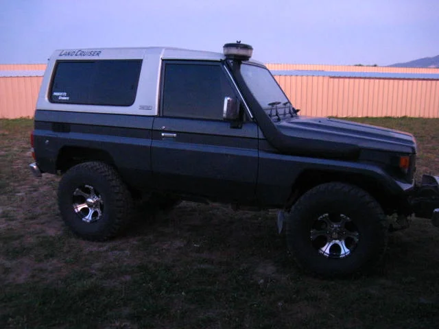

Better photos
I wanted to put these pictures here as they show better how truck sits now with shackle reversal/axle relocated 1.5" forward. The rig handles very nicely, and no rubbing anywhere, front or back.
To regear or not is next, then speedo correction, sliders powdercoated, exhuast 3 " straight pipes, body work, speedi-liner, and paint as needed...

shackle reversal
First and foremost the ride is way smoother now. The bumps ane no longer jarring and the truck does not wander anymore, due to better caster angles. Moving the axle forward also helps a lot, and the ride is like a new vehicle. I recommend doing it, and it also lifted the front end 2" to even up the raked look after the OME lift was done.

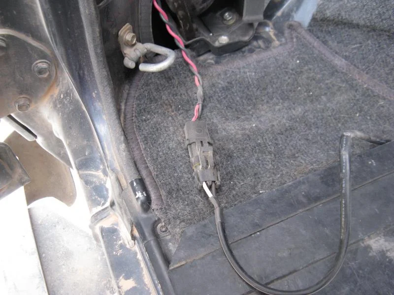

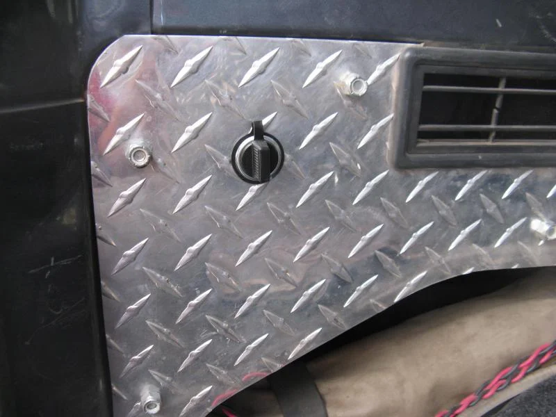

12/24 converter installed
Got a chance to have the converter wired up, and also an outlet for both 24 volts plus 12 volts installed in rear cargo area. Fridge is hardwired with 24volts now-always hot, and cigarette lighter has 12 volts. The Samlex SDC 23 mounted above glove box hidden and out of sight. Everything works great.
Next the bumpers get fabricated, and powder-coated, to match the sliders now waiting to go on.

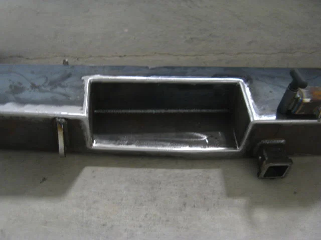

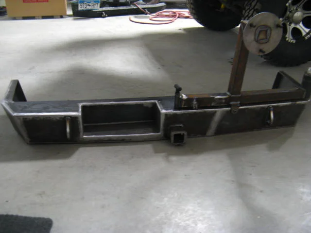

PTO to ARB bull bar, and custom rear bumper fabricated/mounted
The past few days this week began the building of the rear bumper, and also fitting a new ARB bullbar to the factory PTO winch up front. I wanted to keep the factory optional PTO winch as a cool, original item, and becuase i am familiar with them from my military days, and I like them, and trust them.
At this time too, any rust issues are being cut out and replaced with new metal. The lower body line down will get E-Z liner(SpeediLiner) sprayed for rock/rust protection too. Fender Duraflares will go on soon. The custom sliders and both custom bumpers are getting powder coated, and then back on after a bigger exhaust is done, and paint is done.
Here' pictures of work being done, bumpers, and PTO.
The rear bumper was made to have a "factory" looking step built in that will serve as a small shelf as well as step, when camping, and for a MSR stove to cook, etc.
Retained the ability to use the small left-side rear door without any obstacles or moving anything to open the door, like for dog, or fridge needs. Very happy with the work, and custom builds by Jeremiah Proffitt @ Proffitt's Cruiser's.

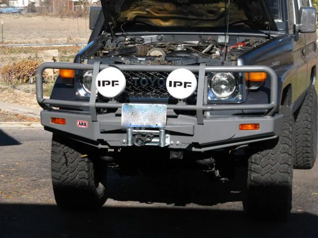

ARB Powdercoated bull bar
Here is the powder-coated bumper. Sliders are done, and rear is done.

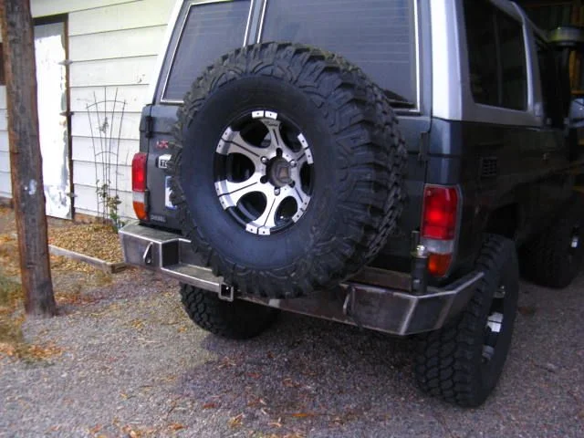

Can you open the ambulance doors with that full size spare mounted?
__________________
Bret
Juneau, Ak
1989 FJ62 3FE 125K
1992 Toy short cab 4x4 22RE 177K
89GASHOG is offline   Reply With Quote
Old 11-07-09, 09:23 AM   #60 (permalink)
250+ Club
ducatiman81211's Avatar
Join Date: Aug 2007
Location: Currently in Delta, Colorado
TLCA# 4909
Posts: 271
Rear door
Yep,
the rear bumper was designed to leave access to the back, for dogs or whatever. 35x12.50x15 tire too.
