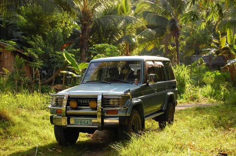

I bought what is supposed to be a 1994 Land Cruiser with a 3L engine installed. It is mostly in very good condition but I do need some advice on a few things. I will post the questions I have in the appropriate areas.
This is the Land Cruiser:

Nice front bar mate

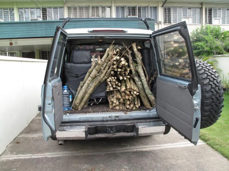

Yes it has seven seats but here in the Philippines that's not enough. I have about 45 nephews and nieces so 7 in a car is not much.
I will be making a farm style drop side trailer as soon as I can. I need to move much bigger quantities of stuff than I can get inside. Also a lot of the things like rocks, fertilizer, etc will make a mess of the car.
Yes the front bar really is very well made and very strong.
