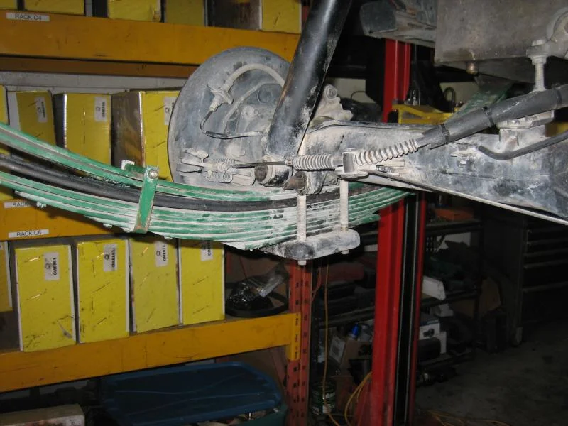

Here are some of the pics from the first day at 4 wheel.
Working on the rear springs, to accommodate the heavy loads that the truck has to carry.
We found some old CS006R OME, cut the ends off of the main leaf and second leaf, and them added them to the stack of Zeal springs on the truck.

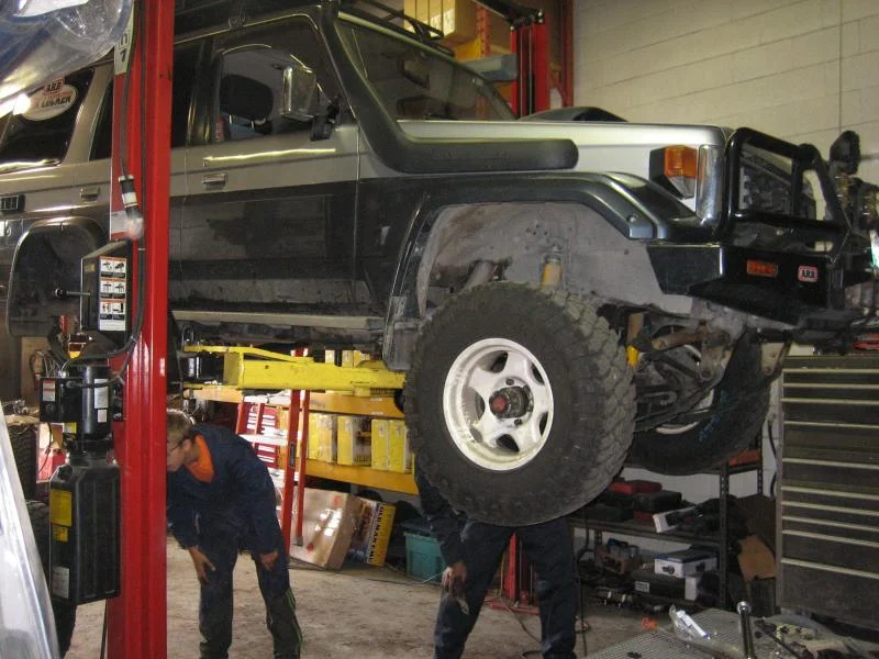

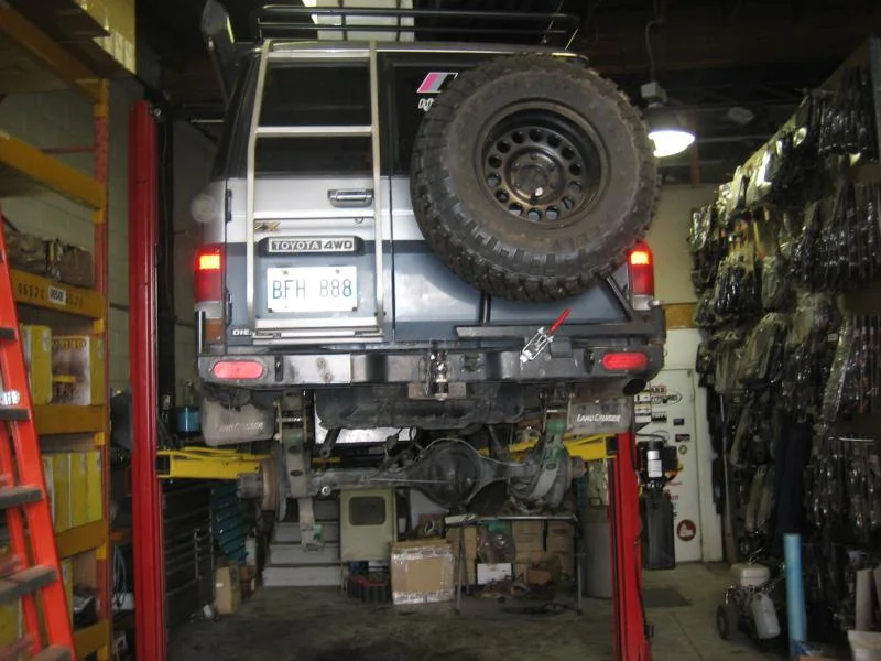

Here is a shot of the before and after stance of the rig.
Wish we measured the gained height...
Turns out the rear is half an inch higher than the front now.
Here are pictures of the larger leaf stack after the addition of the OME.
11 leafs strong now! Looks pretty damm close to a HJ75 rear leaf.

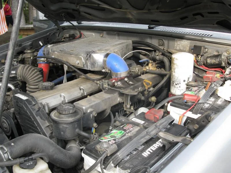

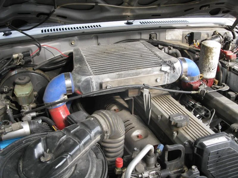

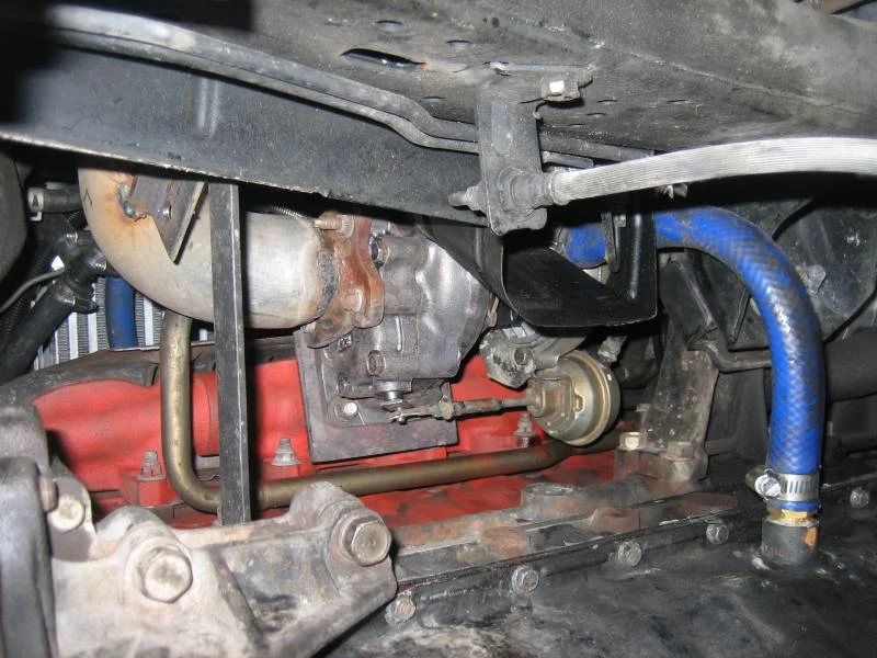

A picture of the turbo as seen from underneath on the 1HZ.
Here's a shot with myself, Simon, and Dan of 4 wheel.
