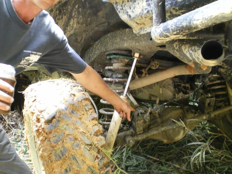

Posts: 198

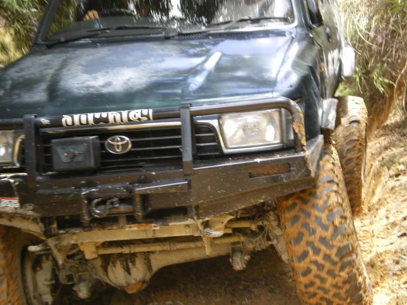

This is a Toyota Surf (4runner) with a 78 series suspension on the front. It has 80 series 5.5inch coils all the way around and doesn't ride stiff. It flexes great off road. The coils fit fine in the 78 series front coil buckets but the top ones were modified. A piece of thin steel was welded around the outside of the coil bucket to keep them from popping out when flexed. In the rear the 80 series coils fit fine on the Surf but coil bucket mods would be needed for a Prado.
BJ-44 is online now   Reply With Quote

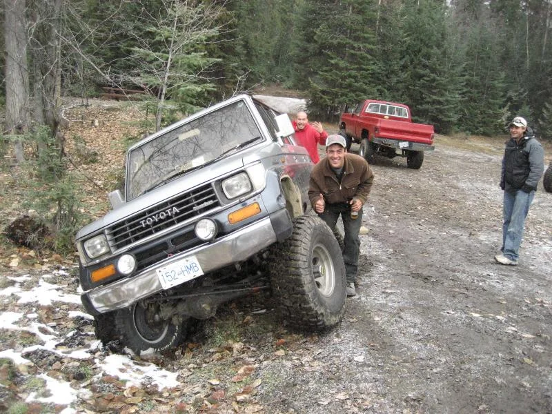

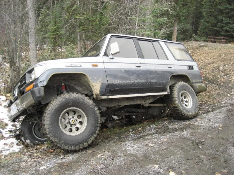

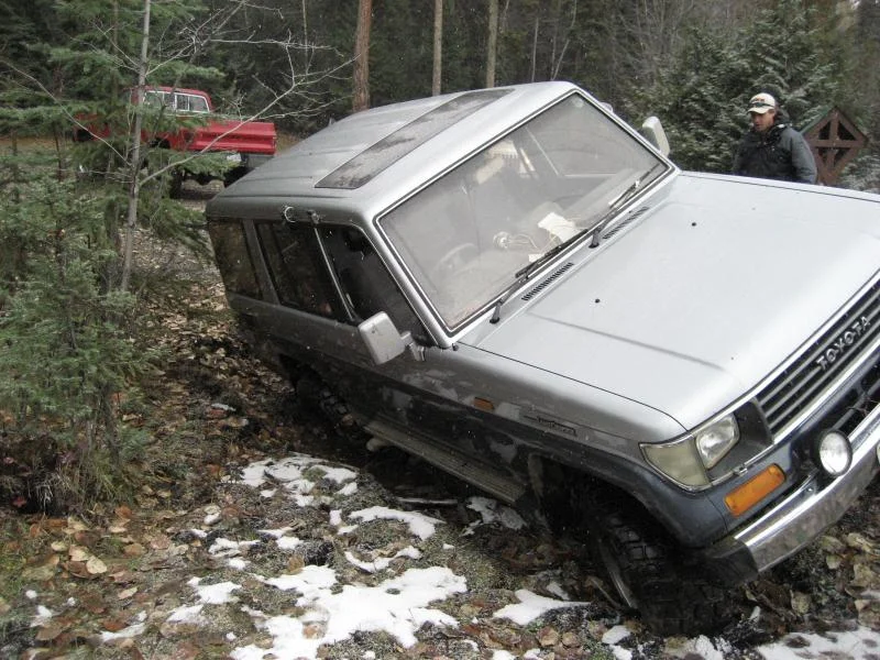

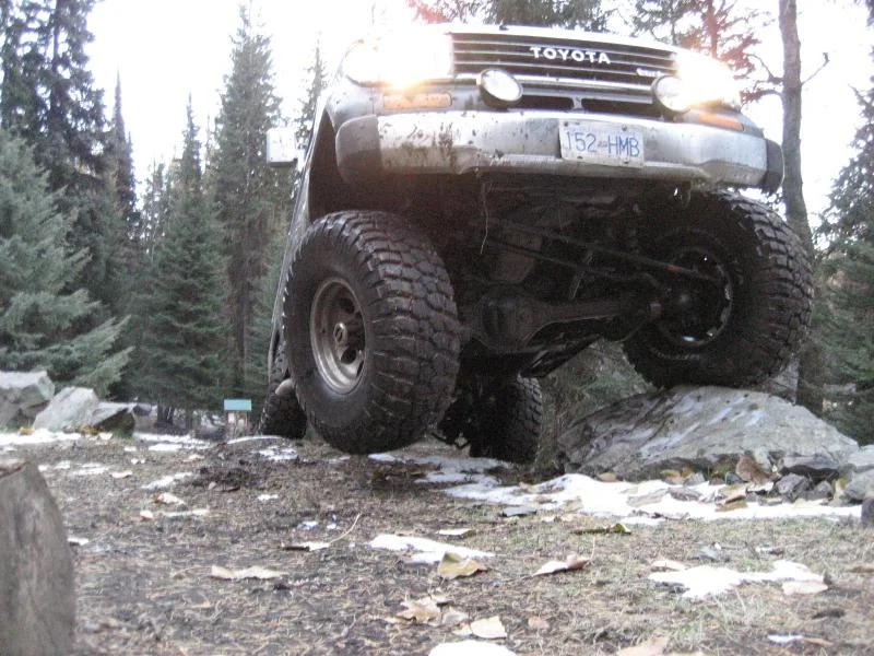

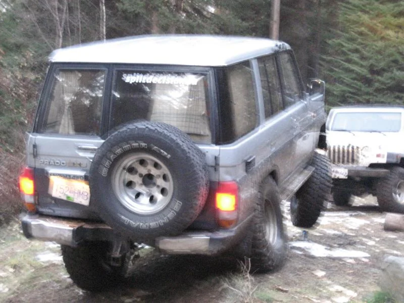

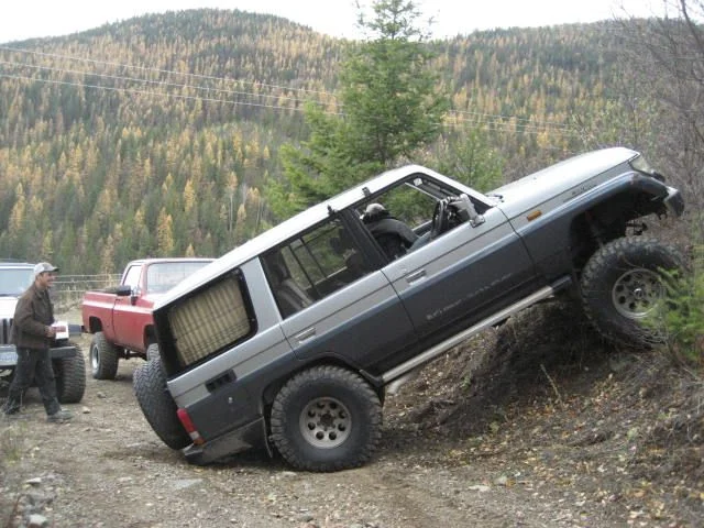

here they are
I have to make a new rear spacer to level the truck out

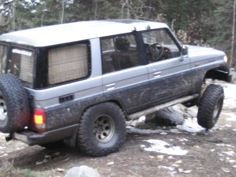

Posts: 240

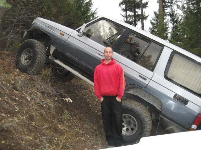

few more

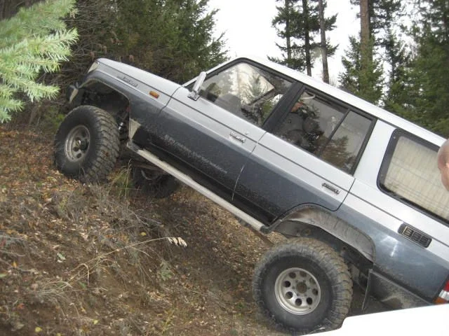

Posts: 240

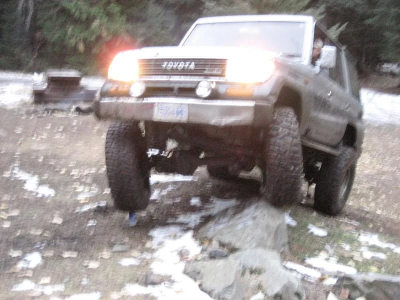

more again

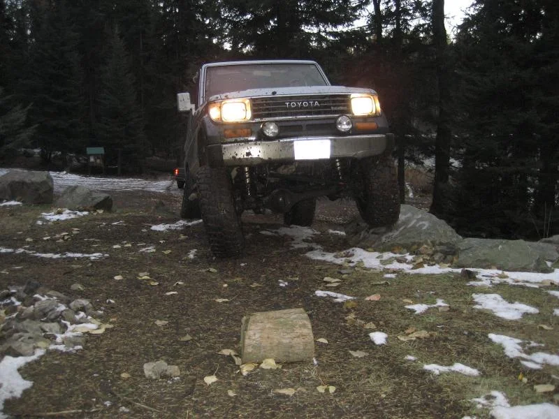

Posts: 240

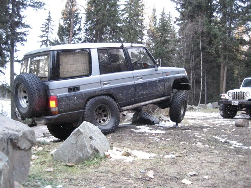

again

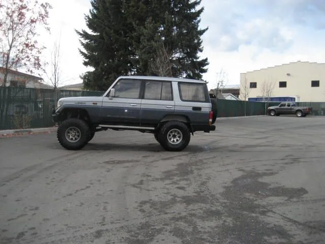

Posts: 240
and more

Nicely done!!! How did you get the 80 coils to stay nicely seated?
grease_guzzler is offline   Reply With Quote
Old 11-08-09, 05:26 PM   #24 (permalink)
Forum Regular
Join Date: Jul 2006
Posts: 240
cut the front ones so that they would fit in the bottoms of the spring perch. Made the spacers so that they would fit over the old lip rings at the tops. Springs are tight in the spacers, might tack the spacers in place if that ever becomes an issue of slippage
RHD Toyota's is offline   Reply With Quote

what really impresses me is that you can stuff a 35" tire in an LJ wheel well
