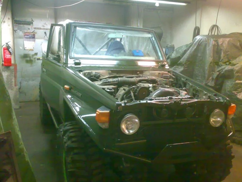

Posts: 119

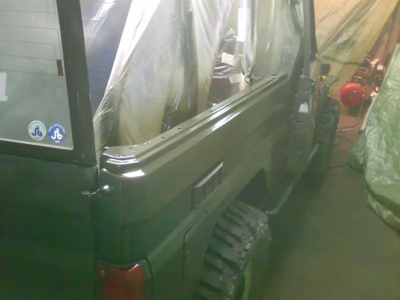

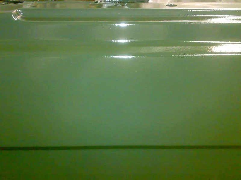

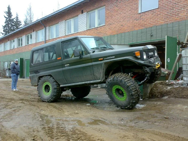

Wasn´t happy with the painting, so today i sanded the truck and re painted it. Much better now, but still if i were a professional painter and made quality like this, i would commit a suicide... But now it is best that i could do when being a nurse...

Nice job,ought to go anywhere. Mike

Michael Hanson is offline   Reply With Quote

It doesn't look bad at all..give it a few days for the paint to harden.

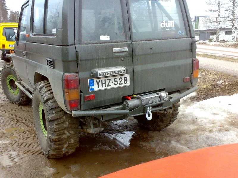

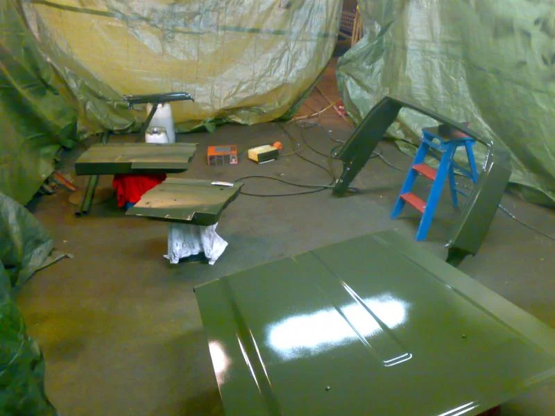

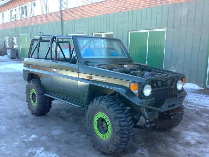

Edit: today i took the FRP top into the garage and washed it. Going to paint it tomorrow. I hope urethane paint will hold on it.
Edit2: Here´s outdoor pic and left overs painted. Including rear summer doors.

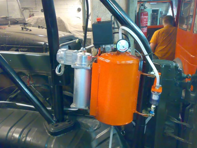

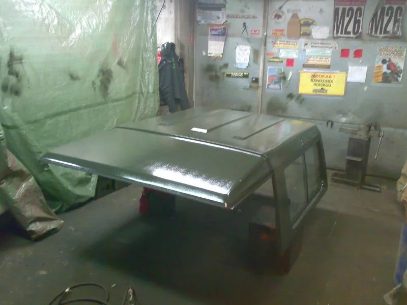

No more boring, dirty, white FRP top. After the painting i started making the pressure air system. Viair 450 24V and about 6 litre tank. No pics yet.

Thanks! I am really looking forward to get it ready.

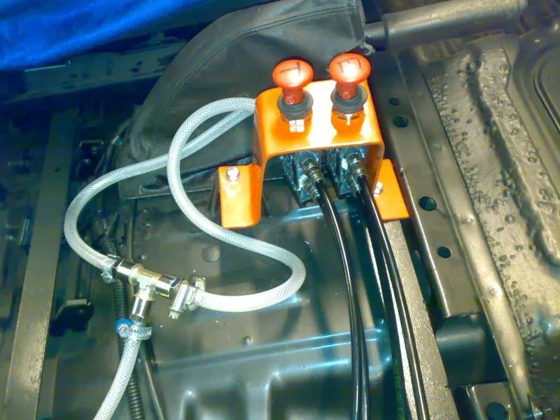

Today i got the air system done and lockers working.

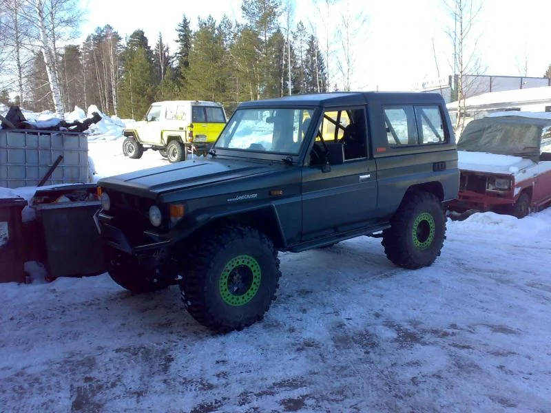

Top on:

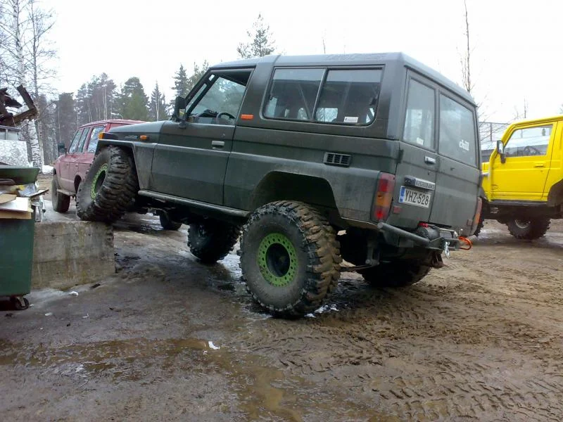

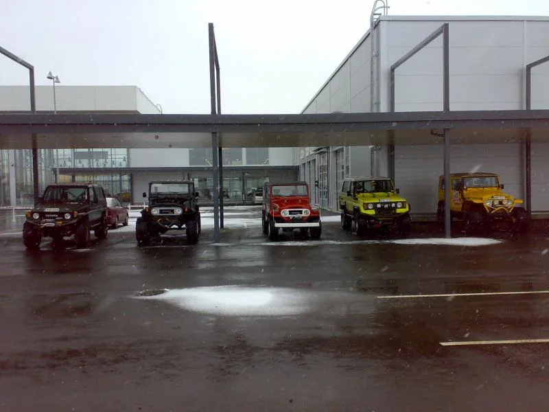

Against all expectations, this turned out to be a show truck. Rigs from our club waiting for the great opening event of local Toyota dealers new building.
On friday I drove BJ home from my shop for the first time since november. Great feeling! To do´s: some wiring, new oil pressure and water temp gauges, some armour for tank, transfer and transmission and something to prevent tie rod hitting the frame on full compression. And some more little things.

Why you change the system Cable-Locker to Air-Locker???
Thanks for the pics.

I changed them mainly because i haven´t done it before. And second, i didn´t have cables and levers. I like to do things what i have never done before. Learning, you know.

1. What did you use for hold the air solenoid .. ( lockers ) and why you choose air vs cable ( don't get me wrong respect your choice only wanna know why .. )

1. I´m not sure i understood that "hold" thing? But pneumatic cylinder that moves the locker fork, is push-pull type. I chose air mainly because i haven´t done it like this before. Learning. And i didn´t have cables and levers.

thanks .. I was talking about the pneumatic cylinder .. how you can release the air .?

Those switches have the pressure relief valve that releases it from the other side of the valve. It is not nessessary to release the pressure completely. But at my switches there is also middle position where they block the pressure from both sides. Toyota lockers works differently from ARB. Air pressure just moves the fork back and forward and there is a spring that actually engages AND opens the locker when teeths are in line.

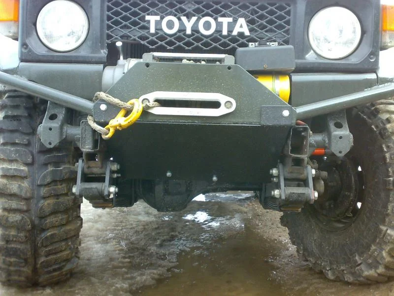

Truck have been starting little bit rough and fuel pump´s been leaking. Today i dug into that problem. Pump leaked two places: between the top and pump body and from the throtle link axle. I put some sealer between the top and the body but didn´t have right size o-ring. No more leak from the body, starts well and much more power. I guess it has been sucking air in too. Still little leak from axle, but allready better. Have to open once more when i get the o-ring. By the time i was in there, turned up the fuel a bit too.
I forgot to take any pics... But here is couple from front and rear. Quite well protected steering and rear winch ready to work.

That 45 is my friends HJ-45 with H engine. It is soa, PS, welded rear, cable locker front, shortened wheel base to match with BJ-43 and shortened bed.

Little stretching. Like i said earlier: not a RTI champion, but very stable. Works for me.

Hey sounds great! i have no idea when i'll be going back to finland because im a student for the next few years yet...but if i get a chance ill be in touch for sure!
truck looks awesome! iv never really had a ton of flex...i just push the gas peddal down a little further and it seems to get me over all the same stuff the flexy guys can do

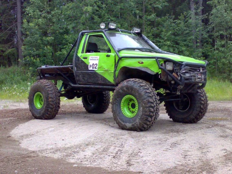

Location: Tromsoe, Norway
Posts: 478
Sweet build!!!
What happened to your hilux with portals?
__________________
knixens gen2 runner on portals and 40s
knixen is offline   Reply With Quote
Old 04-18-09, 12:28 PM   #60 (permalink)
Forum Regular
Join Date: Nov 2003
Location: Finland
Posts: 119
Quote:
Originally Posted by knixen View Post
Sweet build!!!
Oh, somebody still remembers it...!?
I broke two birfields, got tired of it, sold it. New owner broke engine, transmission and some other stuff and parted it.
RIP
