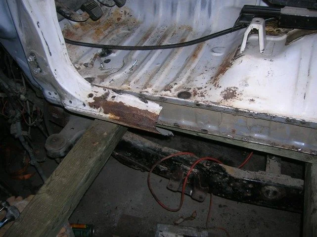

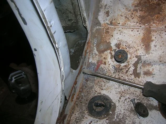

Here are a few quick pics. The first is the back end of the door, I needed to drill one more weld and then that part came off. The 2nd pic is the front, I have a bunch of holes drilled alread, and it seems loose, but something is holding it, I am guessing some welds from the back side. I will check it out some more but the spot welds are a little tough to tell, especially with a little surface rust on it. Anyway, will post up if I get it. If someone sees this and remembers how many spot welds and where, please let me know so I really don't turn my truck into a sieve.

Well last night I did some more choping and found the bottom part of the rocker where the front fender bolts through was also holding it down, but still something up top. I think there is one spot weld in behind where the screwdriver is pointing, and was tough drilling, will take some more time with a smaller drill bit later, if not will notch that section out with the grinder.

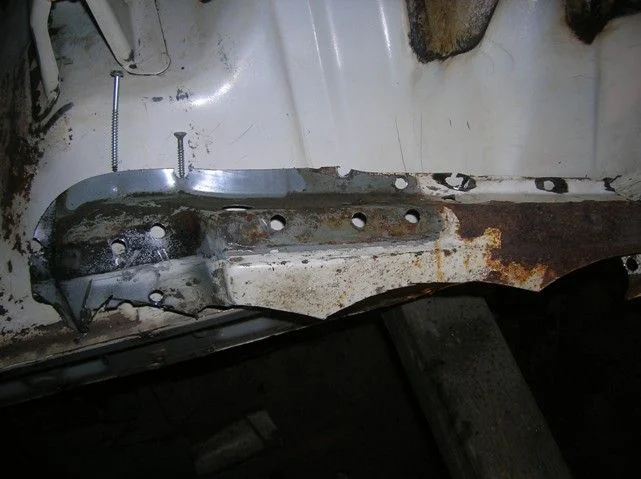

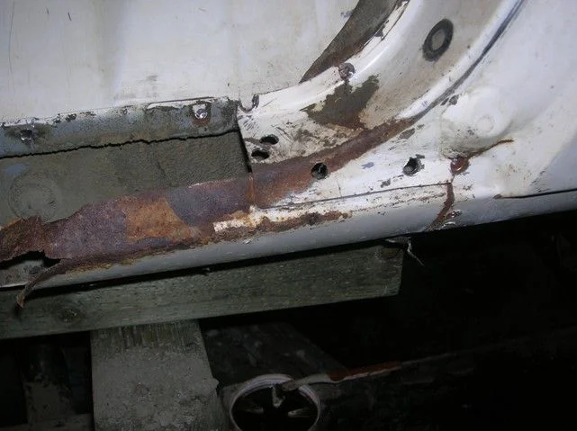

Well here is the final verdict:
Apparently when they put this (I don't know about other 70 series too) truck together, they spot weld the rockers on before the rest of the tub. I drilled the one spot weld by the clutch peddle, and it still wouldn't come. I hammered on it for a bit and the last s. weld let go. The last weld was impossible to get to (seen in the pic with the long screw). The short screw shows the second to last spot weld I drilled out just at the base of the floor.
