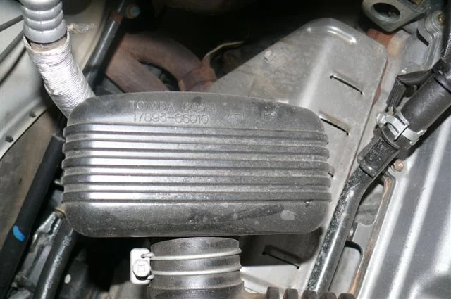

Here are some pics of mine:
I don't have any current pictures, this is from a few months ago, it was a few weeks old in this picture:

Wow, the MAF housing area is completely different looking. It really does make me wonder what sensor they use. Do you know what all is housed in side that black box that T's off the intake? It looks much larger than would be needed just to house a sensor.
I also see the FPR line is still there as was stated in the 80 series thread. Interesting stuff for sure, but with a different housing, presumably different sensor and likely different programming of the ECU, it seems we're still guessing.
Anyone know the part number of the airflow sensor in this truck?
Not really, I had assumed it was some sort of water/dust trap.

As far as that black box on the intake, I'll bet that will turn out to be some kind of resonator box and it probably empty. Otherwise, looking at the EPC data, Toyota did produce an air temp sensor, which is different than our MAF sensors, that might have gone into somewhere. Otherwise, someone on the other board pointed out that instead of a MAF sensor inline with the rubber air intake tube, like our trucks, your rig and possible all other 1998 and newer 1FZ-FEs appear to maybe use a MAP type sensor inside the intake manifold.

Here you go, this is out of a 93 FZJ70:
