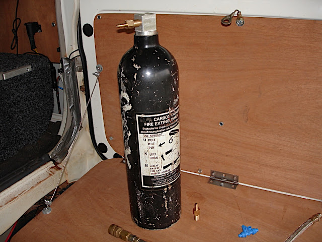

So, waiting for me are a few goodies that I collected from our shipping people. First up is a big box with a Celica air-water i/c set up I got on ebay. Unfortunately I had my suspicions about the possibility of mounting it, and yup it is not going to be doable without serious hassle. Too much hassle for a low boost expedition vehicle. I really cannot see it working. The heat exchanger and rad are both just wrong dimensions. Shame, but I am not prepared to make the changes required for a remote travel and pretty new vehicle. I will think about it more, but an afternoon head scratching tells me no!
But the second box (from Carl at JT Diffs here on MUD) will fit! In it is an ARB airlocker rear and Truetrac front plus a nice ARB compressor...
Other stuff - well I bought a LR (ducking) cargo net for hanging on the cargo barrier and stuffing odds and ends... Stupidly I left a set of lightforce diffuse covers in Scotland (doh ) Fender flares never arrived in time to take with... and we have just had a falling out with our logistics people in Germany so DHL are going to lighten my wallet. Oh and a nice iPod holder for the troopy too Time is running now (end of May is looming) so better get busy.

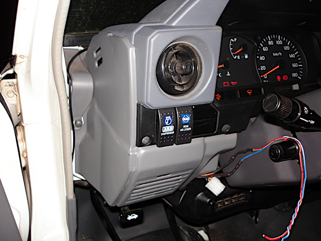

So here are the next stages. Well obviously I decided to go down the locked route... Carl from JT's here on MUD did a great job and cheap shipping - turns out cheaper to buy an ARB rear and Truetrac from NW USA than EU (also considering shipping!). Been busy like hell at work as we get closer to leaving so not much real progress this week, although our machine shop have been bribed into turning various fittings for the air system I have planned. I decided to get an ARB new type compressor when I bought the diff as I wanted to build a fairly high capacity air system and the ARB would do this together with my old VIAR that has done me proud over the last 5 years or so. It is so hard not to plan this stuff when I have access to old truck air stuff and CAT too... Anyway that comes later - although checking under the car God knows where I am going to put my receiver (unused surplus stock from a CAT 930 wheel loader).
So tonight I just did the switches in preparation and scouted locations for the ARB compressor and tank etc. Should be fun!
ARB on the right (obviously )
ARB compressor - nicely made. Fitting next to the solenoid will go to the tank with a valve so that the ARB and pressure switch control either diff alone or the receiver pressure. I will have a switch so that the VIAR will also be triggered when in air system mode rather than just diff.
Switches and front part of the loom wired in ready.
I must say the ARB stuff seems real quality (never physically seen their stuff before) and the loom makes it all simple. Tonight I am praying to Lord Bishwokarma (the Hindu God of machinery) that the diffs are the correct size as they are a long way from where they came from

Those switches make me smile good stuff must be happy as .Just notied the dash having the fuel and temp gauge were the aus dash have the tacho is this a standard one and were would the sub tank gauge go if they come with one?
Clint79 is offline   Reply With Quote

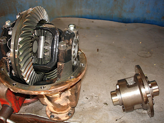

So, ARB time... took a fair bit longer than expected! Myself and Coby (great guy and super mechanic - very skilled, I have enjoyed working with him for 14 years and will miss him). Finished the third member set up but darkness stopped us sticking it in the axle. 4 hours... however in our defense we did lathe turn a sleeve to press the bearings back and pick up a propane cylinder and sprint back to the house to cook up the crown wheel. This means we finish tomorrow and quickly do the Truetrac and partial air system - at least enough to check it works. You guys might laugh but Coby thinks I am mad for using a dial gauge and torque wrench. Here many, many things are very different. Was fun!
He reckons a dial gauge hasn't been seen on a diff for years here!

Well, this was how we finished up on Saturday evening, with the ARB installed into the 3rd member but not into the vehicle.
So Sunday afternoon we were back at it again. Although the front axle is obviously more complex to strip and pull the drive shafts, other stuff went faster so by darkness we had everything installed and put back together with fluids replaced. Having a gas burner and pot in the 'shop plus our bearing press tool already made saved a good bit of time. The only thing left is to finish the installation of the loom and the compressor/airline, but the humidity is so intense that by the time it was all together I was in no mood to wire anything - the two of us got through 6 litres of water yesterday afternoon and most of that was me.
Here you can see that the Truetrac does look stronger than the original diff, although as you can see from the last picture the size difference from rear to front is substantial!

Here is the compressor installation - in the battery box on the hinged lid. This afternoon I didn't do so much.
I just sorted out the second line and valve coming from the ARB compressor. Here's the fittings we made up:
The receiver I made up from an old CO2 extinguisher is way smaller and will tuck in beside the chassis rails or just under the rear bumper. It's really just there to give a blast of air for cleaning stuff or the initial oomph to re-seat a tyre. Cost nothing so why not. I also found a small regulator/water separator which I may as well stick in the line.
Will tackle the mounting when the slider steps are finished - they are under construction at the moment. The plan is to get them painted up and fitted during the week, fit caster correction bushes and then clean and prep for underbody sealant, spray and then fit fender flares which will be here next week, tidy up the water system - not happy with the hose and valves. Just measured a 20' container and compared to the troopy - gonna be tight with that tent up top

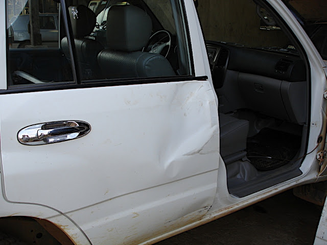

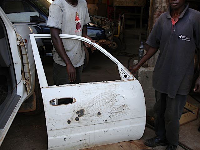

Today was a bad day in the bush I arrived at the workshop and parked my 105 in the usual spot. Two hours later I got a text message that the car had been hit by a truck... A Tata 3.5 ton truck had a starting problem a good 100m from the 'shop. They had raised the cab and bridged the starter, only problem was that it was in gear. It shot off towards my car and hit it side on. amazingly the 'B' pillar and the sill are totally undamaged. The whole of our workshop - including the manager that "supervised" the Tata are highly embarrassed - so much so that they had paint on the road from a major city within half an hour and the front door whipped off and beaten pretty straight by lunch!
While I had the camera out in the shop I thought I would take a picture of my old GX 105. This poor car I really drowned in a water crossing gone badly wrong. Drying it out turned out to be impossible, despite us sticking it in a wood kiln for about a week. The dampness corroded the hell out of all the dash wiring (water was at windscreen level), and a year or so on the electrics were causing havoc. The local dealer wanted $4,000 USD to re-do everything, so our guys are slowly getting there with a multi meter! I am frankly astounded by how much stuff is under there - remember this is a basic 1HZ vehicle, so all the gizmos are just for heater controls/AC/windows/interior lights/etc etc. People are starting to talk - the predecessor to the GX got a tree felled on it by accident - unfortunately no pictures, but it was something to see believe me (it was just a green lump as the whole crown of the tree got it! It's still in service though, although in other places it would have been a write off).
Our panel beaters get a LOT of practice. Almost every week something happens to something!

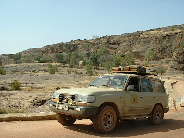

So here are some travel photos:
Somewhere in Mali 2004 - Christmas trip with us in our Defender 300Tdi and friends in their HZJ80. The 80 we had to temporarily abandon in Mali with two of the girls after it dropped a valve! Took us 10 days to sort out a used engine/fitting.... it then only made it to the Ghana border - and a flat bed home! Expensive trip for my friends! The Defender broke down numerous times, but I could always get it back on the road.
Door in Dogon Land (traditional animist tribe who resisted a lot of attempts at being converted to Islam or Christianity). Amazing place.
I think we were getting hexed here!
Baobab tree - this is a small one
The 80 struggling up a hill - pump was shot, consumption through the roof... it was a liability waiting to happen
One of many breakdowns - I ended up going mental at the guy in the pink beanie who claimed to be an auto electrician - actually he was just a thief!
We had the rooftent, our friends had to make do... they also didn't believe it would get cold... we were snug in big blankets - they were literally shivering.
Mopti on the banks of the river Niger - full on place. Not for me. Give me the wide open spaces any day! The blocks of salt come down by camel train from the North (still!)
Check out how to transport goats - incredible. Stops them running around that's for sure!
Waiting for a sunset crossing of a tributary of the Niger (heading to Djenne)
The famous mud mosque of Djenne (I didn't take this one as I was adjusting the LR wheel bearings for the zillionth time)
Hey - what a surprise! The long and dusty road to Timbuctu wouldn't be complete without removing and stripping an alternator on New Years Eve....
"Okay - I am going to sprint back to a bearing shop - will take the 80 and I promise you after this we buy a Landruiser... no really we will"
We made it (after leaving the 'Rover in the care of a friendly farmer as there were some serious trust issues by now)
Tourist trinket sellers hassles and Landrovers. My two favourite things as you can see
