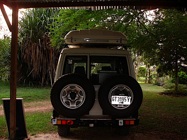

Rainy rooftent fitting
Well, we are supposed to be moving into the dry season in West Africa, but murphy's law dictates that when you want to fit a rooftent on a Saturday afternoon it lashes down. Rain here is like a shower - really, really hard tropical rain. Anyway I decided to go for it. I positioned the 105 so that with the help of a tree and a snatch block I could use the winch as a hoist. This really helped a lot.
So, old one comes off:
The mountings for the hannibal Impi are simplicity itself - some aluminium tracks are on the bottom of the tent, into which you slide 4 pieces of flat bar each with two bolts welded. You then tighten down a small piece of drilled flat bar on each of the four mounts, effectively clamping the roof bars.
What I really like is that the tent is relatively narrow - 1.3m. This means that unlike some others it doesn't overhang the sides of the vehicle.
I will get some pictures of it opened out tomorrow as well as the interior. Darkness and rain stopped anything else this evening. Raining so hard now we can't even think about trying it - just getting bedding from house to car it would be soaked! In front of the tent is going to go a solar panel replacing the old bit of plywood I had up there before.

Well, two big (tall) guys could easily lift it on - 60kgs - but to leave the bars on I would have had to open out the folding tent - and it was lashing! And my assistants were a couple of watchmen who are short (like a lot of Ghanaians) and tend to be a bit shaky - they are mostly pensioners! So the easy route - and more fun/better pictures - was to go the garden hoist route. Unfortunately have not even had the chance to get it open in daylight yet... but initial impressions are that it really is the biz, and this ZA Rand rate made it. As I say the width is great and the fibreglass seems damn tough. In built national luna strip light is cool but connections are Hella type so hard wiring will be done - Hella plugs are unheard of here. Reckon it would be very fine on your alu demountable camper.

Well, first dry afternoon here for over a week, enabled me to pop the tent for a view of it up:

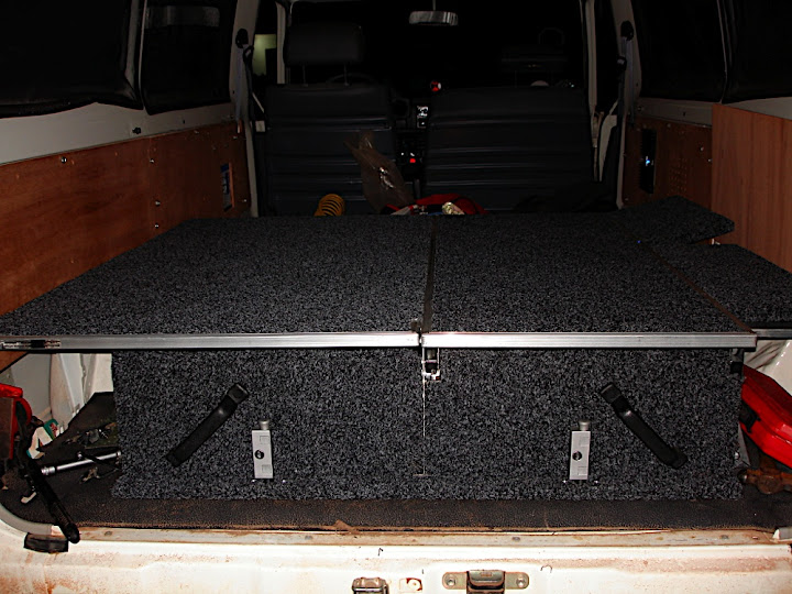

So then onto the African Outback Drawer System. Damn heavy stuff it is. The installation was fairly straightforward, although I did change the installation slightly. Instead of drilling the floor I utilised some VERY strong mounts which originally lock the side bench seats to the floor. The drawer system is not full length (originally designed for a troopy 'RV') as I wanted to maintain the possibility in future for a small second row bench seat. Immediately in front of the drawers are going to be the two batteries, and immediately in front of them is going a full height Milford cargo barrier for two good reasons:
1) You can then pack up bags etc on top of the drawers
2) I do not want a fridge behind our heads with nothing holding it down other than the usual straps or turnbuckles...
Basic drawer installation is completed, tomorrow afternoon will tackle properly bolting down the top covers etc.
The right hand cover is actually the fridge slide, also running on roller bearings like the drawers. The system is really well designed, with stoppers that stop the drawers coming out and act as anti-rattle devices when the drawers are closed. The drawers lock too.

Drawers were finished off this evening, what was quite surprising was that as I increased the size of the side panels (with my custom marine ply ) slightly it meant the drawers are quite a tight fit... Trimming back some of the edges makes it all nice and tight but still able to open the fridge slide.
Next up is mounting the fridge to the slide. To this end I have "sourced" some Toyota tie down eyes (i.e. unbolted them from the rear of the company 105). Couldn't find anything else lying around... Will lock down the fridge with some turnbuckles. Only thing is that the fridge is going to be pretty damn high of the ground - so I am thinking of some sort of folding step that goes into the receiver on the rear bumper. Wouldn't want to be sorting my cheese and beer by touch alone! After that is the wiring - that should occupy a good few hours.
Oh yeah, also got a 70 series red turbo emblem on order with my local toyo guy... That has to be done I reckon. Will get some pics up soon,

Hi Gil
Do have any rear of frontal shots of the camper fitted? I want to see how wide it is compared to the body.
An overall width and length measurement would be great

Here you go:
Width is basically 130cm and length is 215cm - these are not spot on, but quickly taken with a tape... So good enough I hope.

Quote:
Originally Posted by gilghana View Post
Here you go:
Perfect Looks like they were made for a 7* series
Thanks
