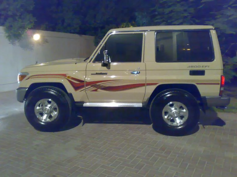

i have a Land Cruiser 4500EFI 71 and i want to add a super charge for it so if any one knows were i can find one or anyone who can advise me to add the supercharge on or not .
this is the pic

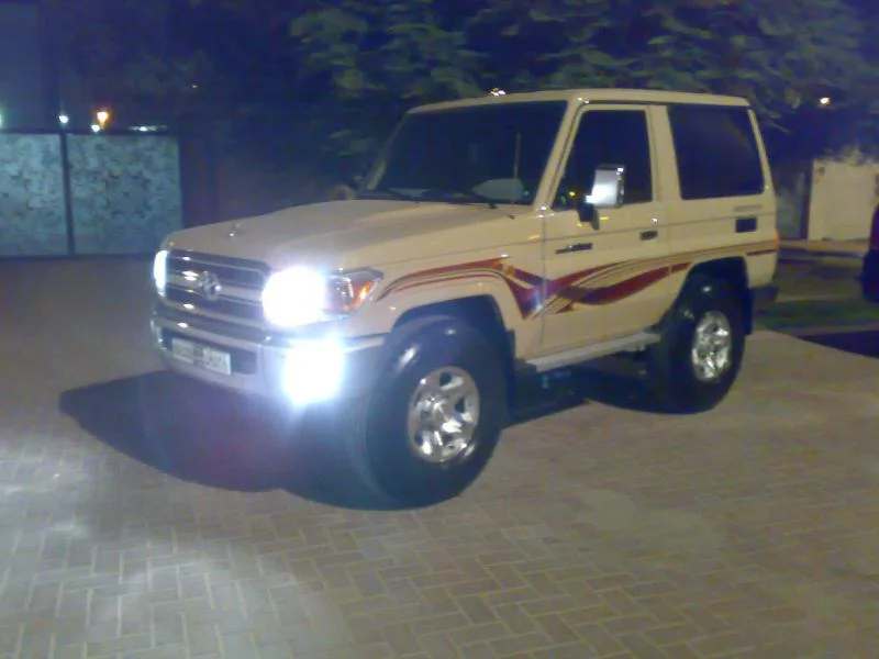

hey dubai they look like HID lights in ur truck? can you tell me what the kit is? Does your high beam light on the dash work ?
