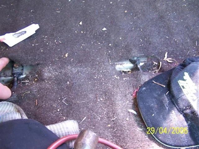

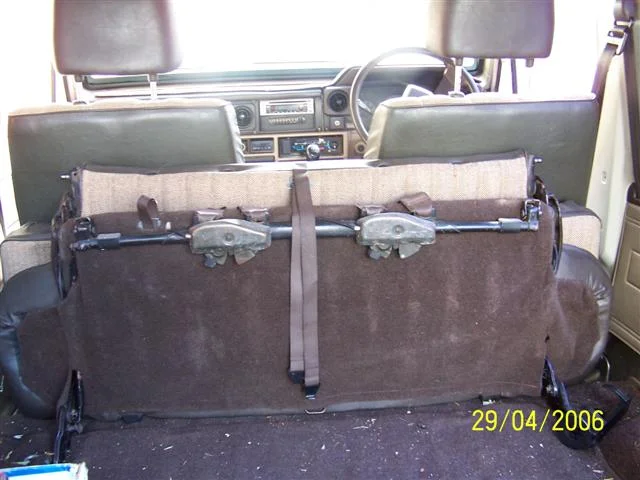

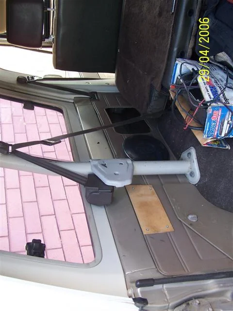

The aussie and european 73/74 series have a different rear seat with 2 x brackets that attach to the floor and they have the rollcage for attaching the inertia reel.
A pic is worth a 1000 words

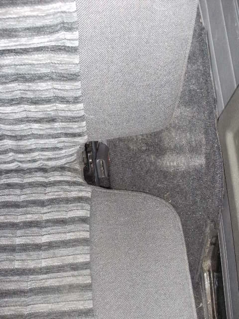

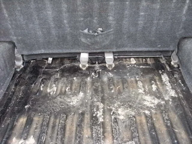

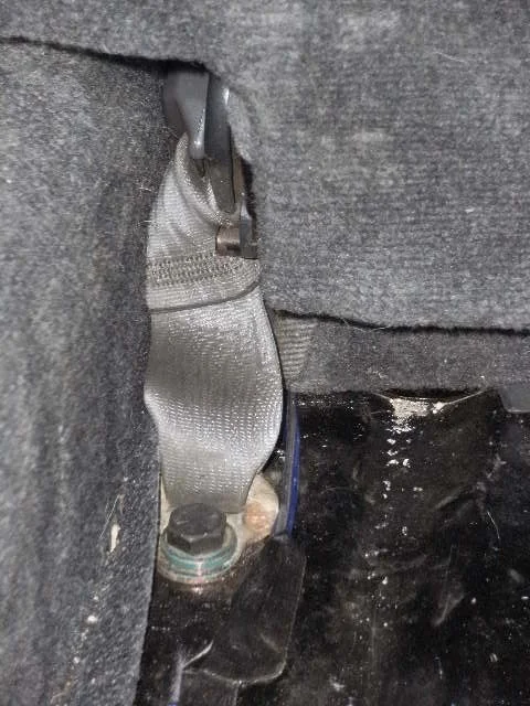

I got my seat belts installed last weekend and I thought I'd send some pics along. I picked up the belts from the wreckers for $30 for the pair. They are the centre belts from a couple of 4 runners. I mounted them though the floor and attached to the cross member with hardened bolts and large washers. I put the lap belts through the middle and the buckles on the outside. Thats the last of my projects to do before heading to the Yukon in September. Thanks for all the info guys. Your always a great help and much appreciated.
Phil
