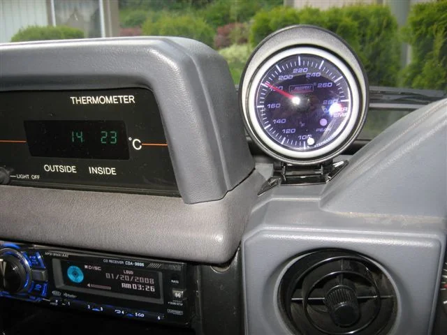

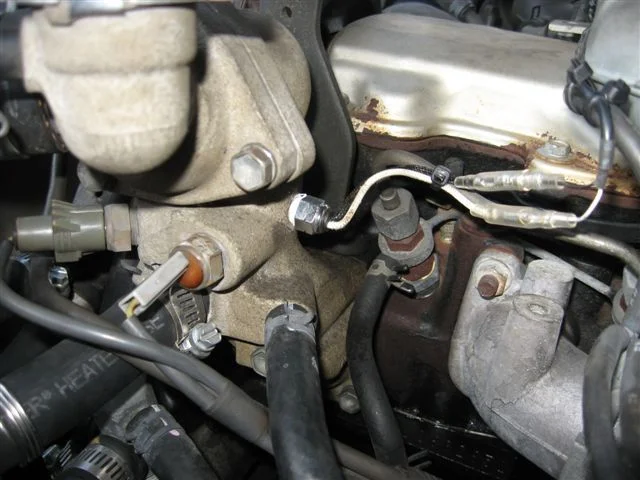

Hey guys hows it going. The best solution i think is to call up rocky mountian imports and talk to John. He found me a 180 thermostat instead of the 192 degree. They are original toyats t stats I belive from a 5L. I have been runing the 180 in my truck for the last three weeks and I love it. I have been trying to see just how hot I can get it. After 30 min of straight up hill I was at 200 max. This thermostat is not for winter only for summer. He will send it out to you in one day. With the 192 thermostat I would hit 200 in just minutes of hard up hill climbing. I have bought a Pro-sport temp gauge and have been very pleased with it. I use my shop lazer temp gauge to see how accurate it is and it is within 3 degrees F. Prosport will send it to you for 88 bucks all in.
Good luck

Sorry just a quick addition, Rocky mountian Import may have a line on a complete 2.5 exhaust system from turbo back including muffler. He had mentioned it to me for around $700.00. Don't know exact price but call him and see.

I think I will go ahead and get one of the thermostats. Also I like that style of temp gauge you have, looks to be simle and 88 is alot better than the 300 I have been seeing for the other pyro gauges I have been looking at. Will I need a water temp gauge as well or will this be sufficient? (Pardon my ignorance but the guage you are showing there is for exhaust temps yah?)
Oh, on that same note did you tap that hole, I was thinking about putting the probe in right after the turbo so I wouldnt have to drill into the manifold...)

Hey Tebo how's it going. The site for the gauges is www.prosportgauges.com. In my opinion and mine only I think all you need is a water temp gauge. It is very hard to change egt temp and water temp so why buy both gauges. One of the problems of these little engines is your always at full boost when climbing hills. Your egt's and temp go up hand in hand. This is only my thoughts.

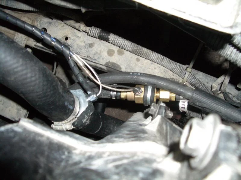

To make a easy install for the temp gauge buy the radiator hose adaptor. The best location for this hose adp is in the upper rad hose. I don't know the size of the upper rad hose but I can mic it at work and will let you know which adp size to buy. I drilled and taped my sensor before the t stat, wasen't that hard but may be it you haven't done this before.
Watch out from prosport because if you dont buy the expensive gauge the other ones don't come with the mounting pod and visor also always email them for a quote for shipping so there will be no surprises at your door.
Hope this helps.

Hey Tebo. Look on Prosports web page and click on the rad adapter. It tells you how to measure for the adapter.
I got the out side of 1.75 inches or 45mm minus the 6mm wall thickness and The 38mm should be fine. Check on yours and see if we are the same page before you order.

P.S. The futher you put your sending unit in the rad hose away from your engine the cooler your gauge will read it would be a good idea to add 3-5 degrees f to your gauge for actual engine temp or close to it.

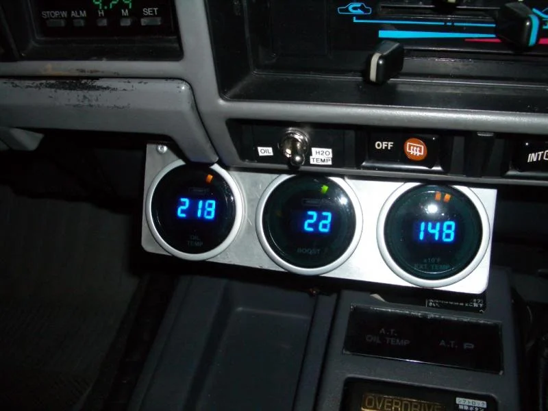

I put the pro sport guages in mine and like them. The rad hose temp gauage is looking at the cooling capacity left in the rad. I put mine in the bottom hose to see how hot the water from the rad is. If it gets hot you have no chance to cool the engine. the stock guage is looking at the engine temp inside the thermostat system. (It should always be close to your thermostat temp) My clutch fan is coming on when the temp in the rad is around 163F
Don't buy the digital guages until they get them to stop flashing at low temp as it is annoying. The quality is good and they look cool. Don't look at the numbers as they are just cycling on start up.
I have a switch to monitor both transmission temp and water temp with the one guage. It works well and only cost another $9 for the prob
The hose adaptor is 38mm
