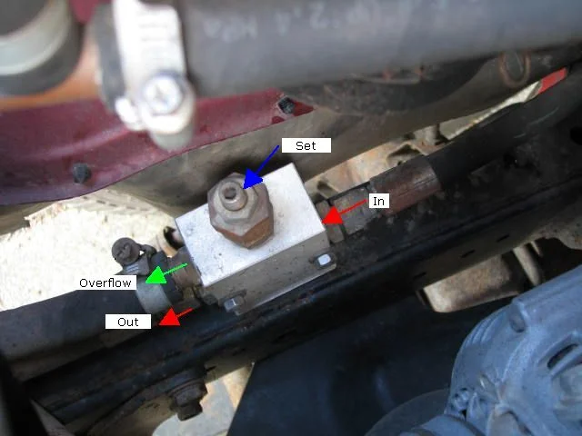

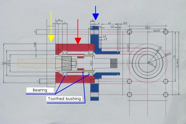

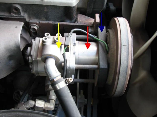

As you see I've put three photos in this message.
The drawing is about the connection between the pump and the A/C clutch. I had to keep in mind that this kind of pump does not allow a pulley to be bolted to the pumpshaft and to drive it by a belt. No radial forces are allowed. All you are allowed is to turn the shaft. Sounds a bit strange but this is because this pump has no real bearings. For me that was no real problem because I was going to use that A/C clutch that has a housing and bearings by itself.
If yo look at the drawing ( sizes are just applicable to my setup!) you can see the blue part. This is the housing for the A/C clutch and carries the forces excerted by the V belt to the crankshaft.
The Red part is a kind of 'transfer'. It is sitting inbetween the A/C housing and pump-body (the red arrow on the photo with the view on the pumpassembly)
In there are two small bearings, guiding a bushing that has teeth at the inside and can slide (don't know the english expression for it, but it's similar to the sliding part of a drive shaft). This part connects the pumpshaft to the A/C centre shaft, without transferring any radial forcesbut allowing some axial play.
At very left side (yellow, I hope it's visible) you then find the schematic of the pump shaft.
The A/C clutch is engaged by energizing it and only then the pump will run.
The hydraulic fluid then passes a pressure regulater (see picture with the squarish part) because the pump can deliver more than twice the allowed pressure. The regulator is is calibrated to the max allowable pressure.
After this the fluid gets to the valves of the winch, electrically controlled for in and out. After the winchmotor, the fluid is pressureless and enters a cooler that sits in front of the engineradiator. After the cooler it returns to the pump. In this returnline there is a T-connection that connects to a small reservoir (about the same size as the power steering reservoir)
With this setup I've been winching under fairly harsh conditions.
