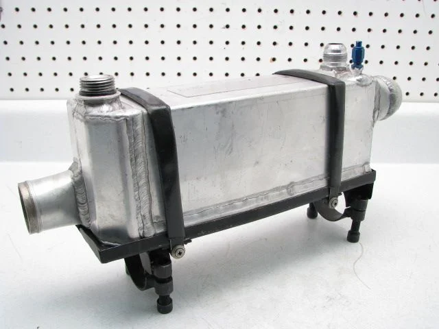

Well, I was thinking of putting a heat exchanger in from the power steering off a corvette, or a oil cooler from a nascar. Opting for the nascar one because its bigger but not sure if I got the room. It looks like there is some room between the lower rad hose and the engine along the frame rail for this. the corvette one would be no problem, just not as much heat displacement capacity. They are both about 12 inches long.

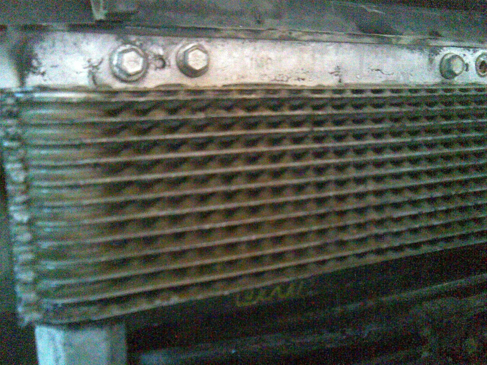

the cruiser came with this setup from Japan. The two cooler are JMO they are good in the way that they are durable no small fins to get bent, but the cooling ability is probably compromised. I was fitting one large cooler yesterday, when I went to crank one of the fittings that was leaking a bit it cracked. That cooler was all aluminum, after that I didn't want some thing that fragile on the front of my truck (oh I know everyone will love this, but it was a ford 150 tranny cooler, thats what I get for using a ford part). The correct rad would be nice, but the cost maybe really high. Perhaps fitting a custom after market rad would be cheaper and better, like be cool, or griffin. Although that wouldn't just bolt in so... I'm still thinking of the external heat exchangers.
I'm running regular ATF, I just dropped the pan and cleaned it along with the filter, and flushed the tranny. I also took the coolers and flushed them with solvent. The solvent would come out dark, almost black. I guess that was burnt fluid. Although the fluid that came from the tranny was bright red and didn't smell burnt... but then again all ATF smells funny to me
I did check out the valve body and torque converter, upgrades, they sound great, a bit pricey. There on my long wish list.
