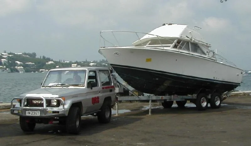

I'm not sure where I found this picture...

Posts: 9,009
i can see Ministry of transprotation Ontario having fun with that one...
i wonder when the pic of my HZJ75 towing a city bus went...(really it was just sitting in front of the bus but from the angle it looked like it was...)
Darwin award
Im wiTh the others. Its not what your vehicle can tow ,but what it will do if things get out of hand.
A 1950 landrover can pull 50 tons
