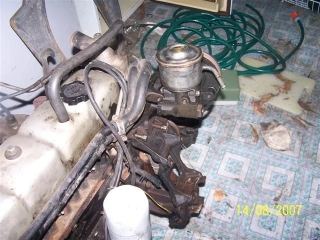

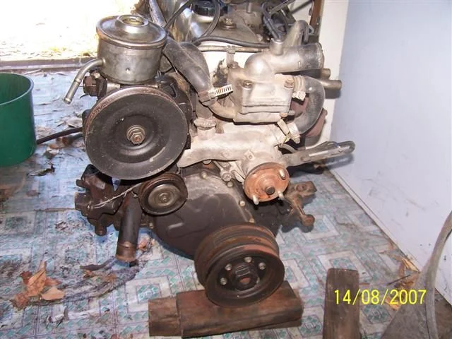

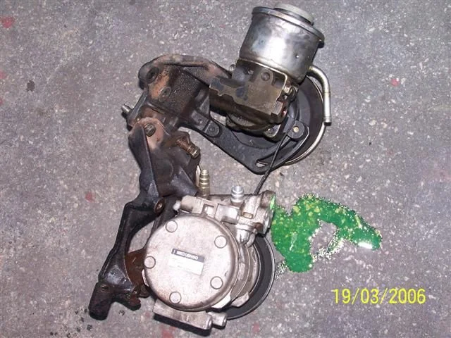

Hi Gus
All FJ7* had power steering in Australia
You can use the power steering box off any 70 seres diesel or petrol 84-200? but it is obviously RH or LH specific.
I imagine the pump would suit any 3F if it has the holes drilled on the RH side of the engine.
This is some of the parts off my old 3F showing the reservoir,pump and bracket. As you can see it also has an aircon bracket .
Its just loosely bolted up for some pics I took for someone else who had no aircon
