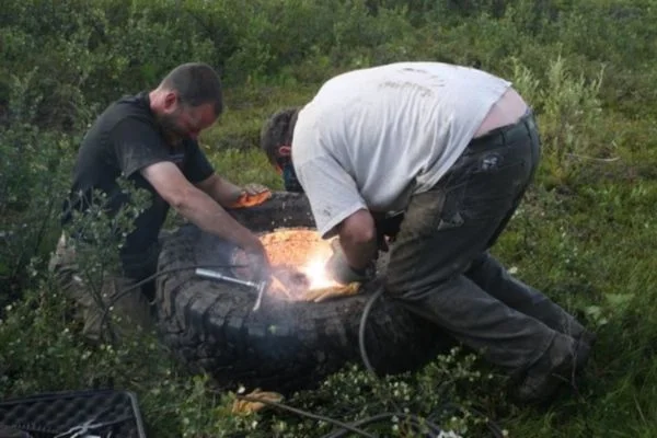

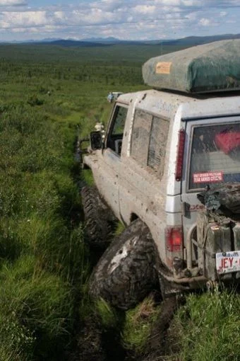

I used IFS hubs to widen the 60 series housing on the front and spacers on the 60 series housing at the back.
Spacers work great!

Let me guess.... that bright light is the reapplication of the red loctite?
~John

TLCA# 5513
Posts: 2,429
Quote:
~John
<grin>
You got it
