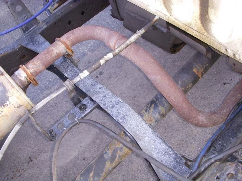

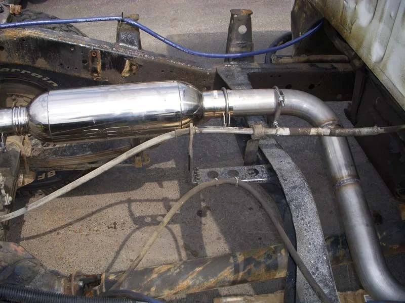

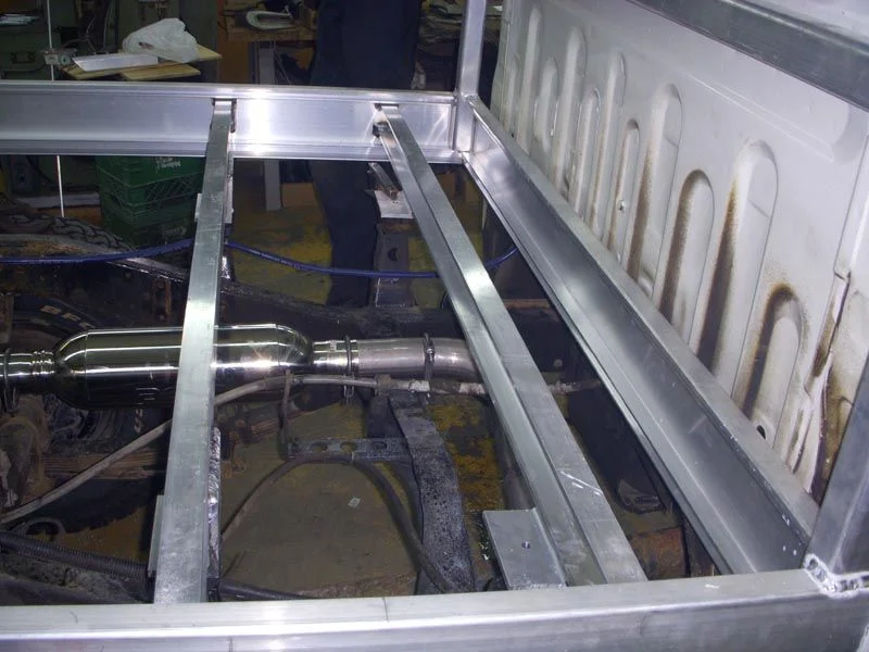

Secondly, I added a 3 inch mandrel bent stainless exhaust with aeroturbine muffler - a very nice and clean install - and sounds great - very quiet. It replaced a 2.5 inch stainless pipe with factory muffler.
There was a definate difference in power and EGT's, the truck really rocks now - egt's are very low and power is always there.
thirdly, the big nasty, heavy steel box on my truck has been driving me nuts, it is probably well over 1000 pounds and it looked like hell and affected performance. I have been trying to find a suitable replacement and knew I wanted aluminum but didn't want the usual checker plate redneck looking type. So I found a guy who happens to own an HZJ75 and an LJ78 and just happens to work at a manufacturing facility that makes flat decks for tractor trailers. All thier materials are extruded and their own patents. The facility is called Trebor Trebor Manufacturing Ltd Aluminum Truck Platforms
So I worked out a deal and got the materials needed and the guy offered to help me install it at my house. Check out the picks.

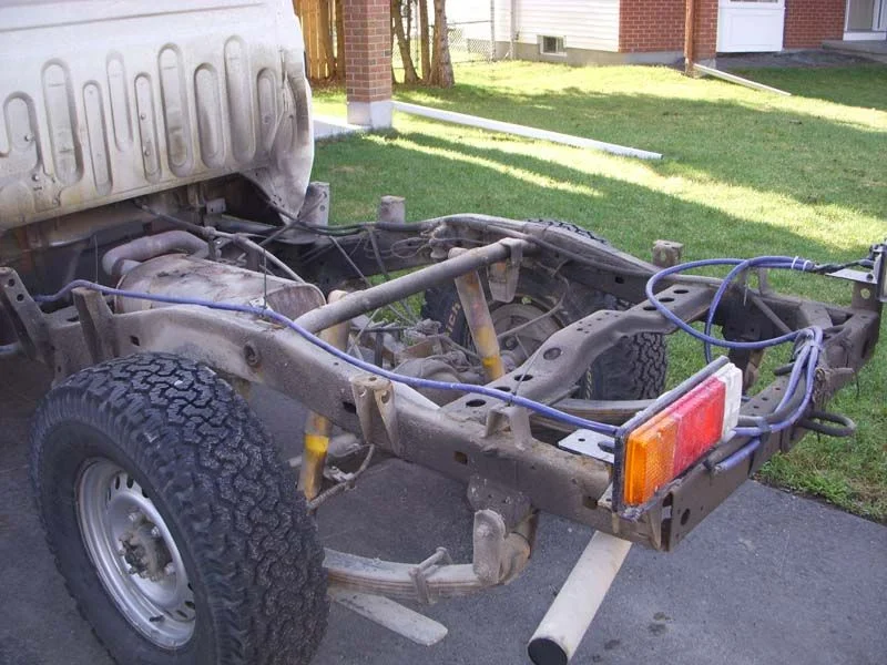

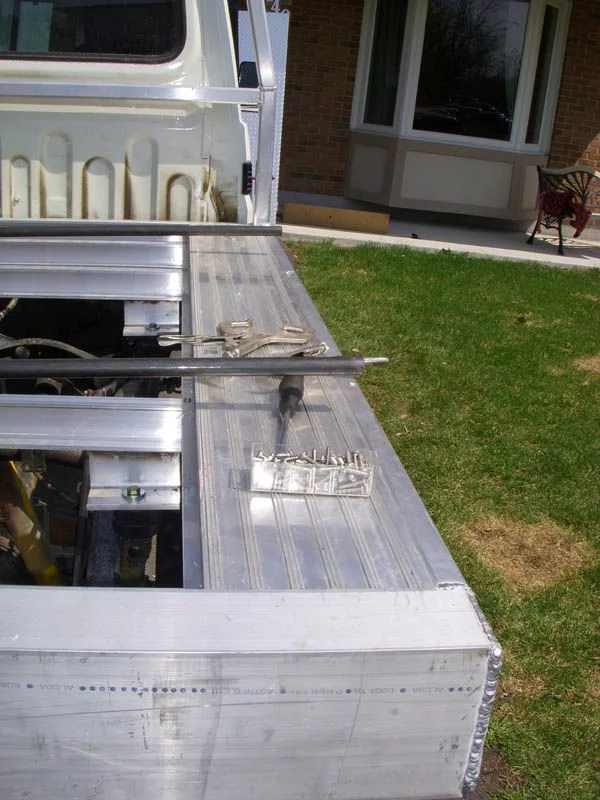

The floor gets a dry fitting and then the frame is brought to get TIG'd

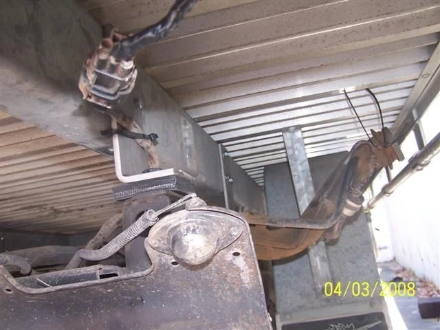

The frame is just about finished and it gets mounted to the frame. We ended up using pucks for spacers, I can adjust the height of the bed at any time.

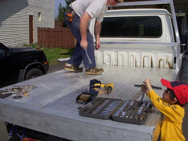

The bed is secured and the floor is installed - it is tongue and groove with stainless screws securing it.

Great looking deck, are you considering any type of sides?
You got yourself a good little helper, cruiser mechanic in training.

Ya, I'll put fold down sides and gate on it with the traditional type of bends and hinges. I'll probably also use my plasma cutter and cut off some of the side members to thin it out - I don't like the thick sides and thick reabr bumper.
As a side note I bought one of those chinese plasma cutters/TIG/Arc welders - the thing works great.
That little helper is my oldest son - he loves cruisers and goes wheeling with me all the time.

Very nice setup . The t and g is a very strong deck material. A lot lighter and the 3" with areoturbine must make that 79 MOOOVE ! Good Job.

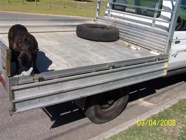

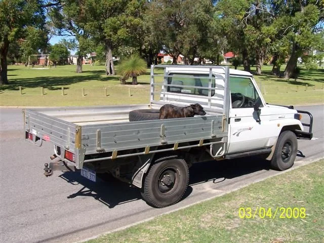

Nice job Louis I put this alloy tray on a few weeks back .Its a Unicorn brand and supposed to be good for 1500kg.
It doesnt have nearly as much support underneath as you have done but I only want it for camping and to be as light as possible.
Mine only has 2 long bearers running lengthways and connected to the frame mounts with s/s brackets sitting on some belt rubber.
My rear suspension was also raised about 2"
Maybe you could trim the sides back and add the rope tie downs like mine

I got it from Trebor here in ottawa - see my first post for a link. Not sure if they would sell to the public but you can try. PM me if you can't.

Posts: 8,015
Quote:
Originally Posted by lshobie View Post
Thanks for the pic Ross, do you have a picture of the sides and rear? I want to cut the sides and add the tie downs - looks great.
Found the battery recharger
The latches on each corner are my favourite type as they are easily unbolted and replaced if damaged.
You can also put a small padlock on them too.
They act like a rachet/wedge and become really tight as you push/hit them.The black bit is rubber
This is important on an alloy tray as the sides will rattle and drive you crazy
I plan to fill in the gates on the inside so I can use them for cooking and meal preparation
