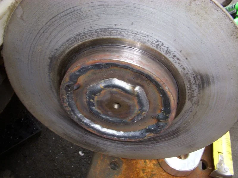

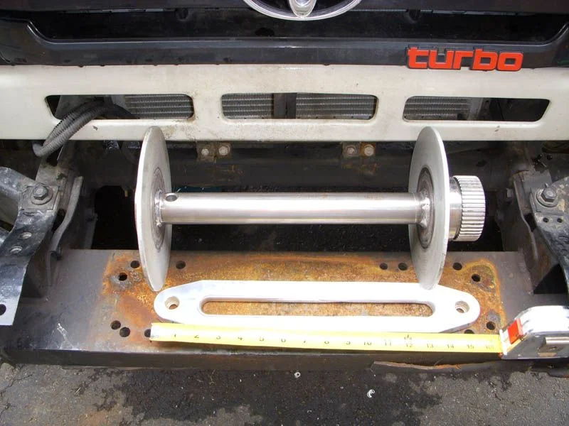

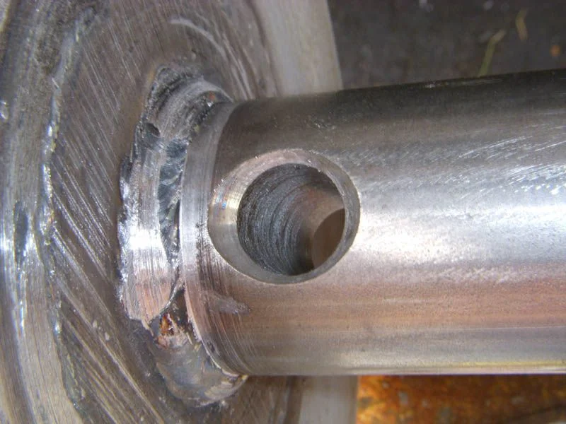

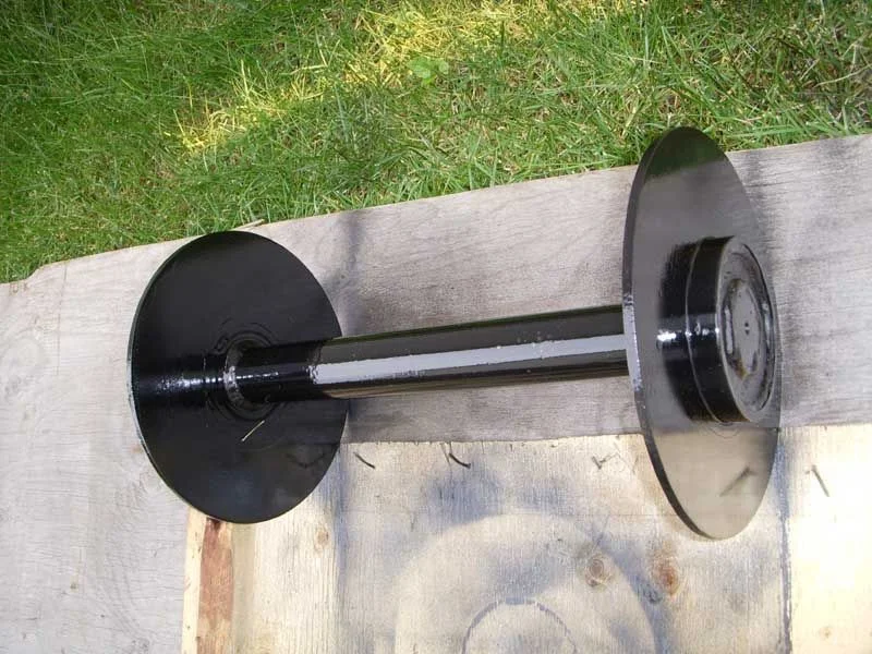

I hope he's running bigger tires though. The truck you pictured looks great - but the small tires make it look a little womanly
Getting my Warn 8274 winch drum back today, had the drum size reduced to 1.5 inches and had it lengthened 4 inches, should be pulling pretty well now.

are you running syth rope now?

Yup, masterpull.

Warn 8274 drum mods
Ok, got the drum for my 8274 back, looks great and should put very well. The drum size was reduced from 3 inches to 1.5 inches, we used 1.5 inch solid stock for the retrofit - it won't ever break. The old drum was cut out, surface was machined, jig set up and rewelded.
Over all the drum was lengthened 4 inches as well. We also added 4 inches to the masterpull fairlead.
Here are some pics.

Final pic.
Here are some pics.
Are you going to wrap wire rope or synthetic around that? It looks a little tight for wire now.
I forget the rule of thumb for drum size but I think it was around 8 times the diameter of the wire rope.
EDIT your running synth

Yup! Can't wait to try it out - have to put the drain and fill plugs in though, always something to do.
