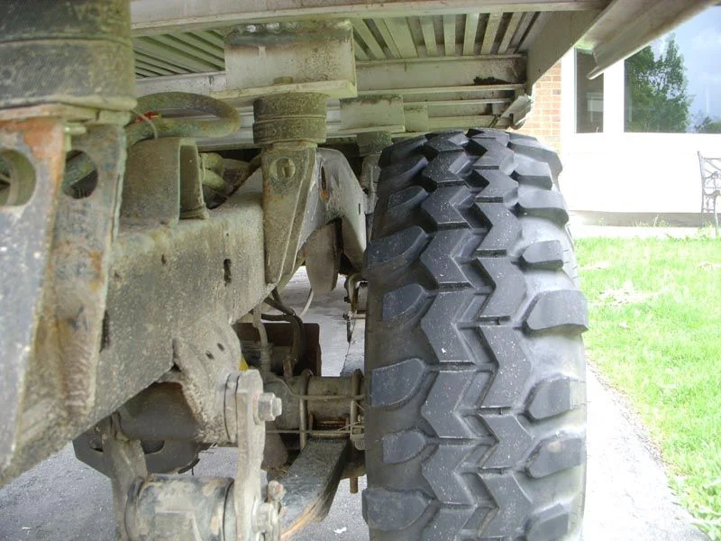

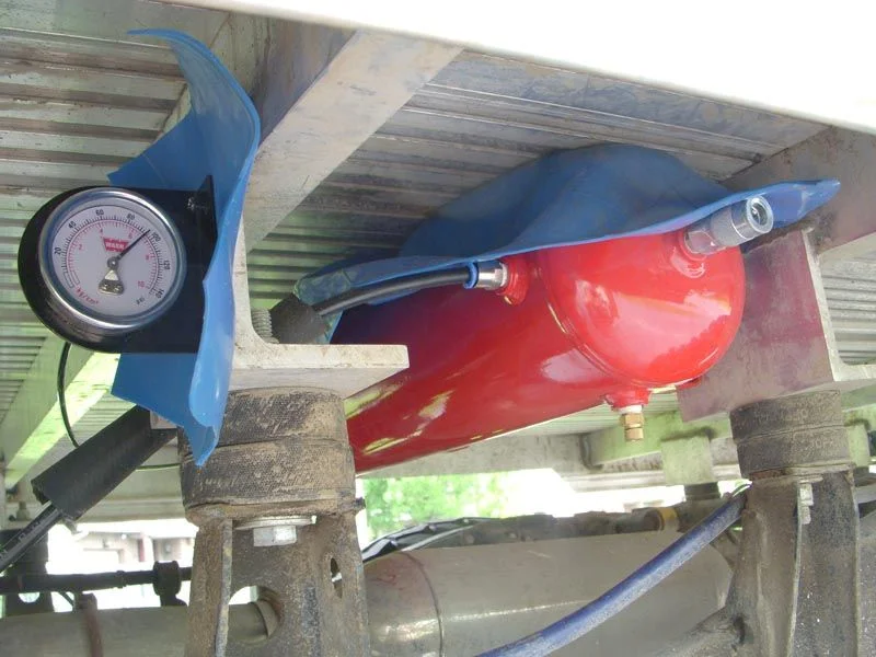

ARB compressor and on-board-air installed. Front ARB going in next week.
Rear wheel spacers added (1.5") had to trim the bed, no chance to rub now, had a longer flex line made to handle the articulation.

Enough room for flex now, the tires were too close before, and now the rears will actually follow the fronts.

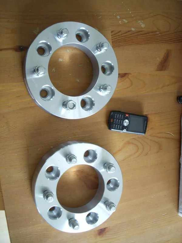

some spacers are what i need aswell, tyre scrubs up against the chassis
have you tried them out yet ?
compressor looks good too.fits perfect
