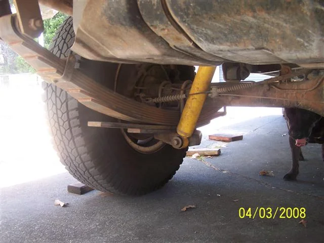

Went to see how much articulation I have - umm, pretty much none in the rear. Ever since I took the heavy box on and replaced it with the aluminum deck I have no rear suspension - a fricking kidney buster. I still have an aux tank to install and a spare tire, but that won't make of a difference.
As it stands now the driver side shackle is straight up and down, and the pass side actually points towards the diff. So, the springs are fully arc'd as they sit - can't go up any more.
So, as I see it my options are - 1. remove a few leafs, 2. remove a few leafs and spring over (I don't like spring over). 3. Throw 600 pounds of weight on it. 4. Create a 4,5 or "A" link suspension with 80 series 3" lift coils.
Any thoughts?

Quote:
Any thoughts?
Remove a leaf or get some light duty 75 series springs.
Mine is the same since the alloy tray was installed.
Good time to test out the Tough Dog
My springs are fairly new and I will leave them until I know how much my camping body will affect it

I'll take a pic of the spring pack on my truck - will take more than 1 leaf to soften it up. The 79 series springs are alot longer than the 75 series - so I'd have to mess with mounts. My big worry about removing too many leafs is spring twisting - they are pretty long and will surely twist under torque and load.
I'm leaning towards coilys.
I keep forgetting its a 79. I dont think the twisting will be a problem,others have done it. Your current springs are probably firmer than the originals,so you would only be going back to stock.
I would try it as a stop gap between the coil conversion

True, I'll just try that first and see how I like it. I want to do a coil conversion eventually - just an experiment.

Why don't you like Spring Over,
I'd take a few leafs out, and ad a trac bar with the SOA. Then add a coil spacer in the front. simple and cheap solution I would think. (springover on rear is dead simple) Then if you don't like it, you could always go to coils then and some crazy custom suspension.

That's true - good points. I'll figure it out this weekend.
Lotsa people go spring over eh - not many here doing the link suspensions, seems to be more popular over seas.

Ok here are some pics of what I am dealing with. I am pulling the packs off now and think I will remove the 2 overload flat springs, and the first leaf with the U bracket on it - I will then have a new U bracket installed by the spring shop here.
Then I'll load a couple of hundred pounds on it to mimic my aux tank and a spare tire, gear etc and then see how it is.
What do you guys think?

remove leaf 3 and 5 (from the top).
if you are never going to carry a load on the tray then get rid of the over loads BUT if you will be then leave one in...you will have to articulate quite a bit before it will come into effect...
the ride should be very smooth and then the articulation (fender rub) might come into play...

Ya, doing that now, I expect I will rub with the tires. I guess all I can do for that is spacers??

yep, spacers between the rubber bumpes and the frame...
restricts upward travel
keeps the truck low and stable..

Ok, as Greg and Wayne suggested I removed #3 and 5 springs as well as the large load spring. I left one small overload spring in and it is very nice now, sits a little lower but has more movement. I also had the U brackets reinstalled on the old 4th spring which is now the 3rd spring.
I'll drive it for a while and if I feel I need more stiffness I can always go back in and add an old leaf.
