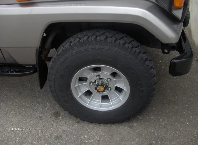

hi Louis my rims are a product about a french factory performance very good rims weight only 7kg

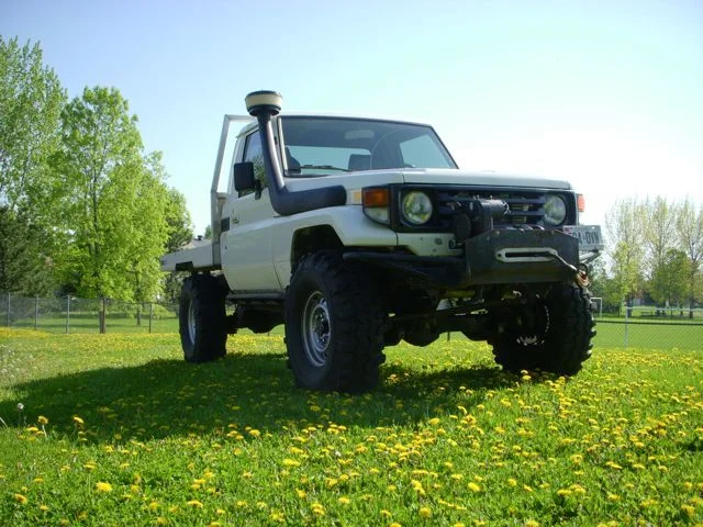

Ok, got the spacers installed and it rides nice and high now. Summer tires are back on and ready for some fun as well.
Just bought the 4x10 PWR barrel intercooler and should have it next week, just have to figure out where I will mount the intercooler rad - maybe behind the cab on the tray headboard thing as I never really carry anything in the back anyway. I don't want the rad in the engine comp or in front of the rad, and I don't want it underneath the truck anywhere as it will just get full of dirt and crap. Anyone have some suggestions?
This is where I ordered the intercooler from, cheapest place in North America that I could find:
PWR Intercoolers

Dude nice wheels and makes the rig look even better just need to add MUD haha.

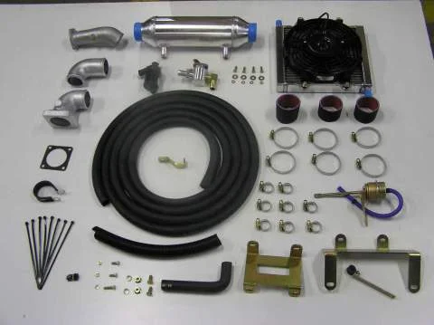

I sym,pathise with the Intercooler problem got that sunday with a radioator/intercooler full of mud after a whackign a small mudhole.
Most comp boyz here place the radiator on the rear of the pickup/wagon and electric fan it with the biggest VOLVO fans they can find. However not seen an intercooler here rear mounted as not sure of the pressure drop I imagine it would cause a lot of turbo lag. TOP mount not an option with a fan sucking air through from underneath?

Hi Cicak, maybe you misunderstood - I will be placing the radiator for the water/air intercooler behind the cab - not the intercooler. The intercooler fits nicely on top of the engine.

i just looked into the fitting of this to the HZJ40 build but i do not have the room.
the price is right though

So did you get a whole kit from those guys or just the tube and you are making your own??
Thanks,
Michael

I just got the barrel from them, the rest I will get from silicone intakes probably - unless you know of another place?
I'll custom make the connectors from the turbo and intake to the cooler. the rest is pretty standard stuff. I'll use a 12x12x2 intercooler rad and a bosch cobra pump.
