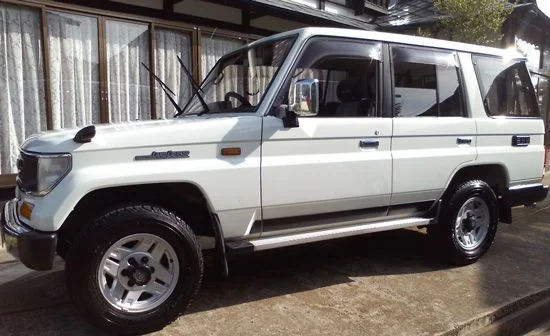

Follow up
Well, after using no less than three of the suggestions I'm happy to announce that I have successfully removed the decals! I initially couldn't find an eraser wheel (or a power drill for that matter!...Japan isn't really a DIY country yet) so I started with a very hot hair dryer. It did a decent job on one side removing the decal but not the adhesive, and did a really poor job of removing anything on the other side.
My family and I went on a trip to her grandparents farm last week and i was able to find a drill attachment that wasn't exactly an eraser but that I felt had promise and there was a drill at their place so I went that route next. After about an hour I had all of the decal off the one side as well as a good portion of the adhesive off of both sides but there was residual glue that just wouldn't succumb and by then it was black from the heat and dirt so althugh I had accomplished a lot it still looked bad. I then went at the remaining gunk with wax and WD40 (thanks for the tip...it worked the best of anything) and after about another hour and a whole lot of elbow grease I finished!
It was a lot of work but definately worth it as the vehicle looks so much cleaner now. Thanks again for all the great suggestions!
