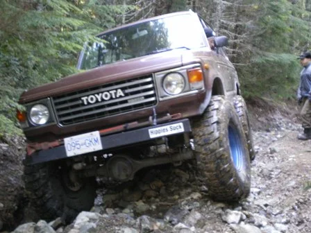

I have some 11r16 XL's and I am fairly pleased with them. Long lasting, super tough and they dig like crazy. A little slidy on off camber situations. Siping would probably be a good idea, although I haven't yet.

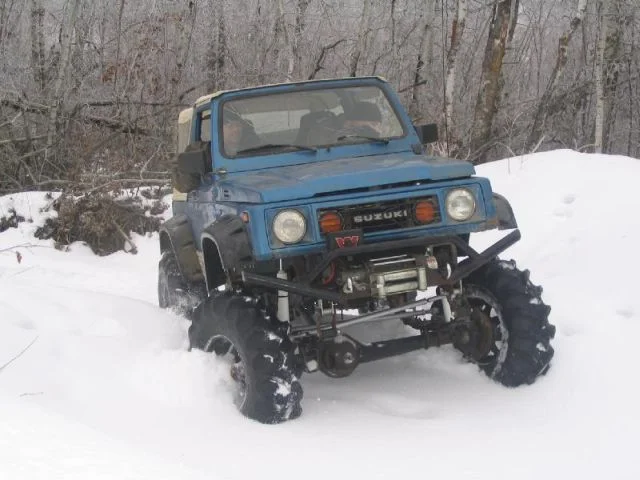

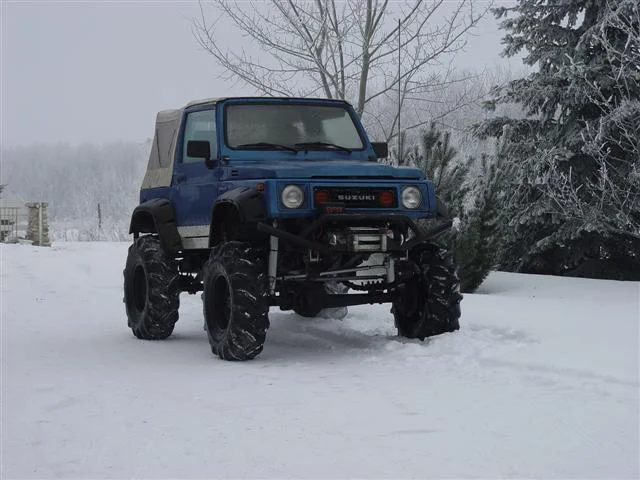

For the Goodyear/Titan AG tyres these are the first three that pop into my head:
11.2-16 Dyna Torque II - 35.5" tall
12.4-16 Sure Grip Traction - 36.9" tall
12.5L-15 SL Sure Grip Traction - 33.3" tall
Local SamToy running the 11.2-16 Dyna Torque II on 8" wheels:
