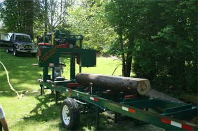

Thanks folks! PTO is up and running like a dream again!
Shes been pulling logs like theres no tomorrow!
ps: so just how violent do things get when a shear pin blows out on one of these things?

Nothing dramatic happens when you blow a shear pin (that's the whole point) The drum will stop turning & you may hear a rattle coming from behind the winch.
The worst part is having to mess around right next to a highly stressed winch rope while you install the new pin. If you've got another vehicle or a hand winch available to take the load off it's much safer.
