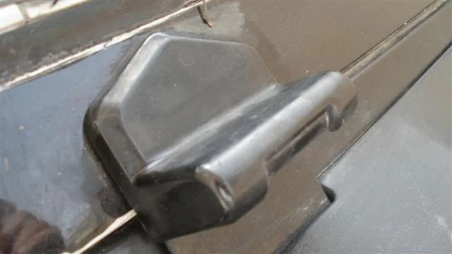

Here is some pics about my rig showing the location of bolits

Also 3 bolits in each side of the frame

Thanks for the pics Xray. I knew which bolts I had to undo (I recently tightened them, securing with a bit of locktite, because some squeeking noises (the frame rubbing against the sills?) developed. Especially some of the topbolts had to te be tightened a bit and the sound disappeared.
