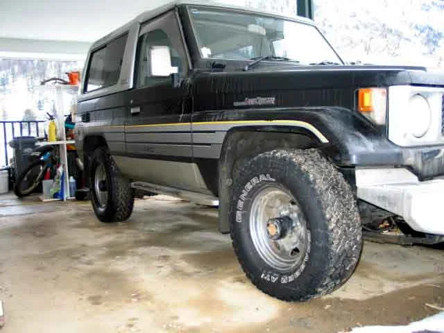

I went with mediums all around with the greasable shackles, new shocks etc. and I do have a pto winch up front. I think thats why it sags a bit up front, but like I said, once I load all my camping gear in the back it levels out nicely. It rides great too. I'm definately happy with the ome lift. It gave me 5" more clearance from the top of the tire to the wheel well. Only problem now is I need a new set of tires. The 31's look a bit small, and their not aggressive enough but the chick thinks their still good and I've spent more than enough dough already. I'm still trying to convince her that 33" bfg mud tires are needed to complete the job, but she's not buying it. Oh well, I'll just have to find a big mud hole to get stuck in and make her go out to hook uo the chain. That should work........... Ive attached a before and after pic.
Phil
