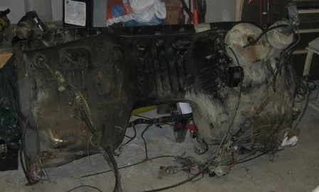

OK, I am about halfway through my BJ74 LHD conversion, so I actually have some progress to post.
To answer ALL of the first questions out of your mouths...why?
The basic answer is because I can. The more involved answer is: You know those people who say they are restoring a 1969 Malibu in their garage, and that it is their weekend project? Well I don't have a 1969 Malibu, but I do have a RHD BJ74. More importantly I also have a rusted out body from my old Canadian BJ70 (I sold the engine and the tranny to two other Mud members). I was also looking for a project to keep me busy so I could putter away in the garage.
Also, it'll be cool.
Satisfied?

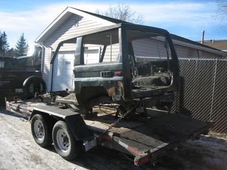

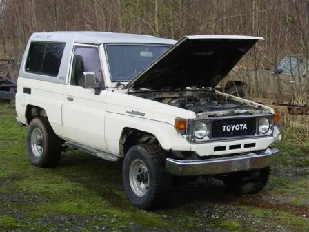

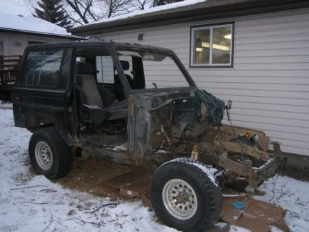

In the three pictures below is the leftover body from my BJ70, what it looked like without the firewall, and the firewall itself.

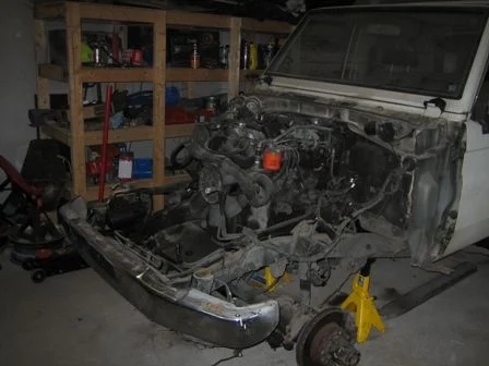

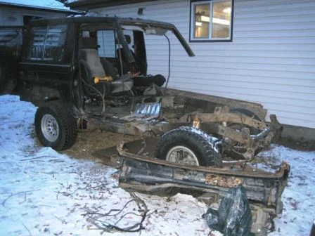

Here is the sad remains of my 70, and the BJ74 unaware of the a pain I am about to put it through.

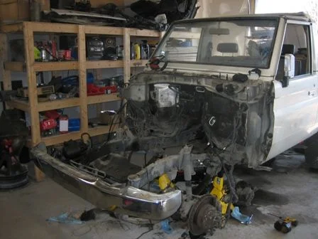

Body comes apart and engine comes out.

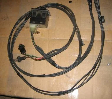

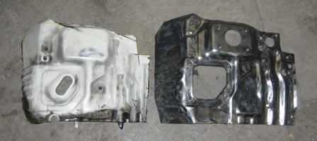

The cutout I will use for the firewall swap, and what the firewall looked like after.

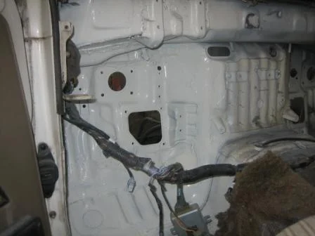

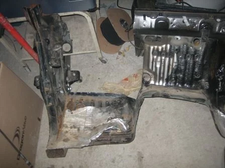

You can see from the photo that the RHD on the left and the LDH on the right (I probably should have switched that) have the same stamp (embossing?), just what is cut out is different.
The big advantage is all of the pedal mounts, steering etc are all on the soon-to-be-welded in firewall section.
Why not just drill out the spot welds? I did a few, in the end this was much faster and easier.
The second picture is the hole I cut into the (perfectly good) BJ74 firewall.

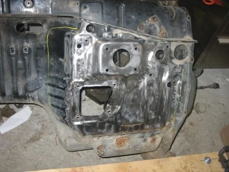

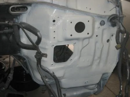

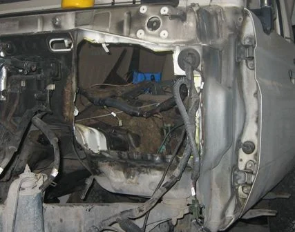

Here is the firewall section welded into place and some bondo to fill the itty bitty holes.
Craig.

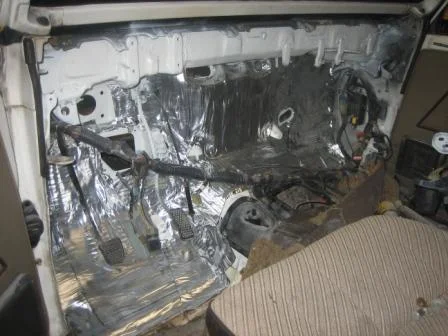

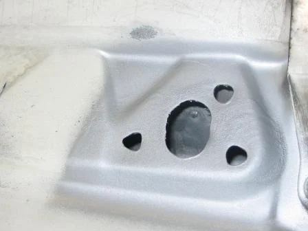

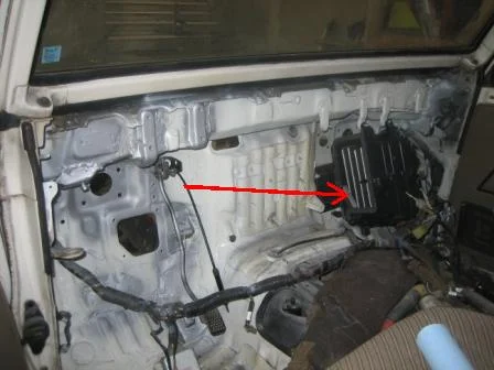

Sorry it's been so long since the last update, I've been waiting for parts, had family in town, been to Hawaii, and lately had some fabrication issues.
It seems my cut and paste is out by about 1/8", not much but enough to screw with the alignment of some things. Added to which, I lost one of the mounting plates that the clutch booster bolted to so I am making my own (picture # 1).
In picture # 2, you can see my LHD A/C evaporator ordered from Japan4x4.
I am in the reassembly phase now, just slowly.

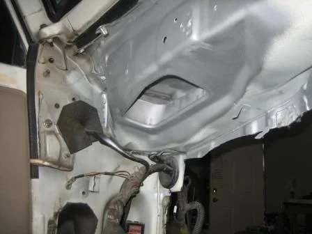

Here is the painted and shiny firewall

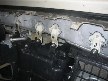

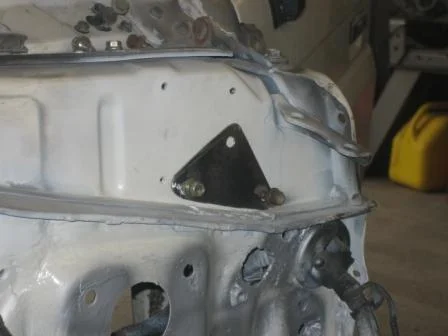

Fabbing up the heater mounts. The holes are from drilling out the spot welds.
Craig.

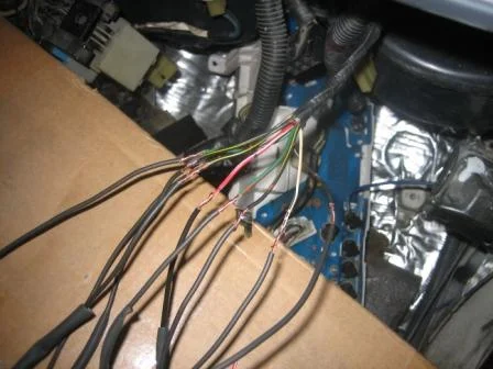

Coldtaco, the wipers and the cold air return were by far the hardest parts of the swap. I had to cut a hole where there wasn't one so the blower assembly could pull fresh air, and patch a hole where there was one so I wasn't sucking in rain or leaves, or whatever.
The wipers...I took the 24V windings and swapped it onto a LHD 12V motor, as it points the wrong way. Then I took my LHD wiper bits left over from my donor and assembled it all together, and shoved it all in the firewall. Much measuring and comparisons between the LHD and the RHD firewalls later, I marked where the posts for the wipers come out of the firewall. Then I cut the sheet metal around the triangular bolt pattern from the LHD and traced it onto the corresponding spot on the RHD. The firewalls are both embossed with the same raised area for the wipers, just get the correct one as there are two raised areas per side. I used used a die grinder to make the post hole ovular. It really sucked and I would cut and paste that whole section if I was to do it again.
The pain is over now, but those two issues really frustrated me and were a pain to deal with.

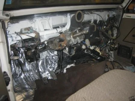

Update. A big progress day. First picture is the Brown Bread sound deadening insulation, second is all of the pedals and heater core attached.
I suppose from now on it will start to look like any old LHD truck. Not sure if you guys want to keep seeing pictures.
Thanks for the encouragement Gashog, I have been wondering that myself if I chose to sell what it might be worth.
Craig.

OK, it's been a while, but I've been busy on the truck.
Here is the electrical process which I think will be controversial but I know what I'm doing and I have strict quality controls.
To make all the RHD controls move over to the LHD side, I had to cut a bunch of the harnesses. This is what I did:
1) Cut the harness in the middle (not near either end) and strip the wires
2) One at a time, wire-by-wire match up the wires on each end
3) Wind back the stripped wires onto each other, then tug test.
4) Solder, then tug test
5) Heat shrink
6) Put new harness into wire loom
7) label each end so I can troubleshoot if I need to without pulling the dash apart.
