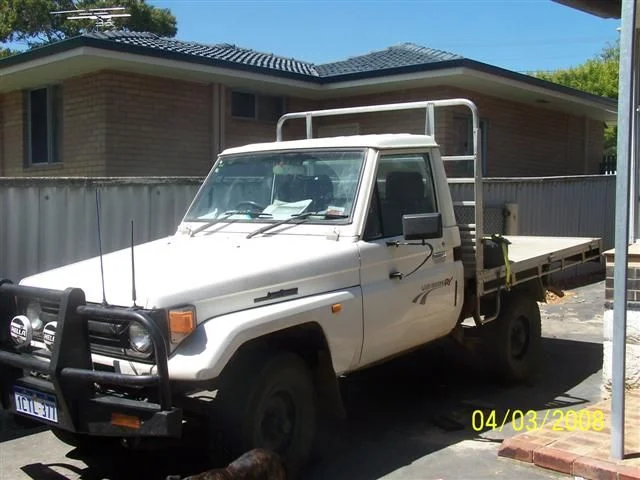

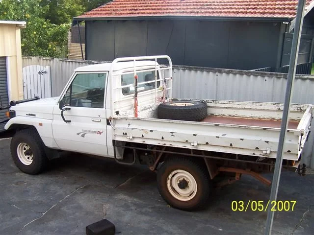

My 75 series gets a new tray:D
I got sick of carting the old HD steel tray around on the back of my 75. They re ok if want to cart excavator buckets around ,but for everyday they are just too heavy and they sucj=k fuel and slow the vehicle down.
The economy here is in a real boom and good used cruiser trays are non existant so I began to make enquiries about a new one.
So the 1st place I ring,I start telling him how its for camping and round the house duties and he says I may have a used one that would suit you.
I go down and have a look and my heart jumps a beat. Its a Unicorn tray ,medium duty and the same as the Toyota approved accessory tray.
It was on another non toyota but they are all the same for Patrol ,Landcruiser,Hilux,they just shift the mountings too suit and the protective barrier behind the cab to suit the cab height.
The protective barrier will dropped to just above cab height
It also had the canvass and the black steel frame.
The canvass is a bit faded and has a few rips but the rest is straight ,like new.
The gates are in the shed but also like new
The dealer charges $4000 for these colour coded to the new cruiser and I got it for less than a 1/3 of that
Im stuck with my old one it weighs a ton ,well about 400kgs. If I cant sell it(it is rusty and has some cracked welds) its off to the scrap metal yard next weekend.
The new tray has shaved about 200kgs off the gross vehicle mass and the engine feels like it new. I can make it up hills in 4th that required 3rd previously

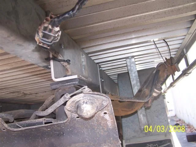

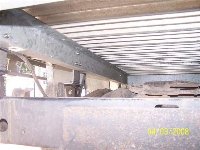

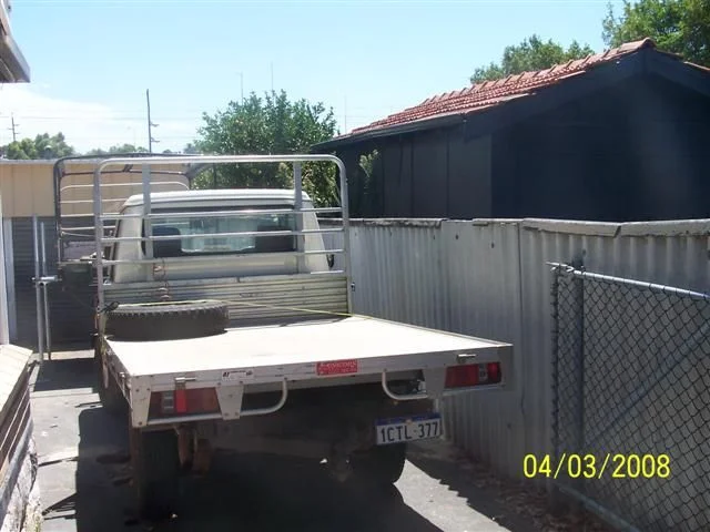

Some underneath pics. I got a small alloy and welding business to measure up and make new brackets.
They got it in place and I mounted the tail lights and mud guards.
I had planned on doing it myself but you really need an overhead crane or fork for lifting these trays.
The shop made the brackets out of stainless steel and they look good.
The main bearers look a little flimsy but Im assured that if you spread the load it will take the 1500kg load as promised by the manufacturer,not that I need to carry that .

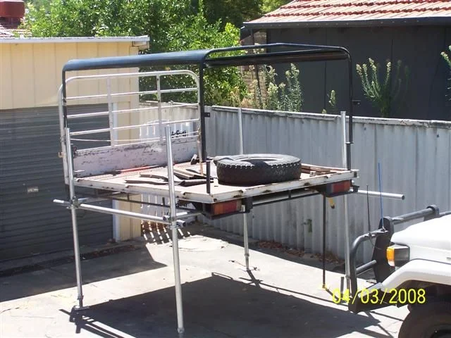

My old tray up on scaffolding that is costing $25 a week to hire The black steel frame is what came with the alloy tray but will probably go tom the scrappers too
