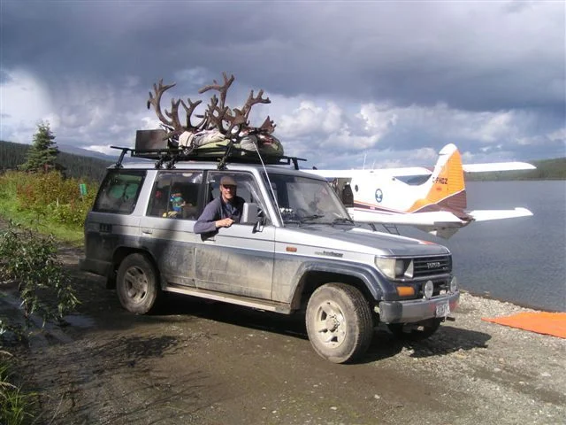

I used two sets of Thules; one I had kicking around and a second set off ebay for $100. Then I had a simple rack welded to fit; 60 inches long, using 1 inch square tubing with expanded metal bottom. total bill about $600. Check out the rack(s).

Kkriese I like the look of the prado with the 4 runner wheels on it, really fills those giant wheel wells

they are cool rims and second hand not too pricey but I had to put 1inch spacers on the front to keep from rubbing the tie rod ends. Still turned out only a little more expensive than new steel rims.
