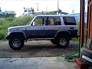

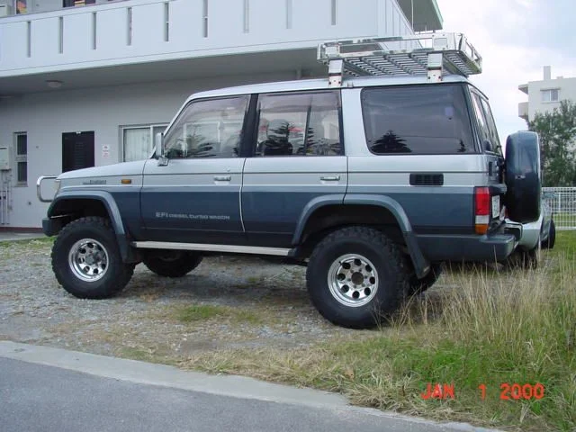

Like you originally stated you wanted a 4 in lift, go with the Zeal 4.5 it rides great and has enough clearance for 35's. Minor rubbage at full flew with 35's and no issues with 33's. Contact Japan 4X4 for prices. Don't settle for a 2.5 when your looking for a 4 in.
BJ-44 is offline   Reply With Quote
Old 08-10-07, 08:38 AM   #12 (permalink)
Forum Lifer
crushers's Avatar
Join Date: Feb 2004
Posts: 11,933
damn, that looks NICE!!
did you end up with an adjust track bar? did you drop the hangers? i am guessing the sway bar is gone...
how is the power with the big meats? i am running the 34" X 10.5 Swampers and it really doesn't feel that bad...(ain't no turbo'd PZ) and off road it does very nice.
is your auto or manual? the auto takes a lot pf power to get moving but once moving it is okay...

To BJ-44, do you still have this truck, and are you sure that your lift was a 4.5 Zeal, because I was talking to Dave at Japan 4x4 and he said there offering a 3 inch up kit.
Guess I'll inquire again

Posts: 198
I still have it it's my daily driver. The previous owner Pactoy (Randy) got the Zeal Lift used from Dave about 3+ years ago so I don't know if they still make it. It definitely isn't a 3 in lift it sits almost as high as the 74 with spring over and 35.
It needed the caster correction bushings, surprisingly with out adjustable track bars the axles are centered, Randy had the sway bars still on it with drop hangers but I removed them for more flex. It just has a little more body roll.
It lost a little power but with exhaust and the EGR blocked off it gained the power back. It will do 120 kph (3000rpms) on the expressway and maintain it as long as I don't get slowed down. It would not do so well in the North American mountains but in Japan it's fine. Offroad it has plenty of power. It is auto but the autos seem to accelerate better than the 5 speed since it keeps it in the peak torque range 2800-3200 unless you floor it. This has been my experience.
I definitely don't think they have the greatest engines but if they are taken care of they can be reliable this one has over 250,000KM on it. It has has 35 on it for over a year and had 33 on it for 2 years+
