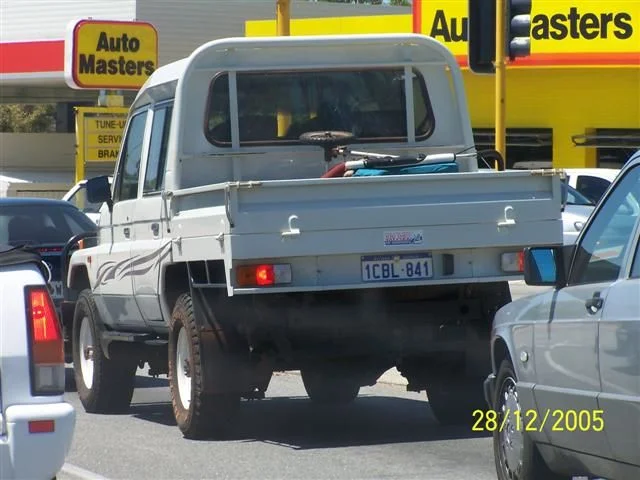

I saw this being driven by a young mum some time back,you can see the pram in the back LOL
I would also stitch up the back doors or put a flat section in there and sell the doors off.
The one in this pic has an aftermarket f/glass tropical roof for hot climes.

What was that before it was made into a Ute?. Looks pretty smart. There is an outfit in Christchurch who cut the back off VX Cruisers, mostly 80 series and makes them into a double cab ute. Seems to be popular with farmers as there does not seem to be anybody making 75s into double cabs here. Now the Hilux has gone soft there are not lot of options if you want a Toyota double cab. Personally if you do not have a deck at least 2m long it aint worth having one. I guess you can keep the dirty/smelly stuff outside if you have a deck of any size. I am sure there are owners of flatdecks (traytops) who like me would not know what to do if they did not have one. I spent 6 months with out one and it was not easy!!.
That was a 75 series cab chassis . The raised roof is an off the shelf product and a low roof is also available.
The old rear doors had crappy sliding windows but now they have windable type
There is some companies in NSW that chop troopys into a dual cab ,but I think the cab chassis looks better.
Yes the Hilux has gone soft. It use to be like a smaller brother to the 75 series but now its just like all the other sickly offerings in its class.
I think the Nissan Navara is out selling it hands down.
I think traytops are an essential part of the fight against bad backs.
Have to lift something out of a tub and over the sides makes my back ache thinking about it.
Being able to drop the sides and slide something out at hip height is much more back friendly.
This is another popular dual cab this way
