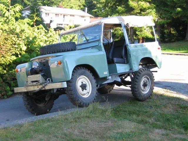

Parabolics
I may give them a shot. Before becoming a Toyota convert I used them on some series Land Rovers I built. The increase in articulation was huge despite the lousy shock mount location that Rover designed. The shocks would bind against the frame when the springs really articulated. My 80 has great articulation but my 70 with a Belton lift doesn't articulate to my liking. Here is a shot of my old rover with parabolics. They flexed like crazy and I never had an issue with them. I'm looking into revolver shackles as well.
