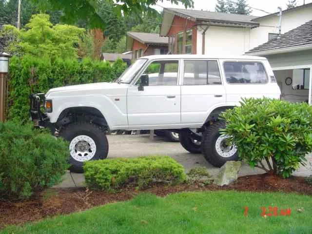

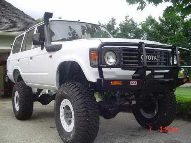

3" wheel spacers .. are not much . ?

you cant get more that 3" commercially, you could make bigger but why? after putting 37x15x15 tyres on 15x10 with 3" offset rims and 3" spacers, you have over 12 inches of more width right there

if your only going to run 37s why bother with the 3" body?
7" soa + 3" springs + 3" body + 2" shackles + 2" hangers + 2" shackle reversal
thats ~19" of lift, you could clear 44s and still have full articulation with no scrubbing!!!

37"s and a spring over OME set up. No body lift necessary. 1.5" wheel spacers per side.

kon uve got it all ass about,
6-7" on SOA,
2-3" on shackles 7" when open LOL
2" lifted springs
Not having extended hangers anymore
And shackle reversal gives no extra lift as i believe
Ill do this first, then see if i need body lift, the body lift is mainly to have chassis as low as possible, and to have plenty room to access chassis for sliders and cage.
