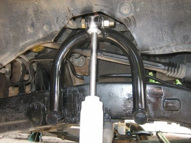

You're right. The stock shock towers have to go. They are crappy anyway, I busted them off my BJ70. I'll make some hoops out of 1.5" tube. The axle is going forward about 2"
Here's the hoops.

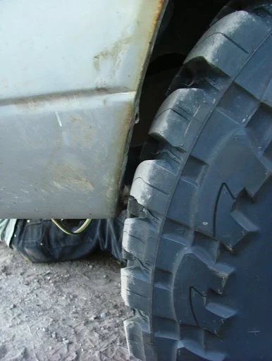

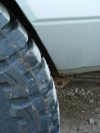

Well, surprisingly no rub on the lips of the wheel wells. A bit on the inside of the tubs and, as expected at the front of then fender on the inside. Mr Toyoda planned 70s perfectly to accept 17" tire and not a 1/4 inch more without trimming.

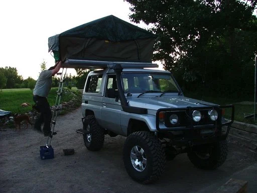

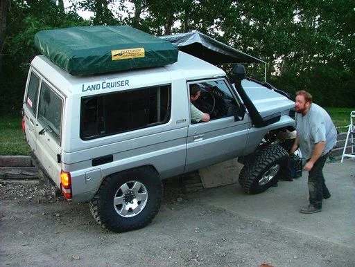

Big projects for tomorrow are the rear shocks and exhaust. I drove it home tonight and it held highway speed fine but the egts are up about 100 F.
