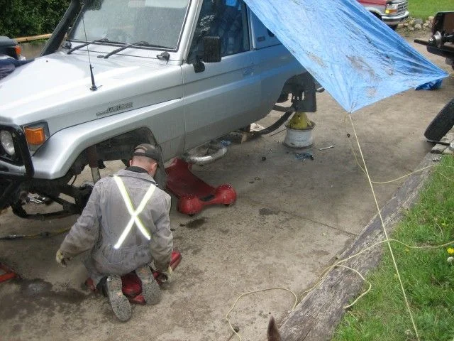

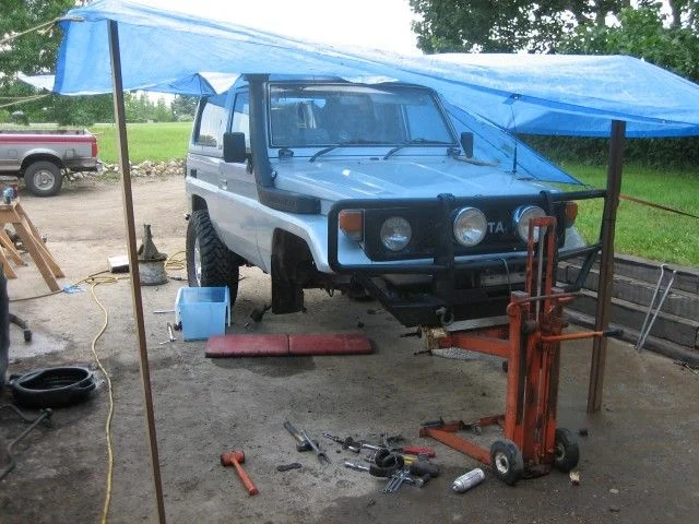

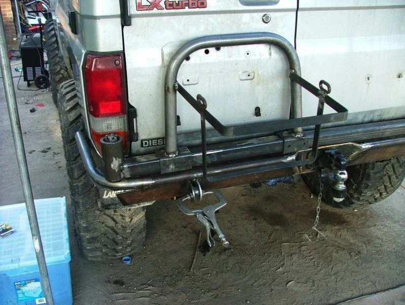

I got a bunch of help yesterday and we were able to get the axles in. I've been looking forward to this part for quite a while now and I'm really glad to have that heavy work done.

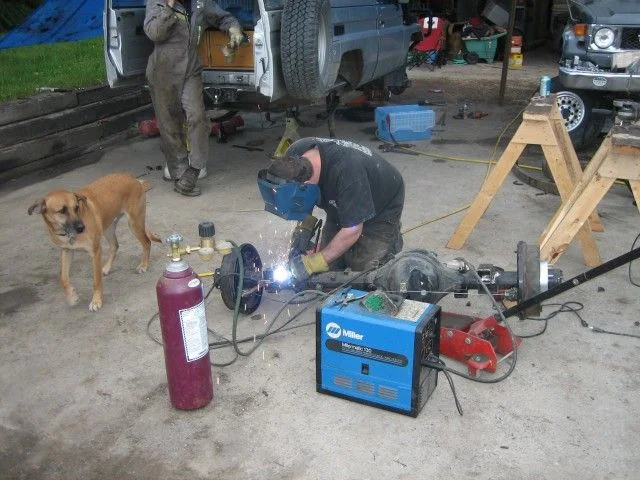

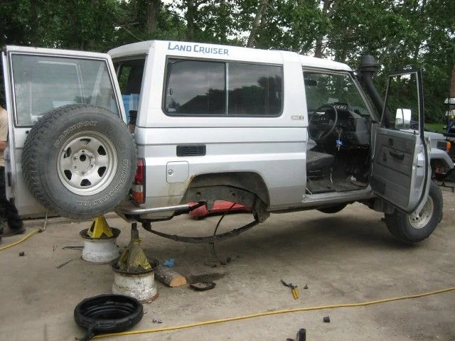

You know you have good friends when they'll help you spring over your truck in the rain.

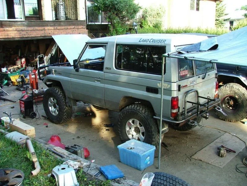

Wow, looks great! How about a shot from the side?
Your doggie needs a pair of welding goggles.

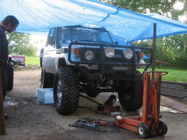

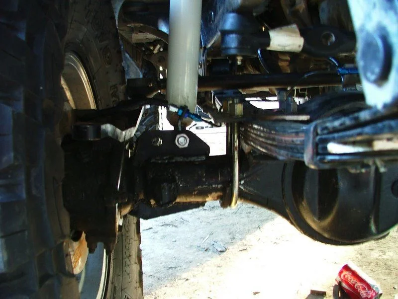

From the last photo it looks nice and low. Did you de-arch the front springs at all?

It's still under tent city while I finish the rollcage so the poser shots will have to wait until next weekend. Between then and now I have address the following...
Shocks, (Peter and Marc made the hoops already)
Brakelines
Connect parking brake
Have drive shafts lengthened
Modify crossmember
Tap the DOM for the tierod and draglink
Retaper the pitman arm
Reconnect fuel lines (relocated to facilitate hydraulic tank install)
That'll get it moving.

Yeah, it was storming out and he's got a policy to be within a meter of me when its lightning. I guess he figures I'll get struck first because I'm taller.

The weekend went really well. The list is now whittled down to the items in red. The big items are rear brakes and shock mounts. Also, missing from the list is exhaust. I'll take drop it at the exhaust shop tomorrow for a nice straight piece of 2.5"
THE BIG LIST
item project status
Brakes
front
10mmto-3 adapter done
flex -3 90 degree at caliper done
new hard-line, flex to 't' done
Flex from 't' to -3 to 10mm adapter at frame done
rear
new hard-line, wheels to 't'
new flex line to frame
parking
merge factory 60 and 70 series parking brake hardware
Steering
Arms
Drill and ream PS knuckle arm for TRE done
Drill and ream Pitman arm for TRE done
Rods
shorten draglink ~1" on the Left hand thread end save scrap, tap deeper done
Weld threaded scrap to tie rod to hold tap straight done
weld 7/8" nut to other end to hold tap straight done
Cut off scrap and nut when finished and install done
Steering Stabilizer
Install
Front bumper
Mounts
Drill mounts and frame for bolts done
Bolt together done
Accessories
Weld wheel studs to bulbar to mount high lift night go on tire carrier
Weld tab for CB antenna no CB for AK, ham only
Rear bumper
Mounts
Run 1/4 plate though bumper form frame done
weld additional plate beside for d ring mounts done
Tire carrier
weld spindle to bumper done
build carrier using 2x2 tubing done
Fuel can carrier
build carrier using 2x2 tube and flat bar done
Tent
Cage
RE fish mouth halo done
weld halo to legs done
weld 1/4" tabs for tent mount needs welding
reinstall roof need bolts
hole saw roof for sleeves done
bolt tent to cage via sleeves tighten once welded
Winch
Hydraulics
rinse hydraulic tank with varsol done
install tank done
tighten PTO pump and mounts done
install hoses done
install PTO done
Build PTO driveshaft done
winch line
remove fairlead from Shaker and install
spice hook into end of line.
Rear suspension
Leafs
Remove pack and re-drill if required for 7/16 center pins not req.
Add Belton leaf to pack not req.
Shocks
Build top and bottom mounts
Install shocks
Driveshafts
T-case
Replace front output flange with old style done
install DC front shaft done
Install modified cross member done
Install rear shaft (measure for new shaft if too short) done
Oil T-case done
tranny Change all oils done
front diff done
rear diff done
Air compressor
Compressor
install in fender well
tank
install under truck done
Connect hoses and wires

Behemoth60's yard looks like a bomb went off!
