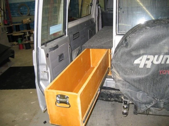

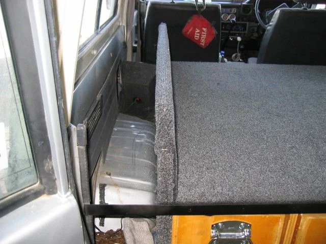

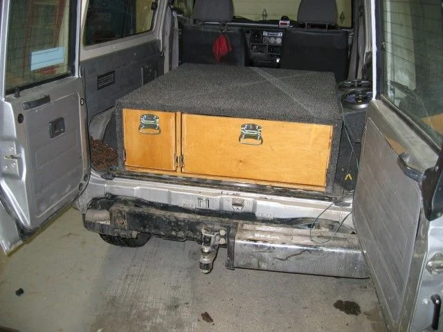

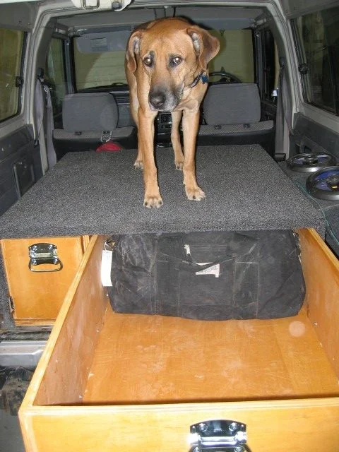

The drawers are finally in the truck! I still need to make the filler wings for the sides and move the speakers to the front. The are actually a tiny bit wide. I jumped on them and got them to within 1/2" of the floor but no closer. I'll have to pull the carpet off the wheelwels I guess.

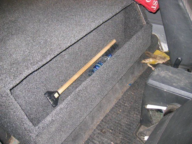

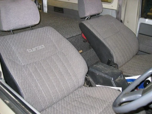

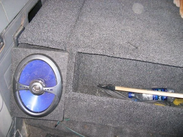

I took Greg's advice and made a cubby at the front to hold road trip stuff. There is plenty of room for the seats as well. I'll likley be moving them back a couple of inches. I'm glad that they still recline some.

TLCA# 12070

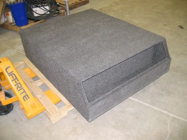

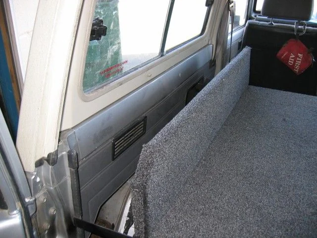

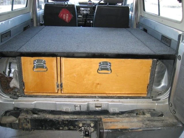

The side panel constuction starts tonight. They will flip open for access to the wheelwell space. Hopefully there will be room for a yellow top optima and an air top webasto down there.
Here is the elevation from the rear.

Ah, that's cool. Looks great. I'll start making a list of gear and try to figure out where to put what. Did you say the fluids will go into the LHSide drawer?

Awesome. Looks nice Bruce. I really like the single pull-out drawer. How do the drawers latch closed?

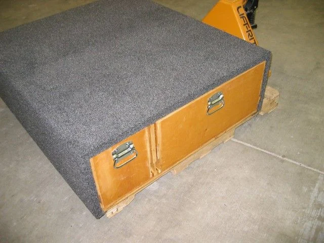

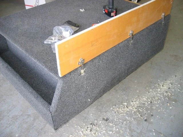

I have some locking paddle latches that I'll add eventually. I'm considering this project done for now. The truck doors keep the drawers closed.
I added the wings today. It went pretty well. Its the first time Ive used European hinges. They are quite simple. I also added a piece of angle iron across the back. I'll connect it to the body and add one to the front when the roof is off for the rollcage. I'll build a headache rack into it then as well. The speakers just happened to fill the holes at the front so I screwed them in place. Works Ok I think.

I found the pins I use to keep the drawer open when accessing stuff invaluable. When you need parts/tools supplies, more times then not the truck is tilted to the front or back. The drawer can double as a work/cook area so pinning mades life simpler at camp too.
I need to add the same latch to mine.
L brackets are likely a good idea. Some of my tie downs are in that area, so solid top was the order of the day. That space ended up being stuffing storage for me.
How are you going to tie down? The tie downs I routered into the top held up very well, and the load was very secure when loaded/strapped.
Where did you get the indoor/outdoor carpet? I've a few final details to finish on mine, and that is one of them. The marine enamel paint is wearing off on the top where the boxes rest.

Looks great, I really like the small drawer accessible through the small door!
I'm with Greg, some little pin that keeps them shut, even as a temporary measure, is a good thing. My drawer is always coming open when I don't want it to. I should really do something about that...someday.
Ditto on the tie downs too, really handy.

I think I am in agreement on the pins. Where do you suggest I put them? It seems like a long reach to the box when the drawers are out. Hold downs are coming, probably some kind of a rail but I'm waiting to see how the cage looks to see if they can be integrated to it.
The marine carpet is Home Depot. $.99/ft and it is similar in colour to the factory carpet. It has a smoothish back that reacts well to 3M spray glue.

I used patio door security pins. Not the greatest solution, but it worked. The pins are on each side, just below the top shelf level. I needed two pins as mine is a single drawer. Holes are in three spots on the drawer: closed, middle, fully open. It can be a stretch to put the pins in. Because I have not finished it with a proper latch to hold the drawer closed, the pins were filling that function. Not a good solution, as a little movement between the drawer and the frame = a lot of wear. It does work well at camp or when accessing parts on the trail. Because you have two drawers you may have to look at pins from the top, and a safe place to keep the pins when not in use. Make sure you use a small metal plate on all side of the wood that the pin will drop through. Keeps the hole in the wood from getting larger.
Or, come up with another way to hold the drawer in postion when open. I needed a quick fix to get ready for a trip, and have never revisted the issue since this "temp" solution.

Taking orders for Brimmer's 2010 Land Cruiser Calendar. PM if you want me to ship you one.

I really Like the rear cargo trays Bruce! I've been planning something similar. My issue is what to do with the fridge. Once it's on top of the deck it more difficult to get into the fridge. I'm undecided as to forgo the larger dwawer and sink in the fridge and make another lift cubbie.
Are you planning a fridge?

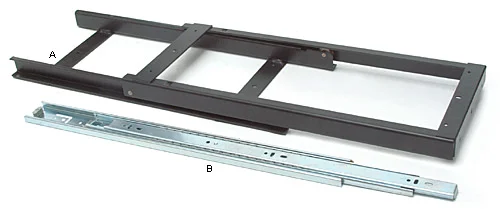

Yeah, my freezer/fridge is a 40 qt one that isn't terribly tall. I'm going to mount it on a slide that I found at Lee valley. It needs a bit of modification but I think it'll work. I should be able to pull it all the way out and then lift it off onto a picnic table for example.

Hey Bruce, nice drawer system!
Perfect size and shape IMOP One thing I noticed is the grab handles you used to open I think will rattle quite a bit. Not a biggie..... But they might dance a little when your on gravel...
Yes I'm a noise freak
I like that carpet you used too. Matches the truck nicely.
Thanks BB
The handles are a temporary thing since I have some locking paddle latches to install (for when there's guns in there) and I'm going to replace the rattles with those fold down steps they use on school bus cowls. They will make good handles but also steps for when I'm packing up the roof tent.
I agree that the carpet is very similar to stock and works just perfect IMO

Oh ya, good for guns for sure. That Skinny side would be great for that. Nice and hidden. Out of sight out of mind.
In fact looking in the windows it will just look like the floor. No one will suspect the box has contents.

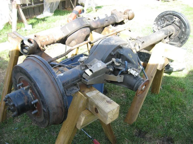

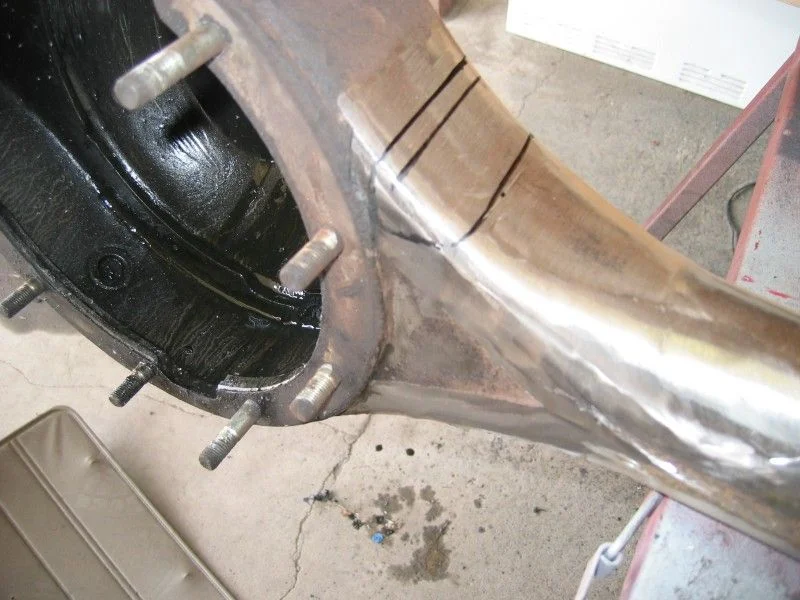

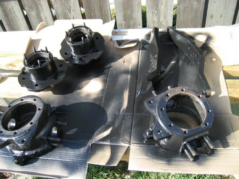

I guess its tnme for an update. I've been working on a lot of stuff but haven't really finished anything in the last few weeks. Today, however, I did manage to drag the bumper off the parts rig (that's now sold) and move it to my truck. I also swapped the chrome mirrors for some nice new black ones. I painted the grill black as well. I think the truck looks much better now.
I have been working on the axles. I stripped the front and painted some of the parts. I hope to have the perches gussets and shock mounts on tomorrow. and then I'll reassemble them. I have all new bearings, seals rotors calipers etc.
Anyway heres' a few pictures.

Bruce, where did you get the histeer arms?

I picked those arms up from Luke Porter of 4x4labs few years ago when I was in Cali.

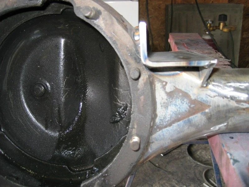

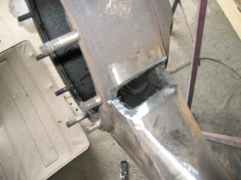

I did a bit of measuring and realized that I can do this springover on 60 series axles without outboarding the springs. Since time is tight, just fabbing mounts on the housings and dropping them on the bottom of the leafs is preferable in spite of my previous pontification about four links and airbags. That'll have to be a project for another year.
I was able to hack a chunk out of the housing and insert a piece of angle which will form the spring perch.
