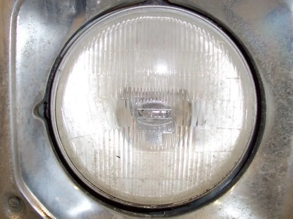

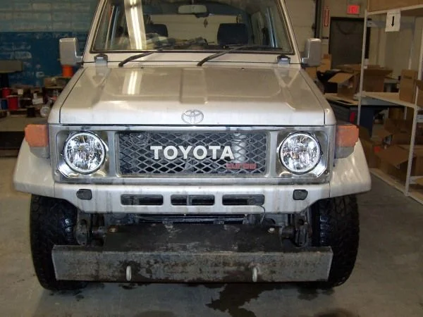

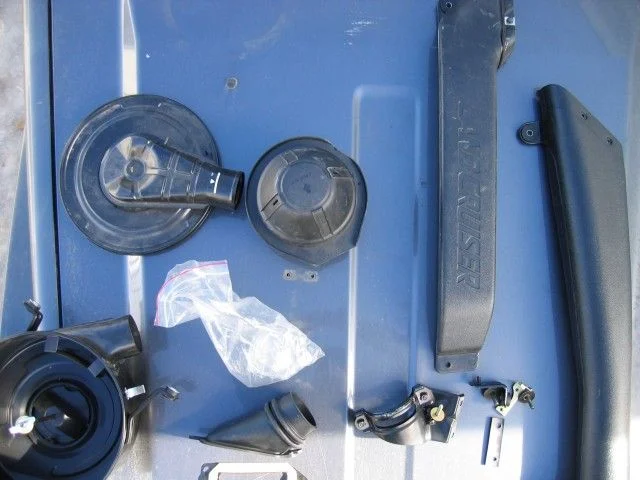

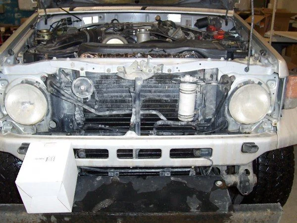

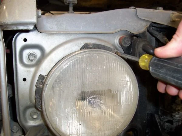

Starting with the hight tech stuff.
Actually one of my pet peeves is new RHD owners who don't swap out their left facing headlights for DOT approved ones so I decided I'd fix this rig up before I head out for a 2000km round trip this weekend.
H4 housings by Trucklight, available nearly round the clock at your friendly neighborhood Freightliner dealer for less than $30 each cdn.
The original ones look to be factory, made by Koito. They were fused pretty good to the ss rings from all the headlight washer juice.

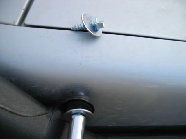

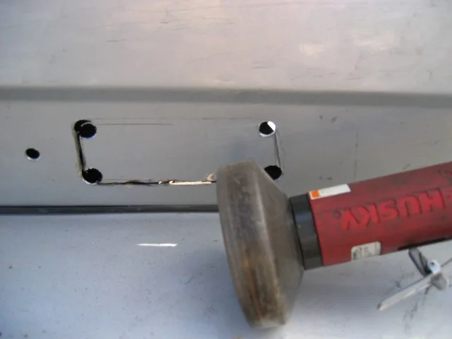

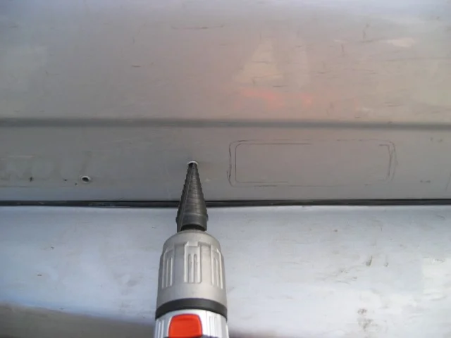

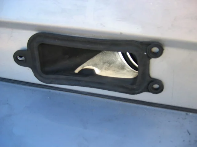

It is tech, and people were concerned about pictures so I even took one of where the screwdriver goes when swapping the housings.
I also, fixed up the guage lights, cig lighter, and some stereo wiring. Should be a good road trip.
could you please post which direction the screwdriver turns, and torque settings ?

<grin> I can tell you which way one didn't turn at about as many inch/pounds as you can get out of a screw driver.

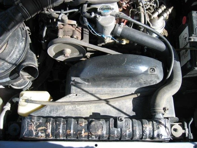

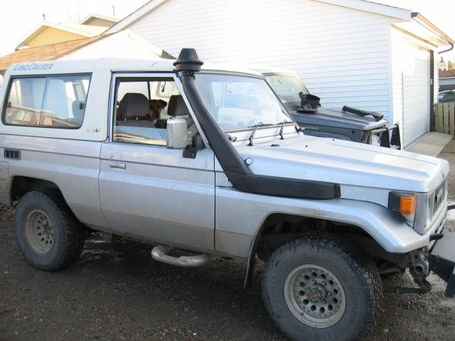

Today I installed the factory snorkel I got from tlcruiserman
It is basically a bolt up affair with the exception of a half dozen bolt holes in the fender and the one big square one. Its really nice that the kit comes with a new airbox. Took a couple of hours but the majority if that was cutting the hole using a air cutoff wheel and a tiny compressor.

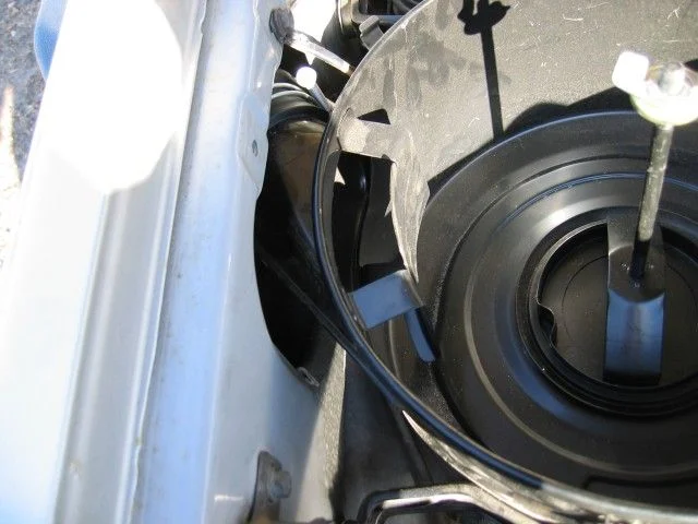

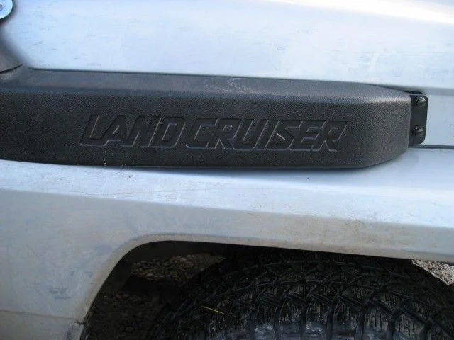

I'm not sure if Toyota planned it that way or not but the forward hole for the emblem seems to be in the right location for the rear hole of the EPDM through fender fitting.

I didn't like the odds of getting a nut on the back of the bolts that hold the snorkel to the back of the fender. I'll go shopping for some nutserts for them but for now I found some big sheet metal screws. Essensially just lag bolts. They seem to be holding quite well and this temporary fix may become permanent.

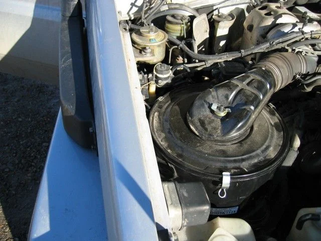

It looks a bit ghey on such a tiny truck but that's one project that I can check off my do list. I do love that Toyota molded the Land Cruiser emblem into the snorkel.
I'm trying to remember where I nutserted and where I did not...but it seems so long ago, and the pinapple express is in town tonight. Wayyy to wet to go out and look. I think it was mostly nutserts though, even on the windshield frame.
Do not affix the hat too tight. Instead, simply make it snug so I will not come off easy, but will come off. Get some picture wire and wire crimps, drill a hole through the metal of the clamp on the main body, and one though the flat section at the rear on the cap, then wire them together. Your cap can then come off when you go through thick brush. You will not break the neck of the cap, nor lose the cap. Ask me how I know...
gb

... Get some picture wire and wire crimps, drill a hole through the metal of the clamp on the main body, and one though the flat section at the rear on the cap, then wire them together. Your cap can then come off when you go through thick brush. You will not break the neck of the cap, nor lose the cap. Ask me how I know...
gb
Ah, good idea. I'll do that.
