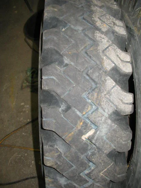

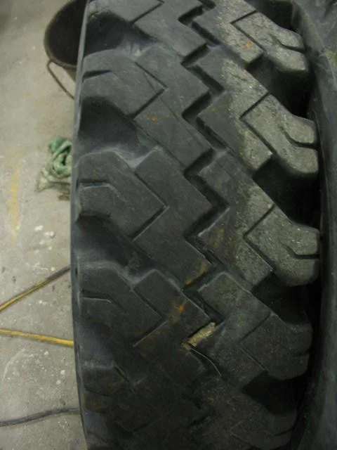

so you want some "new" tires for your 70?
with an old worn out set of ENS take offs sitting here it was time to try an idea i have been fostering for months. i wanted larger grooves in the tires, i wanted to keep the tires working for a while yet and i wanted to play.
so a call to Peter and he was nice enough to lend me his grooving machine. basicly it is like a fancy iron with different tips that make different size groves.
point one. make sure the gooving blade is in right side out, there happens to be a sharp edge and a dull side. the dull side really sucks. second make sure the contact points are clean and the groover works wonders.
as you can see the tires were getting pretty tired and traction was poor to say the least...

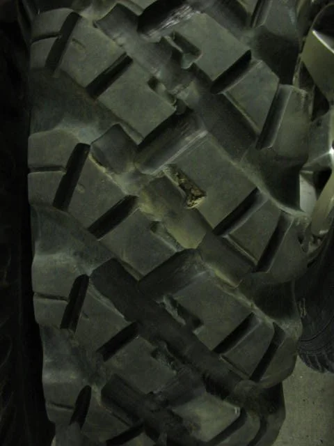

first i wanted to get some serious grooves in the middle for god old fashion forward traction...
i used the 22 mm tip for this pass...
starting to look like an off road skinny tire...
(yep, that is cow crap on there, i didn't bother with washing the tires for an experiment)

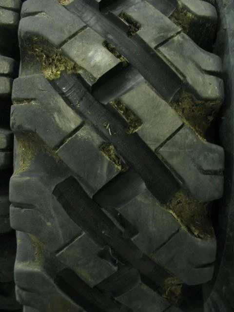

then some side traction grooves were cut into the tire, more fingers, more traction, more grip...

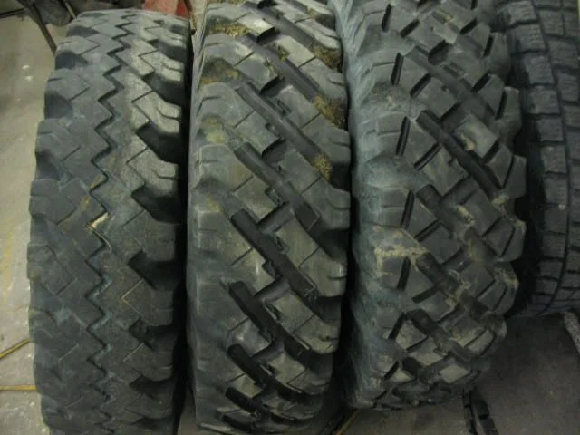

so this is the process as it was completed. the difference is night and day and should give a good year or 2 of off road use out of otherwise scrap tires.
i am looking forward to seeing them perform on the Sept Long weekend run in a couple weekends...

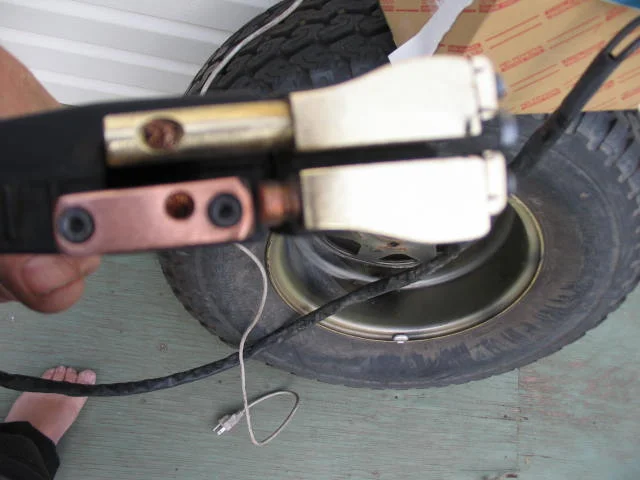

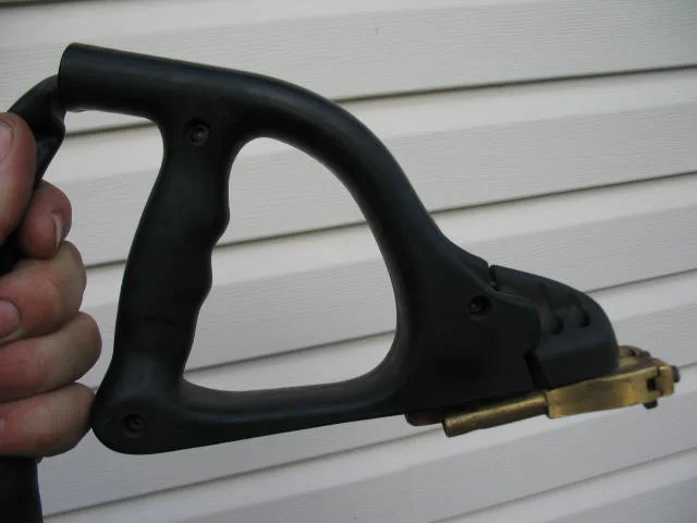

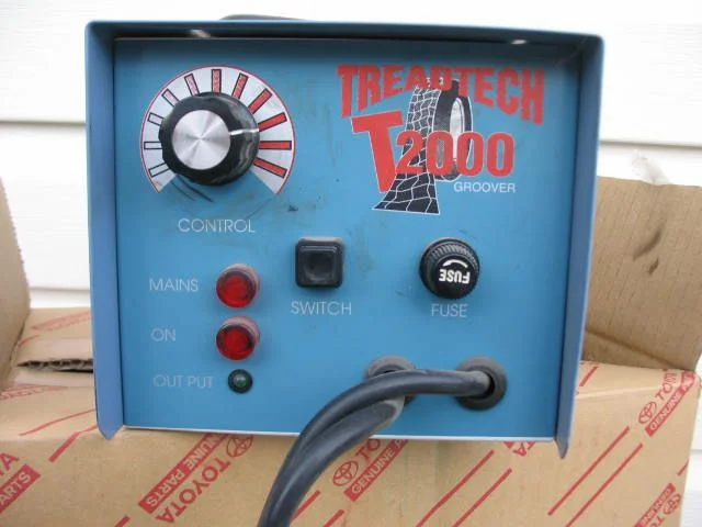

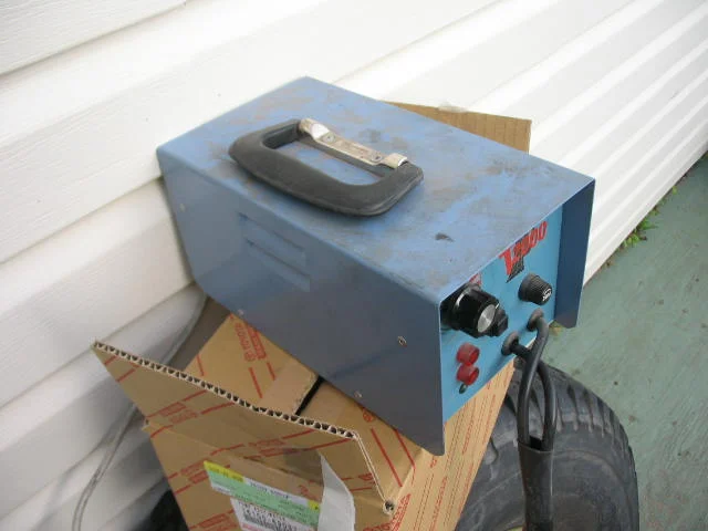

this is the actual unit i used:

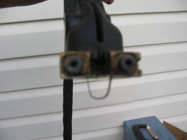

i really love the handle and the grooving tips... even after 2 hours of steady grooving the grip was comfortable to hold.
the contacts on the bottom are nice and heavy duty...

I was wondering if it was a $69 jobbie or a $300 unit. It looks to be the latter.
Thanks!
