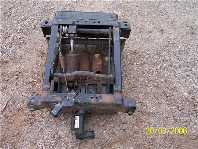

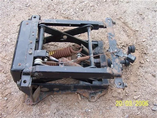

I got offered some suspension seat frames. They are supposed to be from a BJ74 but I cant work out how I would fit them.
Obviously the base of the suspension seat bolts to the floor in different holes than the seat is currently bolted to.(Hopefully they are predrilled and under the carpet)
The seats in my 73 are on a floor that is higher around the transmission hump but the suspension frame seems to need seats with a flat base.
Am I missing a part that fits between my seats and the suspension base or do I need the appropriate seats that go with a suspension base frame??
I think the seats are supposed to bolt to where the 4 finger tight bolts are
They have surface rust but are complete and seem to be ok with all the controls working.
The one in the pic is RH

the floor is actually different between the suspension seat equiped 74 and the fixed mounted seat...

So the suspension seat frame wont fit beteeen the standard mounting points.
Just seems odd they would design a different floor.
The seller says they wont go into his HZJ75 troopy but they would fit his BJ73(stolen and unrecovered) or so he thought.

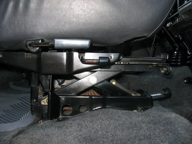

This was the setup on my old BJ70.

Thanks a lot DW .It looks as if the seat has a different base. My seat has the leg room adjustment at the front while this one is at the side.
I may be able to swap parts but I dont know where to find them They were not a common option in oz and its unlikely anyone would want to break up a matching set.

Hi,
I have taken a few photos and posted them up here;
dpunter/Seats - Photobucket - Video and Image Hosting
Not real good as it was dark, cold and wet outside. Melbourne - say no more.
Hope it helps. Let me know if you need more info.
Regards,
David
